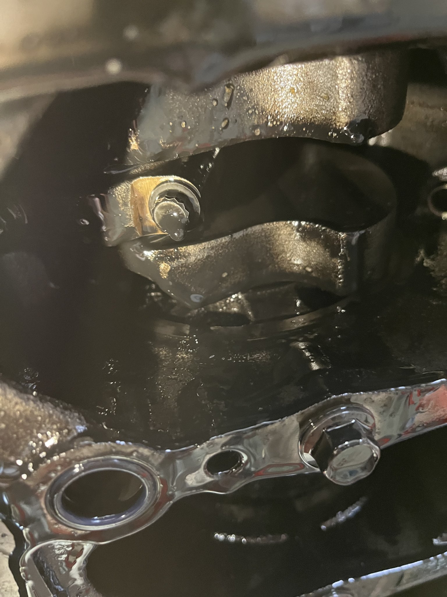

Pulled the engine today and got it on a stand. Looking at the connecting rods, there’s a different type of bolt head on them. Anyone know what these are called?
They are called ferry cap screws

Torx, and ETorx only have 6 lobes. That's probably 12 point. Just try a 12 point socket or wrench.
