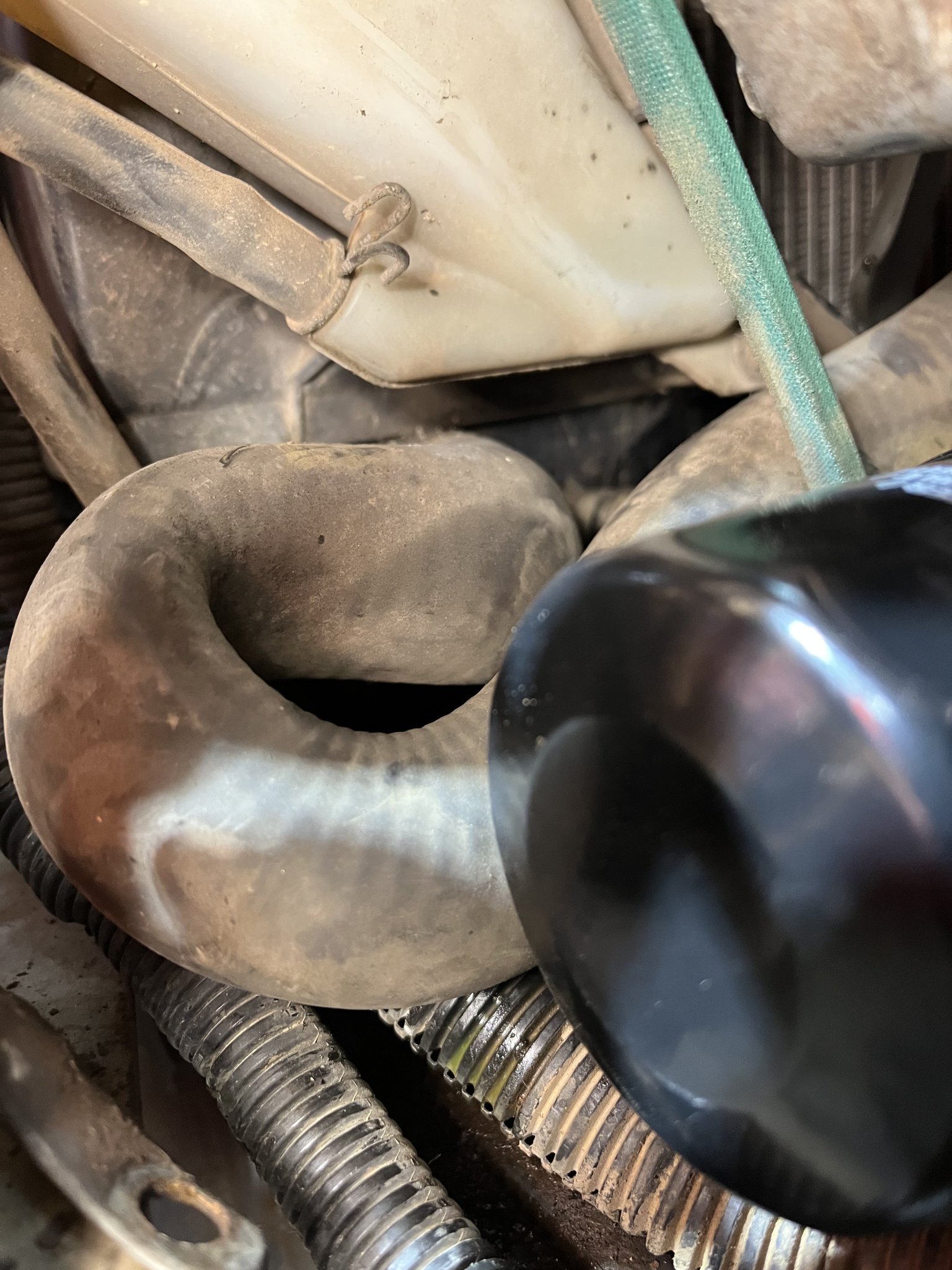

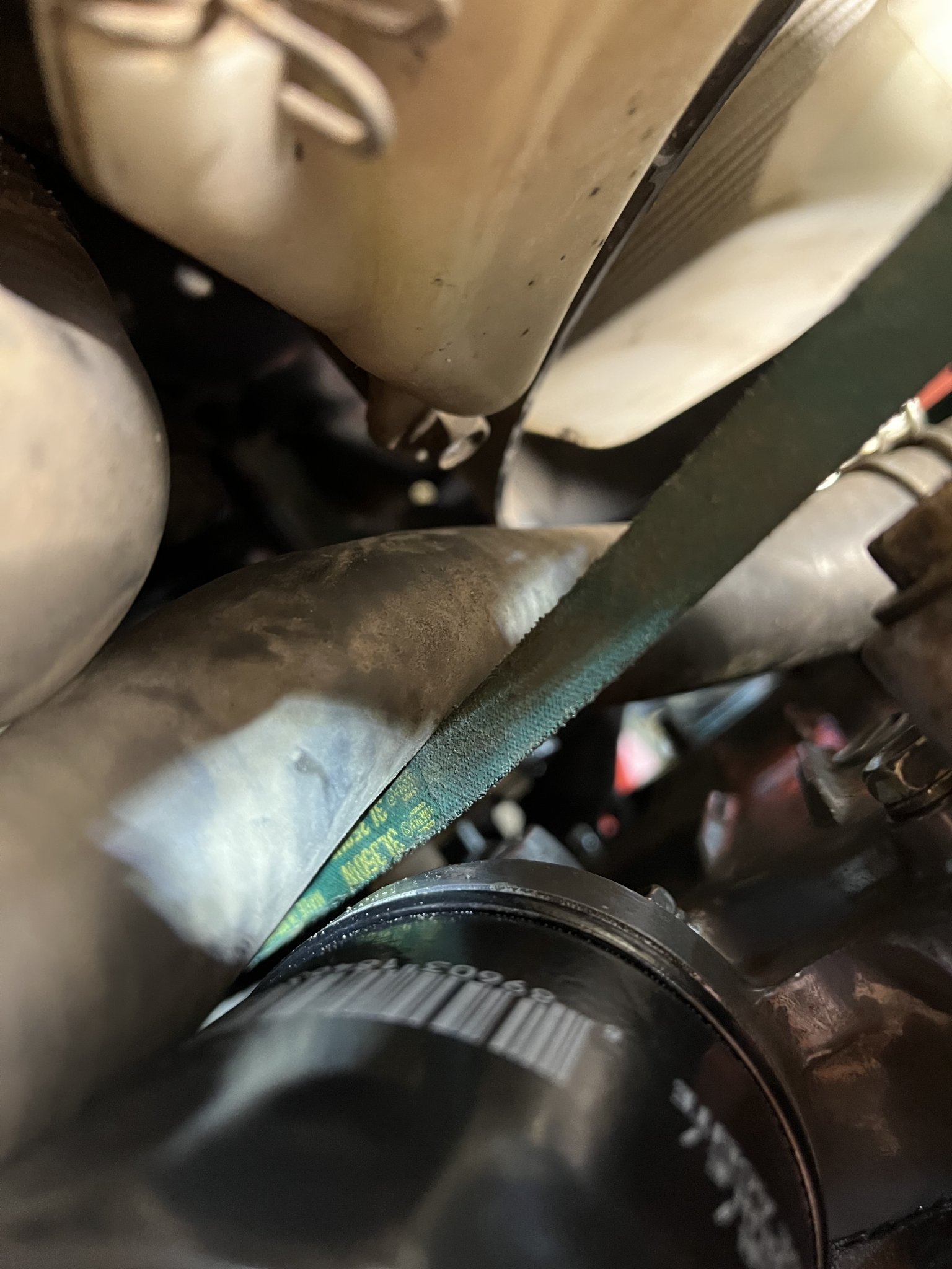

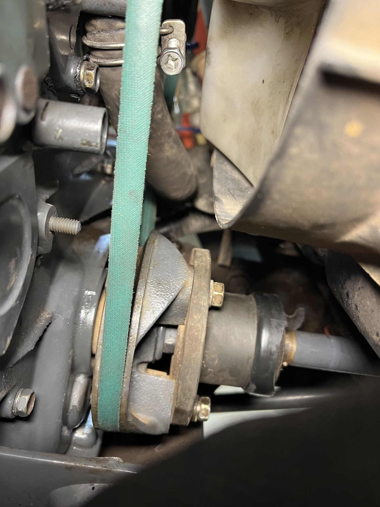

Running into an issue with the lower coolant line from the radiator to the water pump. I checked all the before pics I took and I can’t figure out the proper routing. Seems way too tight to the belt and a pretty hard kink. IMG_8645.jpeg IMG_8642.jpeg IMG_8641.jpeg
36,521
11,283
Looks like it's tight to the gear case probably behind the belt.

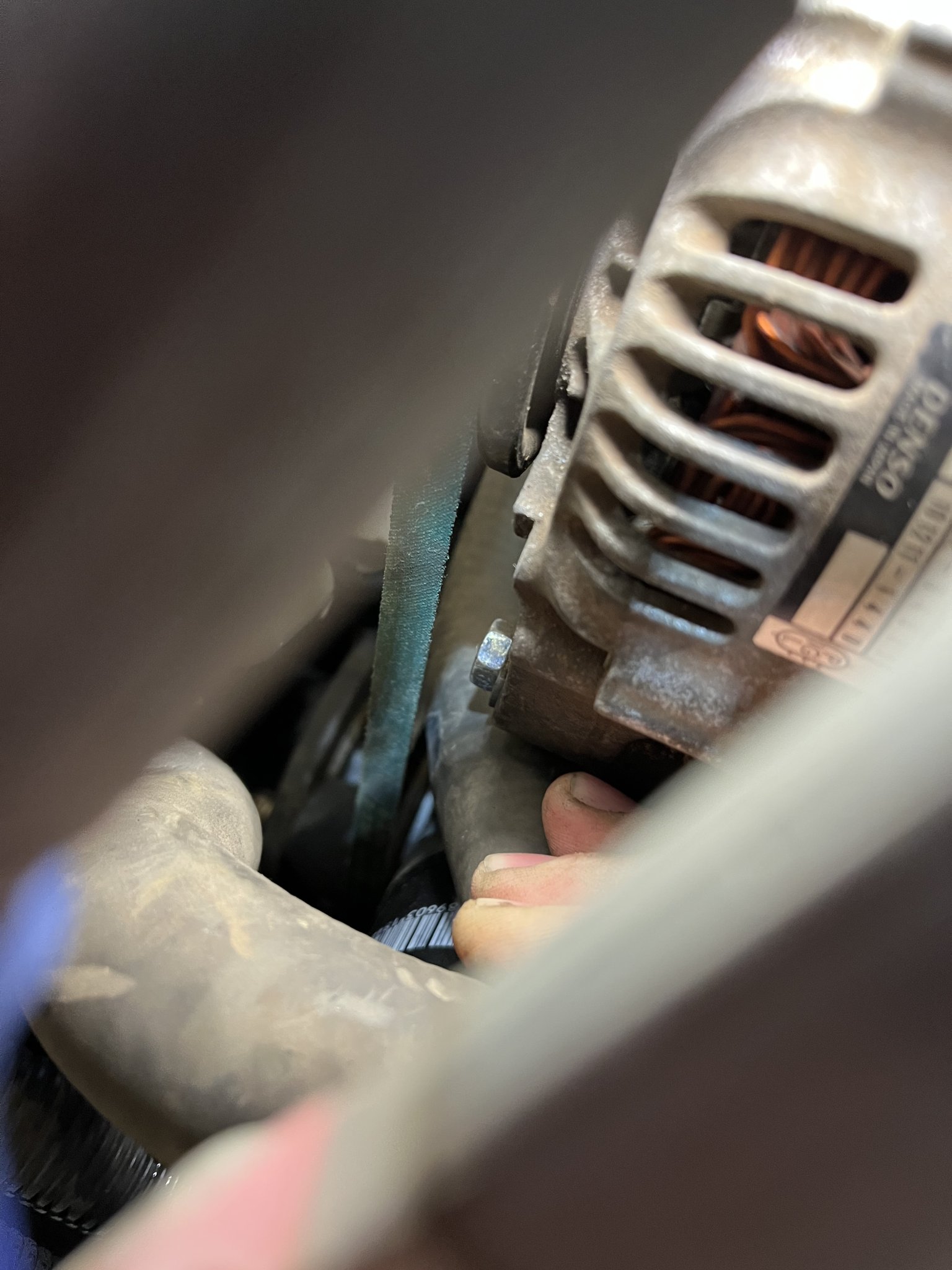

Pennsylvania
Spot on, as always Wolfman. Once I got it routed correctly I found rather significant wear on the hose. I’ll grab a new one, but want to make sure that doesnt wear the same way as the old one. Not sure if the issue was belt tension, hose routing, or a combination of both IMG_8648.jpeg
