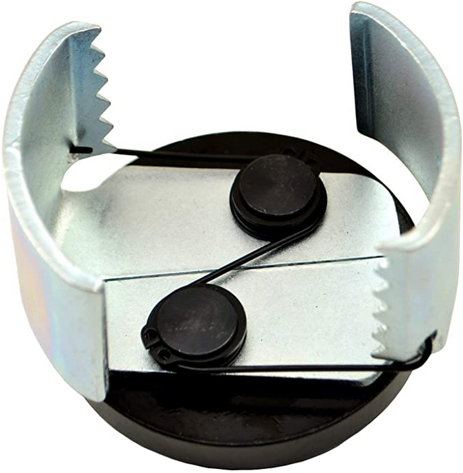

The Motivx tool is the same concept as the Lisle, except it has the circlips, as I mentioned, and the jaws have teeth. It's possible also that the socket wrench might go in a little deeper, IDK. I'm obsessing over this because I want this damn filter off, and the filter is right at the low end of the range of both of these tools. As @DustyRusty points out, I might have to use some shim stock.
View attachment 81524 View attachment 81525
This is almost identical to the old NAPA one I have that works great on the B2601 oil filter that is very snug up against the lower radiator hose. Those other filter wrenches that others are showing just won't work.
On Youtube, The Cluttered Garage, guy, he used a strap wrench that will barely fit in one area around the B2601's filter to roll it up to get it tight. This 2 finger NAPA or Motivx one is about the best. Has a 3/8" square hole for a socket wrench or extension.

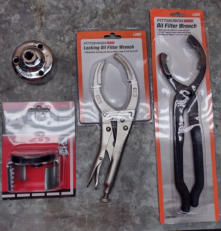

The arsenal is assembled. Not shown are the lag screws I can run through the holes in the cap wrench, or the hose clamp for tightening down the jaw cap tool. Or the sandpaper and sardine can lids for shims. If none of this works then the backup plan is to cut the end off the filter, extract the element, then "approach" the filter base with either a punch (very carefully) or a purpose-built tool to engage with the holes. With luck, I've completely overthought this. But that is my nature, and I'm ok with it.
