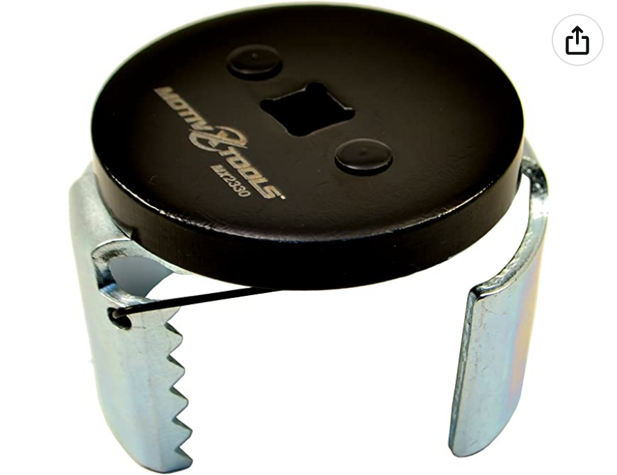

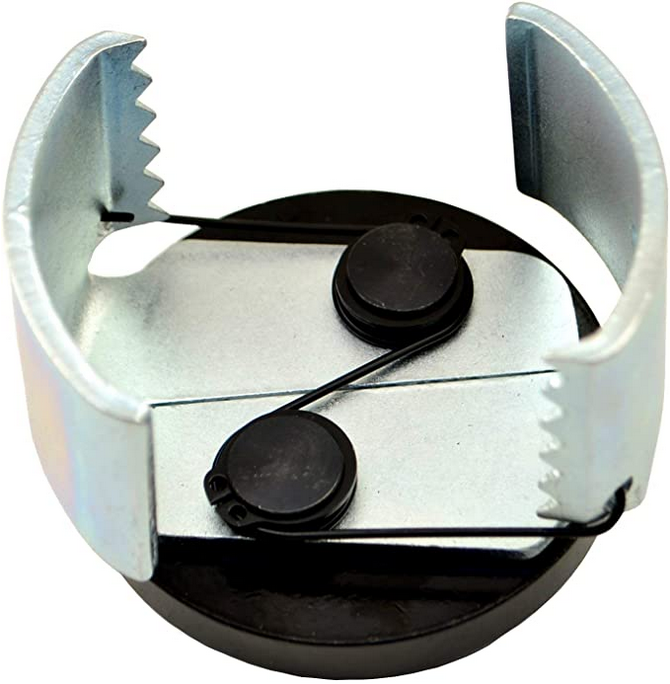

I'm thinking I might go with this Motivx version of the Lisle tool. It's more expensive, but the Lisle tool appears to use rivets for the pivot points, and the Motivx one has pins and circlips.

The Motivx tool is the same concept as the Lisle, except it has the circlips, as I mentioned, and the jaws have teeth. It's possible also that the socket wrench might go in a little deeper, IDK. I'm obsessing over this because I want this damn filter off, and the filter is right at the low end of the range of both of these tools. As @DustyRusty points out, I might have to use some shim stock.
View attachment 81524 View attachment 81525

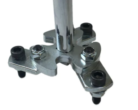

Two tools ordered ... one cap style, one ARES 56028...similar to the Lisle that @Fordtech86 recommended.
YouTube videos watched provided two backup options:
  • Option 1 is to drive screws through the cap style wrench into the filter
  • Option 2 is to use a hole saw to remove the entire end of the filter, then remove the filter element, then buy or construct a spanner that engages with the holes in the filter base
Tools for Option 2
hope it doesn't come to this, but it's good to have backup plans ...
