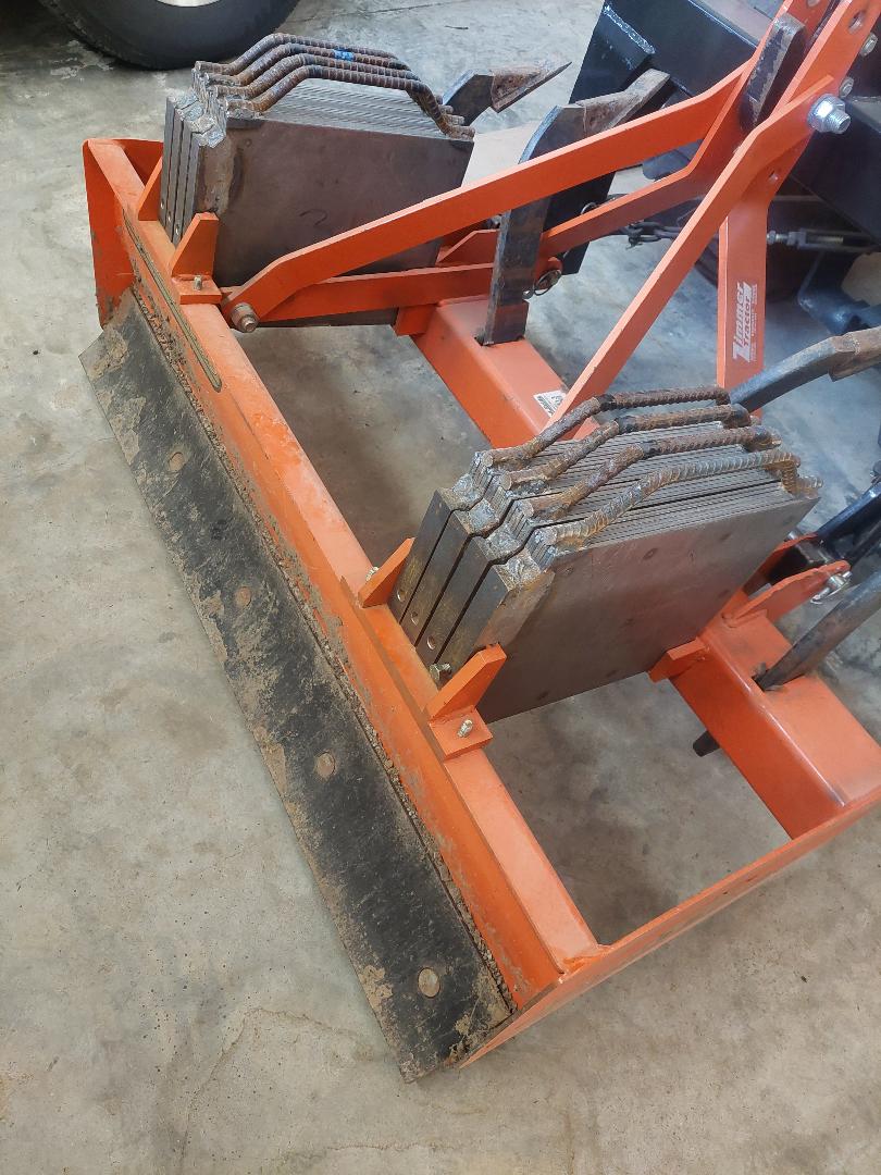

Have not purchased yet; I was considering a box blade and may go that route but not sure is it’s heavy enough, specs show it at 316 lbs.
OP I'd recommend a box blade. If you find it lacking in weight, you can always add.

What brand of boxblade is that? Did you make the weights or were they purchased?

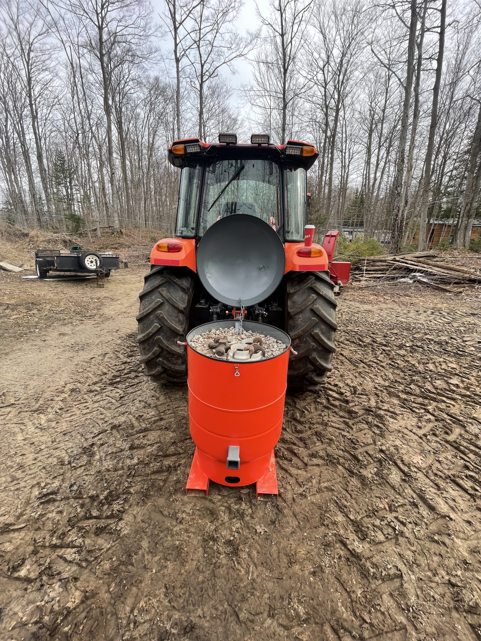

I purchased a used Armstrong Ag ballast box a while back for my L2501. The box is close to 200#s alone. I thought about concrete and gravel but how to remove if I wanted? Gravel could be dumped but then you’d have to shovel it back in when needed,
I went to local Home Depot and picked up 24-8x4x16” cinder blocks for under $50. Per site 33#s each - 792#s in 3 rows of 8 stood vertical. Plenty of room left around them for fingers if I need to remove some.
I had an old rubber mat that I cut for floor liner and lined sides just to keep them from rubbing the paint off too soon to reduce possible rust. It has drain holes but I keep it under cover so no rain water can get into it.
My box blade isn’t heavy enough for some of my needs and mower is too long and bulky to be used in some of my areas.
Landpride BB & homebrew weights, about 340# total . Someday, I'll get around to cobbling together a weight bar for the front if I ever take the loader off and need front ballast.

What a great idea. I've got a Land pride box blade on the back. I was all ready to go buy them but you said that you made them! I see the rebar you welded (out of my depth) but what did you weld them to? Looks like some type of metal plate? We have a welding place up the road who could do it for us but don't want to ask them if it's too labor intensive. Thanks!
It'll probably be cost prohibitive if you had to pay someone to fab them and the brackets up. Steel plate was free to me and I had the remainder in the scrap pile. The weights are made up from 6pcs of 3/16" plate approx 10 1/2 x 13" plug welded together. Hope this helps.
