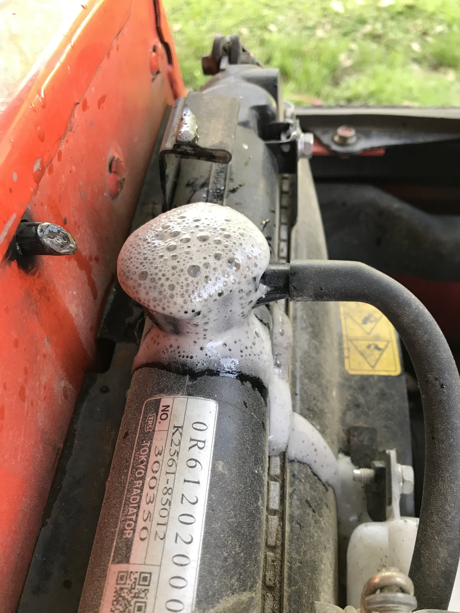

Ran the cap-off test as suggested. Immediately started getting bubbles which very quickly became foam. As the foam broke down after shutdown, it was obviously exhaust soot that was the black particulate. Evidently I have a head or head gasket problem. Hard to invest what Kubota is asking for a new head if that's the problem. Any advice for next steps?

I don't know of any way to tell if it's the head or the head gasket without pulling the head.
I don't know about your particular tractor, but generally, pulling a head really isn't a hard job for anybody who is handy with tools. A lot of the cost the dealer will quote is in the labor. A reman head is about a grand, it seems. That's just a quick search. A gasket kit will run you about another C note.
All that to say, it's not good news, but it's probably not time to scrap the tractor.
BUT STOP DRIVING IT!
If you get coolant into the oil, you will trash the bearings very quickly.

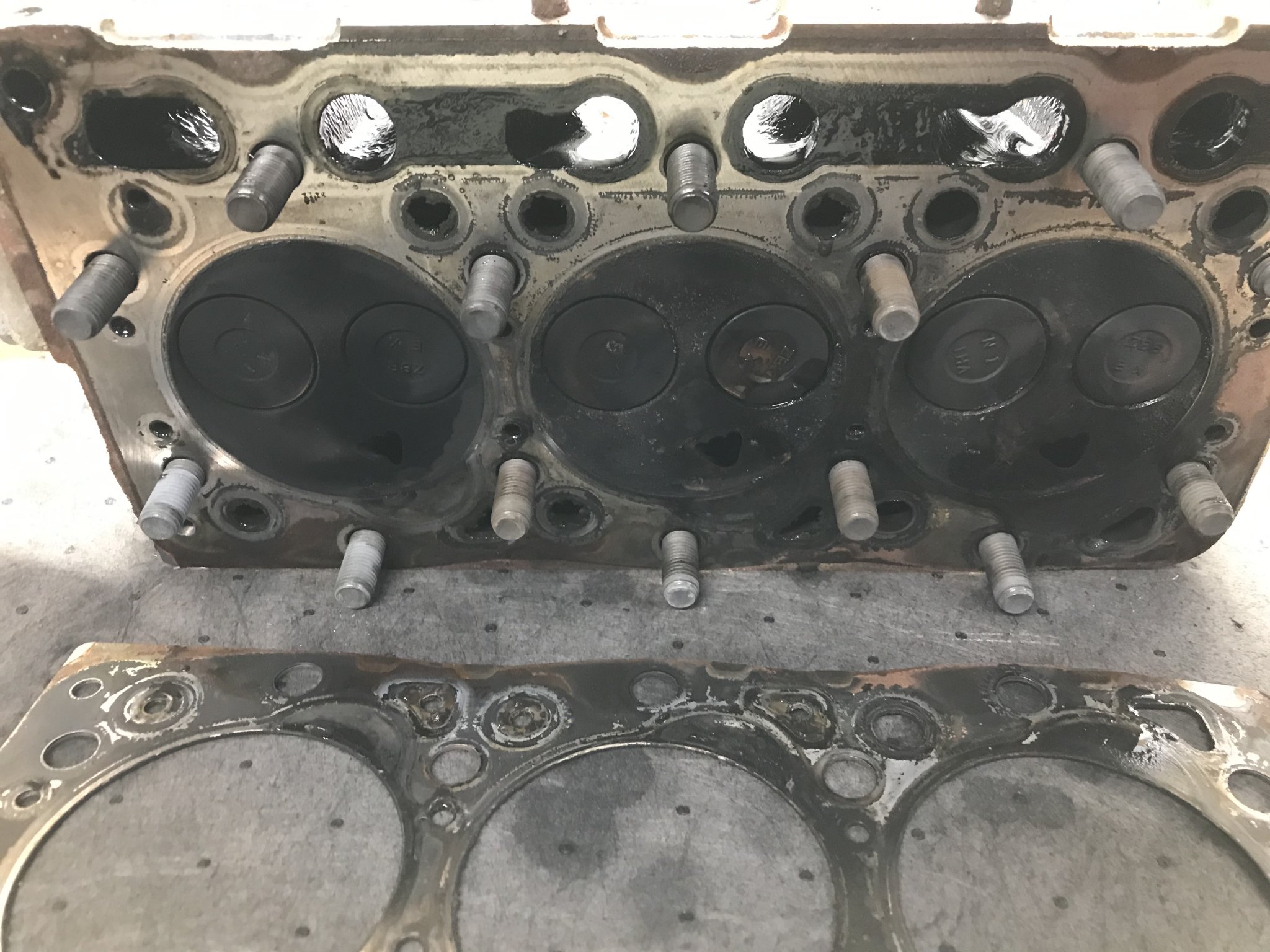

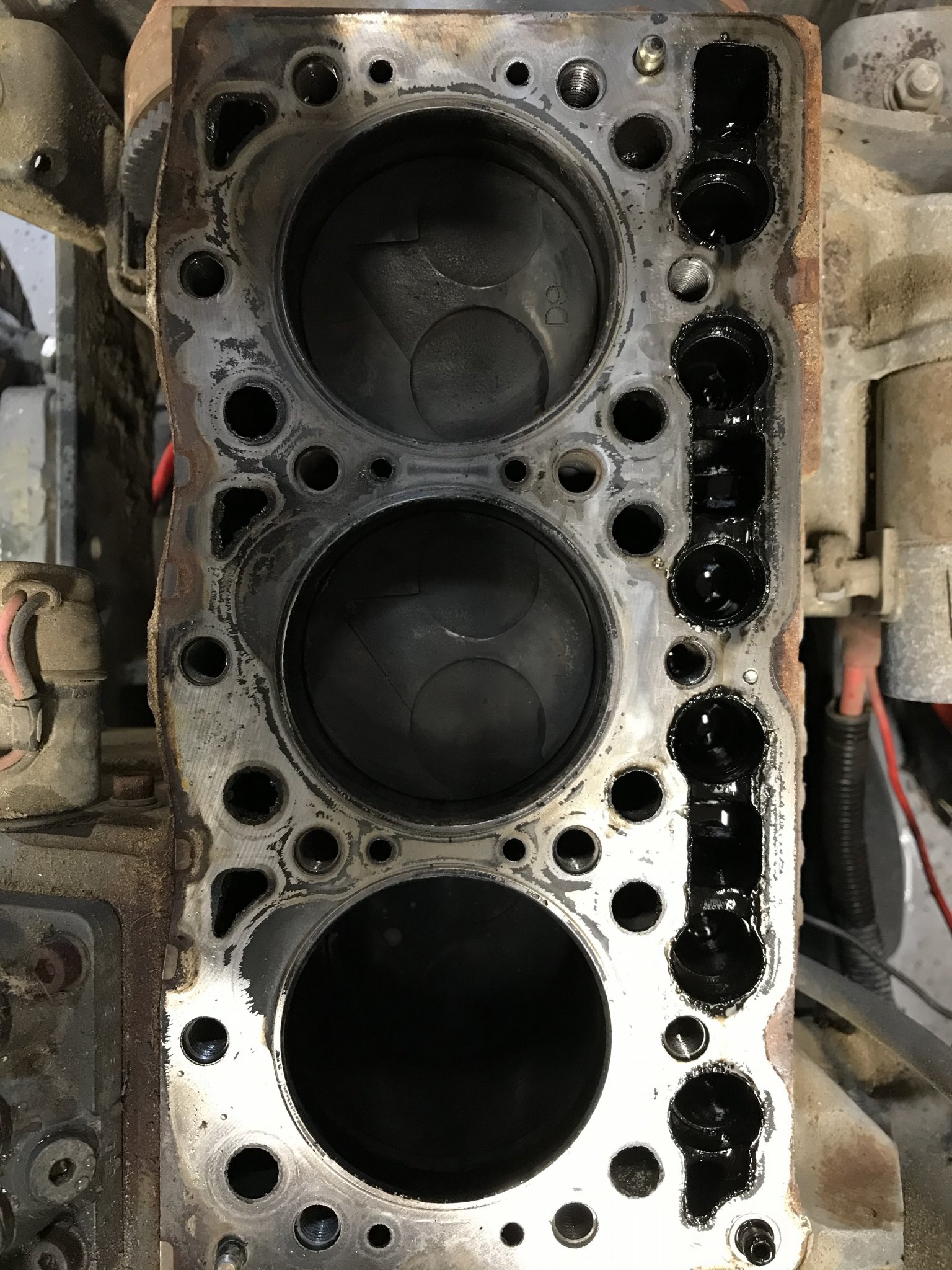

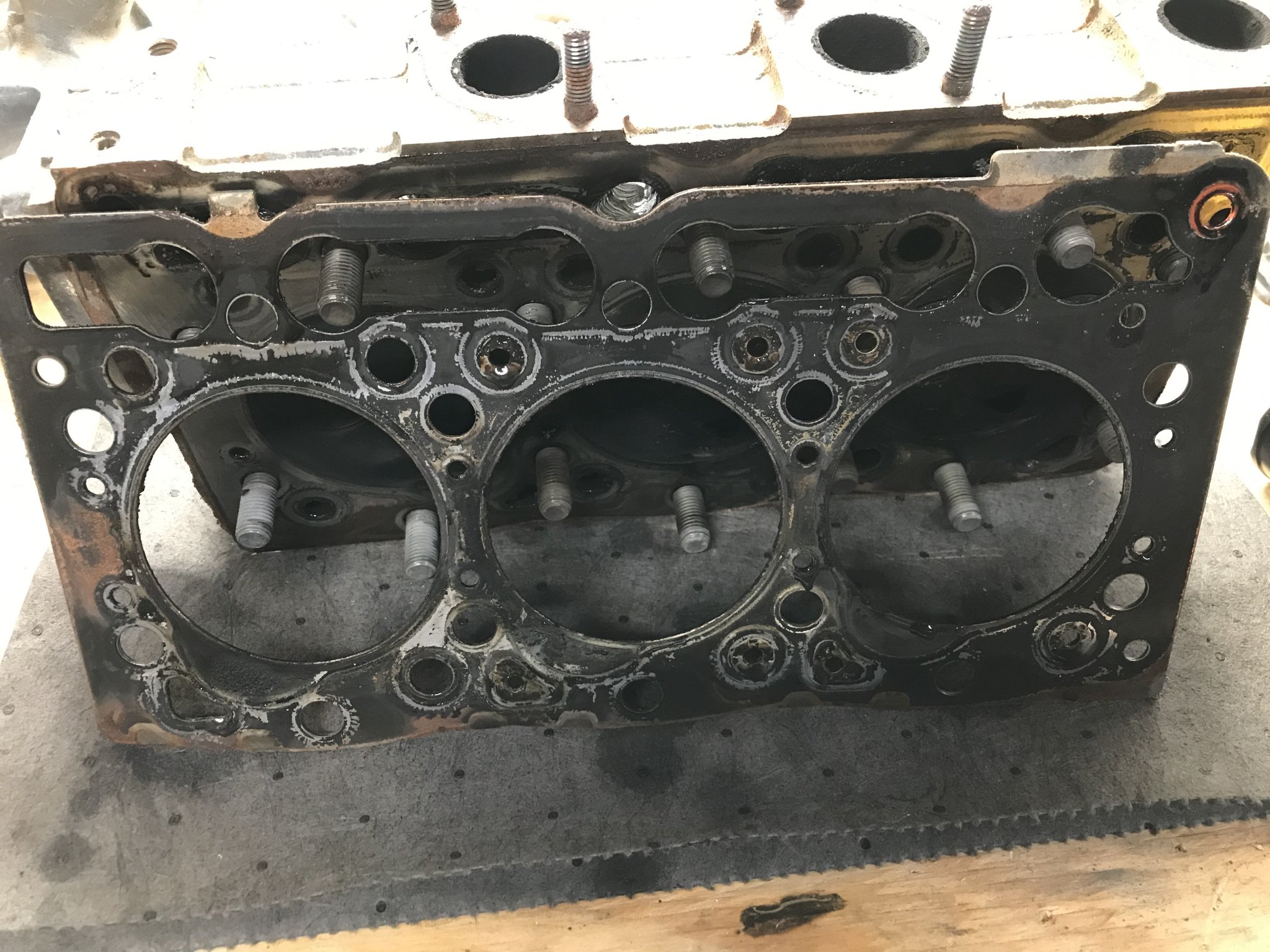

Morning all, thought I'd resurrect this zombie thread now that I've had a chance to get into the engine.
First, there was no water in the crankcase. Oil is still cleanish and of the right quantity.
Popping the valve cover, there was a waxy buildup on the top of the cover- maybe from condensed water?
After draining the coolant, I can say there was at least some glycol in the solution- it smelled strongly of anti-freeze, even though it was discolored with exhaust soot. I'm hoping this means the big Texas freeze was not the cause of the issue I'm seeing. 100% of the coolant was discolored with exhaust soot- no oily sheen on top of the drained coolant or anything, so I am convinced it is a head issue somewhere. I pulled the intake and found rust, which I suppose could have been caused by condensation while sitting, or by a coolant leak. Pulling the water temperature probe resulted in less than a cup of coolant coming out so I don't think the head was completely full of coolant, which is no surprise since it was making bubbles in the cooling system the last time I popped the radiator cap off.
Pulling the head, I could find no obviously cracks. The rear cylinder looked perfect, still had cross-hatch from honing on the cylinder walls. The front two weren't as good but still no major issues. The center piston has a rough spot that looks like maybe a corrosion spot, or possibly a burn spot from a plugged injector?
I could find no flaws in the head gasket that indicated a leak between cylinder and crankcase or cylinder and cooling system.
The head has no obvious cracks that I've been able to find even with intense lighting. The valve train was in good shape, though the center rocker arms detectable clearance between the valve stems and rocker arms whereas the front and rear did not.
Everything rotates very smoothly when turned over by hand, so I don't think there's a bottom end issue. At this point the only thing I can think is a cylinder head crack that I haven't been able to identify yet, so the next logical question is whether I find a vendor that can find the cracks, or get a new head and put it back together and see if it runs? And with the rough spot in the center piston, do I need to get into the bottom end and replace that, and if so, it looks like a complete overhaul?
