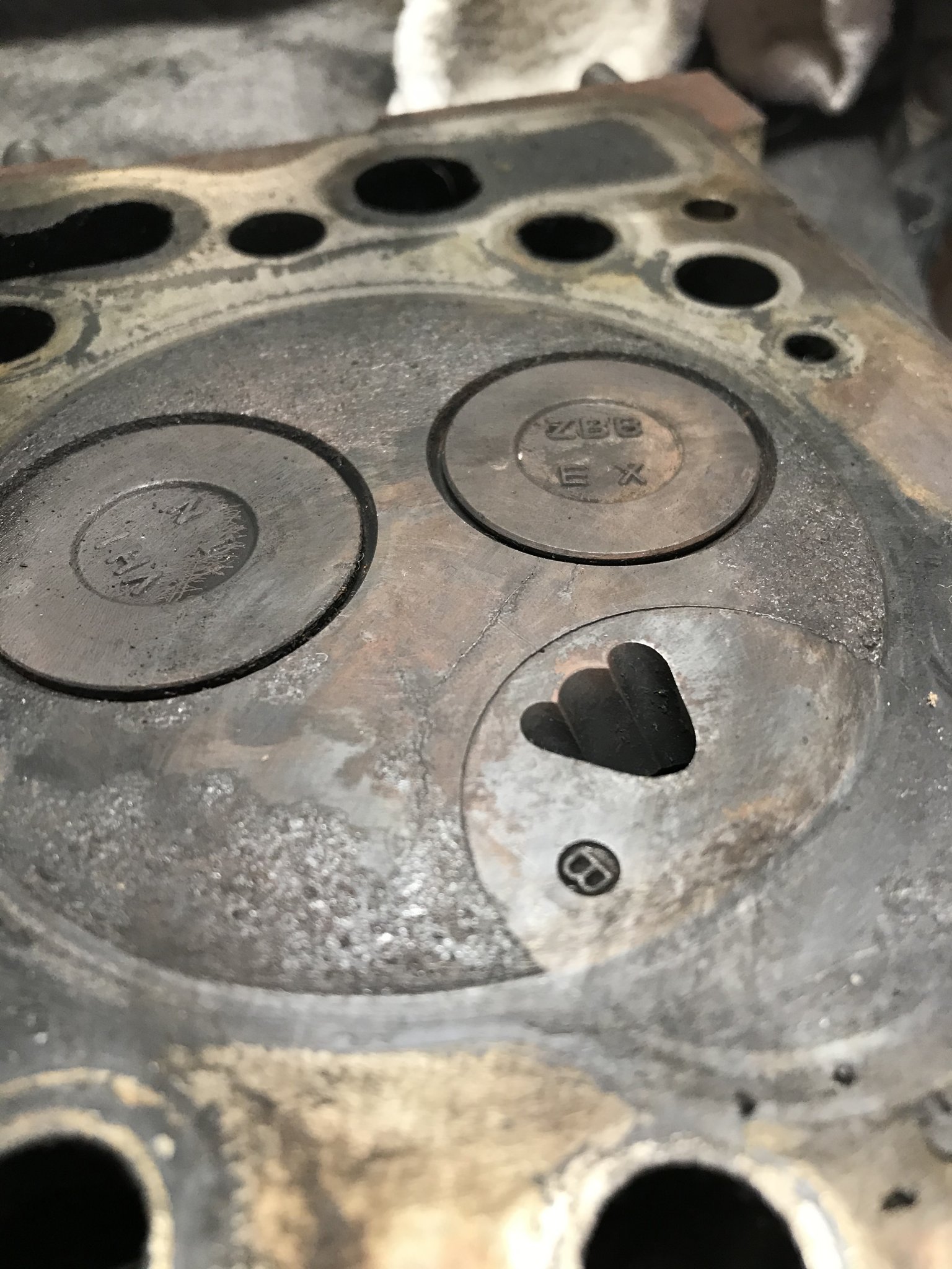

May need to remove the valves to inspect. Might be cracked in exhaust port around the valve guide.
I'm thinking that's a good possibility. There's a machine shop here in town with the required tools I'll be hauling it to tomorrow. Then to get all the gaskets and stuff on order.

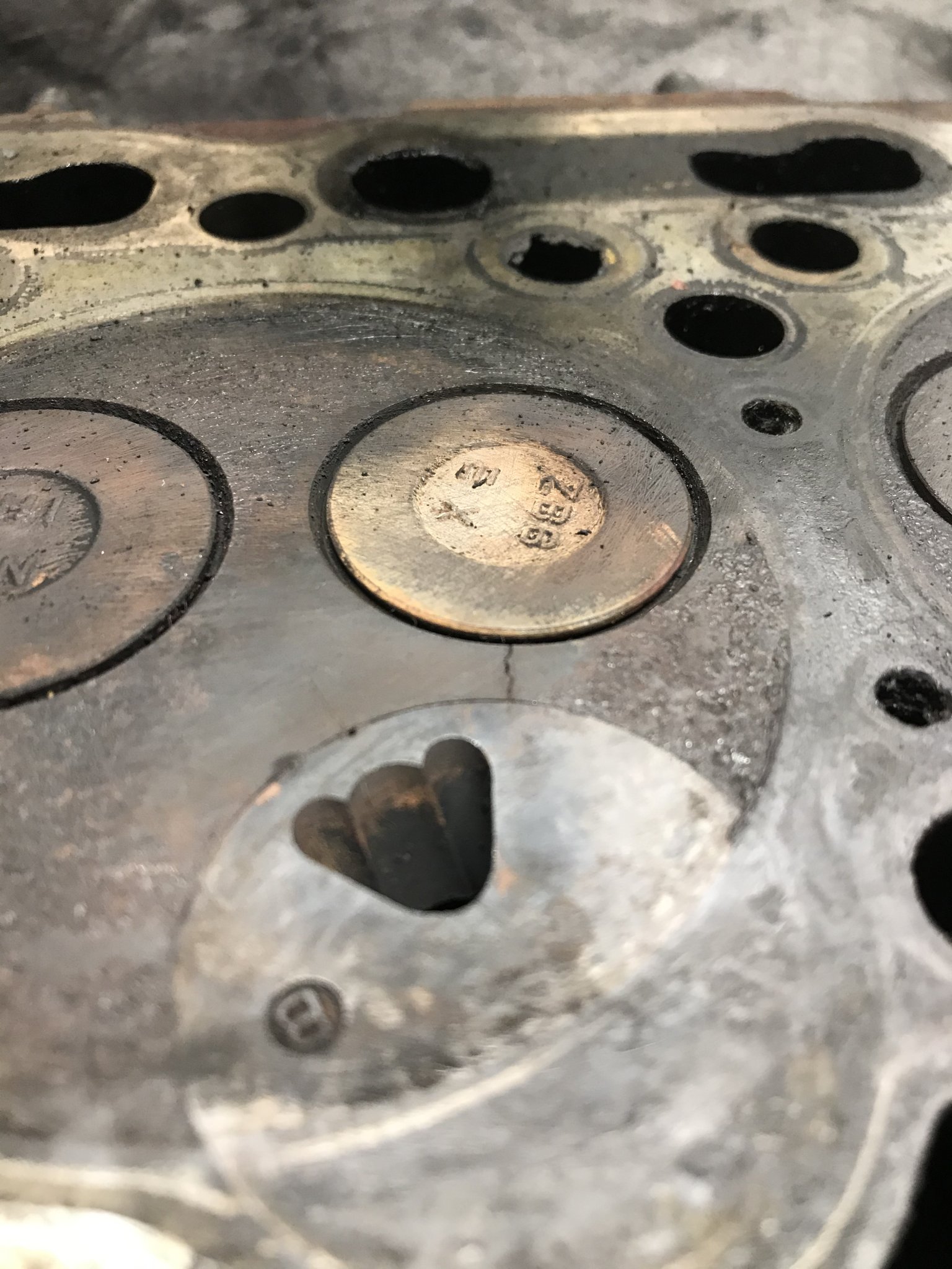

Well, problem found- several cracks. Center cylinder between exhaust valve and port for fuel injection, forward cylinder two large cracks spanning most of the way from the exhaust valve across the diameter of the cylinder, and rear cylinder no visible cracks. Evidently got hot at some point and certainly explains all the gross stuff in the cooling system. Next question- where best to get a new one? Messicks has it, for about 1/3 what I paid for the whole tractor :oops:. I've never seen anything good about aftermarket heads but getting this thing running again is getting to be painful. I can typically get parts a little cheaper at my local Kubota but still going to be a grand to get this little guy running again!
