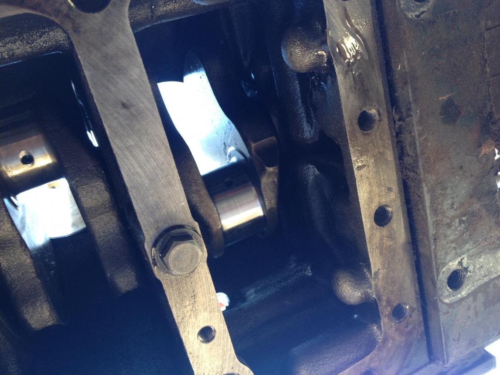

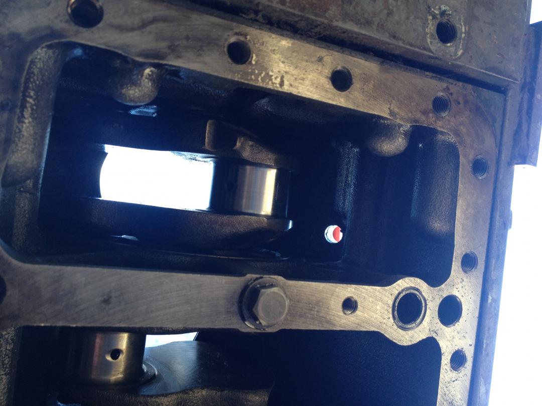

Wolfe, I appreciate the feedback that you post to help members if this forum, including me. However, while I am asking a lot of this tractor, I do not think that I am in anyway pushing it beyond it limits. You have not seen the area in question and therefore cannot place an accurate judgement on just how thick of brush this is. We do not run over trees lager than about 2in in diameter and we try to avoid those. Most of them end up pushing over then it gets chopped while laying flat on the ground.
The great majority of the grown is wild bushes and vines. We are taking very good care of the tractor and other than this unfortunate incident with the oil plug, nothing else of significance has happened to it other than normal wear and tear. (Knocking a light off the fender does not count in my book and will be fixed once we are done with this clearing.)
Point being, there is more than one way to fix my issue at hand. Aluminum has a significantly lower melting point than steel and therefore the melted aluminum is all that I expect to find wrong with the crank journal. Once I get the aluminum off and polish I will take multiple measurements of that journal and the other two corresponding journal to see if there is any significant difference to be concerned about. Since the bearings was still in the journal, no steel to steel contact was make between the crank and the rod, therefore the crank nor the rod should be out of round. I am still debating on reusing that rod and will be taking measurements of it tonight to make a final determination.
The process I described above for cleaning and salvaging a crank shaft has been used for many decades in everything from V-8 trucks to racing motorcycles, drag cars and semi diesels. It all comes down to tolerance. If the tolerance is correctly within spec (weather done this way or at a machine shop) then it is within spec and will perform just fine.
I think you assume I am trying to cut corners and will grenade my engine by doing so. While I am trying to save dollars I am also trying to save time by not having to rely on others. If I can make this repair within spec on my own, then I will have this tractor back to work before any other shop can do it for me while dealing with other workloads and waiting on parts.
Again, if it does not meet spec and needs additional work at a machine shop, then it will go the the machine shop. Either way, it will be done right and within spec. Question here is who decides what is right? Old timers that have performed backyard fixes for decades or the professional that does this everyday with near endless resources. I say it does not matter if it works and stands the test of time and that is all about the specs.

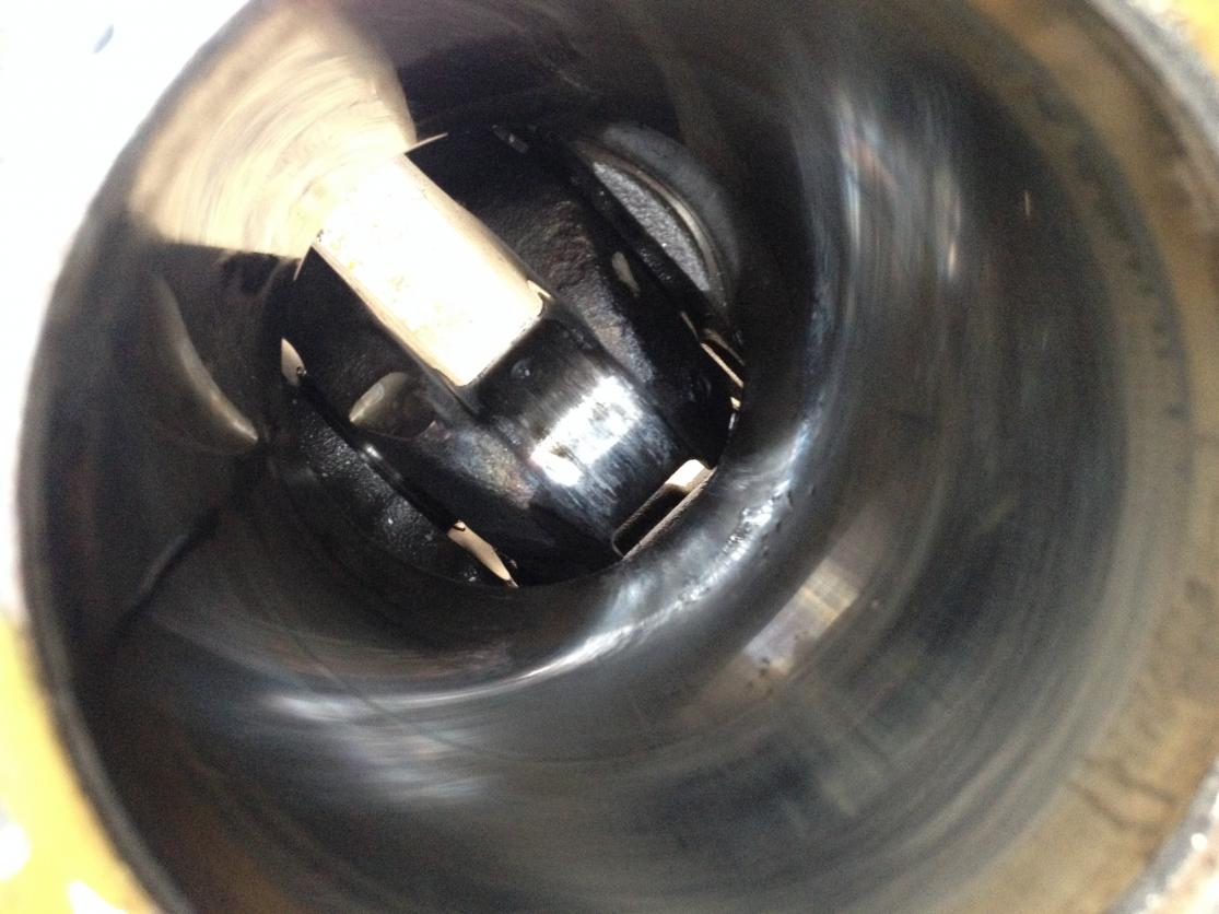

Spent the day out with the tractor and I am feeling really good. Started with soaking the crank journal in Muratic Acid. Let it sit about 3 hours with a acid soaked rag wrapped around the journal. Once I pulled that off and neutralized the acid I spend the next couple hours polishing it. Three different grits of Emerey cloth then 600 & 800 grit wet sand paper. After I got it polished, I measured the journal with my new micrometer. I took several measurements around each journal due to the micrometer maybe not being set square or center and around the journal to be sure they all were still in true round. On average, they all specked out within .0004" of each other and the one in question is still true round. Pictures below of the before and after.
We cleaned up the pistons and I re-ringed them. Cleaned up the inside of the crank case and applied assembly lube on the crank journals and got the pistons back in the block. Tomorrow we will get them torqued down get the head back on and button the engine back up. Things are looking good.

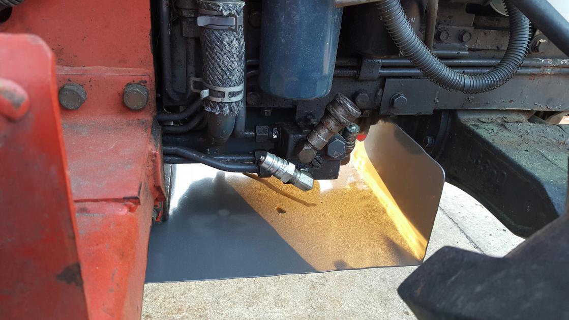

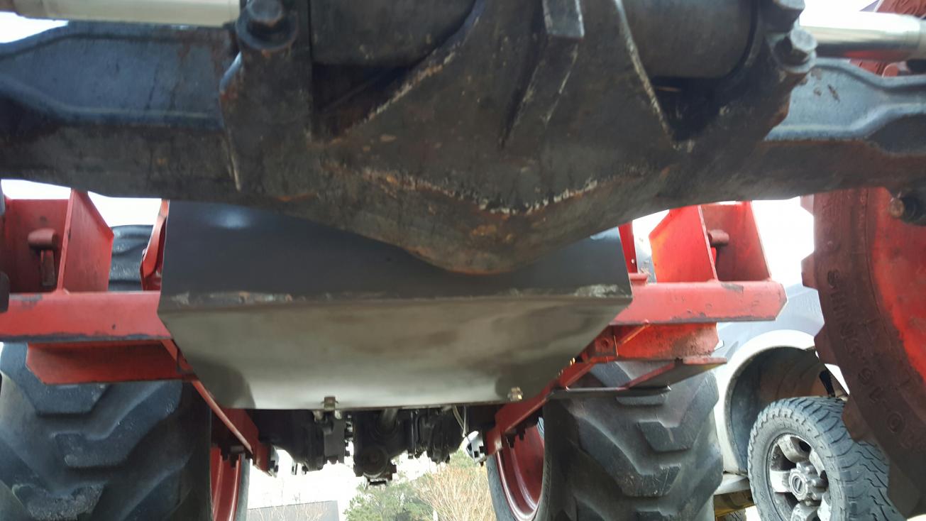

I don't think I will have a problem with Brush knocking an oil plug loose again. Made this skid plate out of 14ga steel. The front is supported with the two rear (of the total 4) bolts that hold the axle swivel bracket to the frame. The rear is supported with 3/8 bolts in the loader sub frame cross member.
BTW, yes I see the small hydraulic leak. It is coming from the fittings there on the block. I will be fixing that soon. Probably just needs some thread sealer.

knightgang, great to hear you're back running and things are looking promising. Hope that everything continues for you! For the "light" torque rod bolts and such, I use blue locktite on anything that seems like a "low" torque. Blue is easily removed with some pressure but will help you "hold" that torque and not worry about things loosening up. Just an idea for the future.
For the pan, if you're as aggressive as you say about driving thru brush, rocks, etc...then that pan won't hold up for long...but at least you will see when it gets hit. You might want to remove that before it gets too bent and bring it to a fabrication shop and make it out of 1/4 or 3/8" steel plate with some side wings as well.
It is much stronger than it looks. Mostly the pine sapplings and small sweet gum growth is what gave me the problem, no rocks.
I made this plate out of what I had laying around. If it looks like it needs to be heavier, I will pull it and use it as a template to make another out of thicker material.
Just screw a piece of Sacrificial plywood to that plate. Replace once a year.
