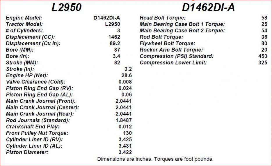

No, there is no engine that will replace it that is the same HP, you can get close 29hp with a D1402-DI-AE
There really shouldn't be any need to replace it, just rebuild the one you have, it will probably be cheaper as D1402-DI-AE or other D1402 variations are expensive 3.5K range.
Also if you do go looking at other engines, need to be real picky, details matter, as they made several versions of the D1402 one huge difference is a DI (Direct Injection) to IDI (Indirect Injection), and there were other older D1402's that were lower HP and not set up the same.
The Letters mean a lot in the make up of the motor, Like you said "V1462", it's not a V engine (that's a 4 cylinder) it a D engine (3 cylider) and yes they do make some variations like a V1402 not the motor you want.
the letters after the numbers are important too, they are variations into the build of the engine internally and externally, a D1402-A will not work where you need a D1402-DI-AE.
