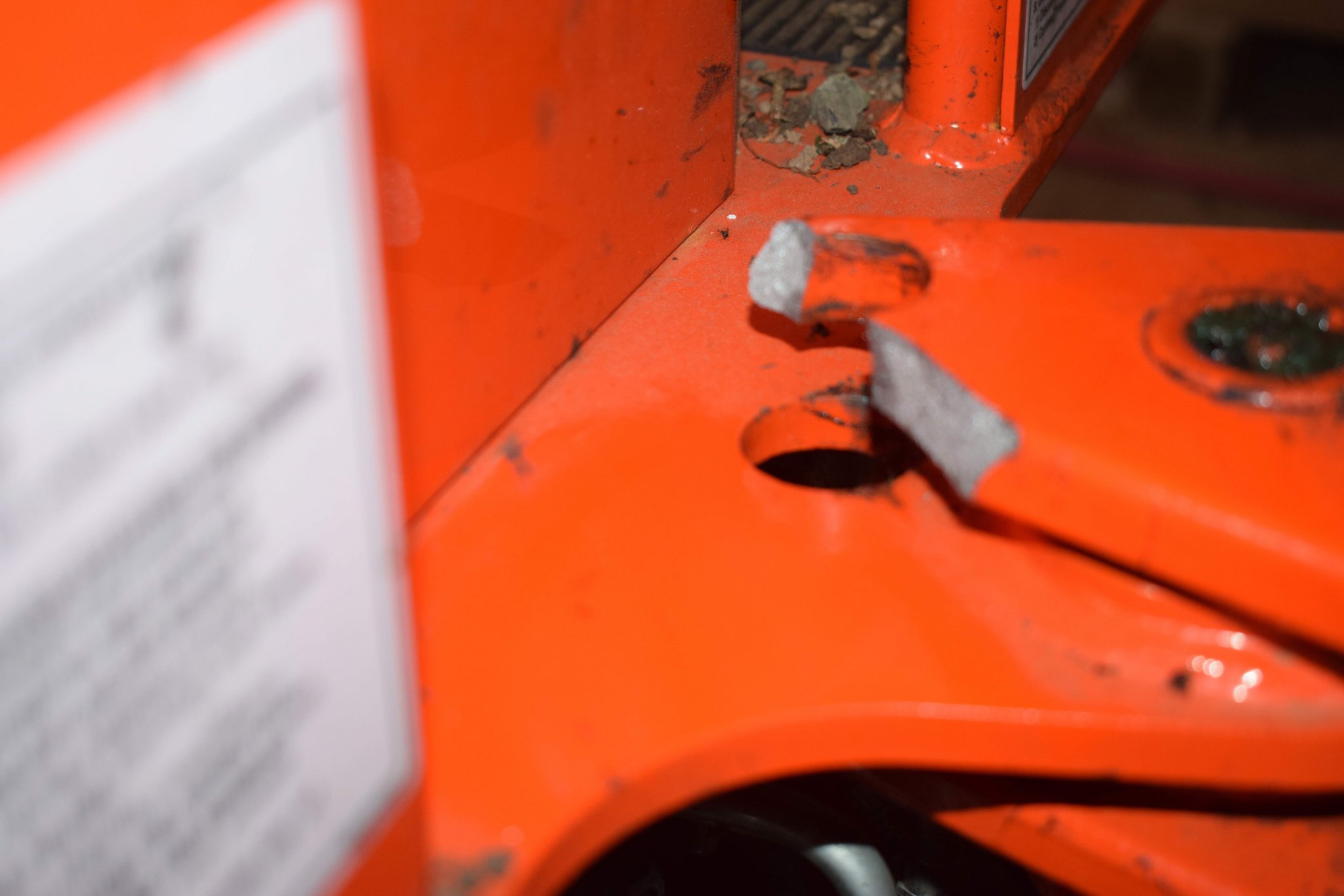

Almost 50 hours on the tractor and I managed to break the casting that holds the pin for the swivel. I must not have had the pin in all the way. :mad: the backhoe is also leaking from the bank of fittings and valves under the platform. I am going to do the 50 hour service in the next couple of days and will tighten everything. if that does not work I will call the dealer. Bummer .. I did tackle three ash stumps and a spruce stump this afternoon ash stumps are not spruce stumps the hole was so deep I heard Chinese music by the time I got the stumps out.

I am going to contact the dealer i will post some pics the more I think about it the pin was stuck as it often has been and I moved the lever to swivel the backhoe and the casting broke I kept working after the incident and had some trouble finding the broken part. But I found it yesterday and it has a lot of porosity in the casting.

I had not even started to use the BH. I was trying to get the transport pin out of the swing and the casting broke. I continued to use the BH and it is not a fatal break I can still use the backhoe. I have contacted the dealer and will see what happens overall I could not be happier with the tractor or the BH

ahhh, i see where it broke now. That is a really weak point. I'm guessing that you used the swing with the swing lock engaged?
I rarely use the swing lock (only while trailering) for fear of breaking it. I don't try to capture the locking pin by swinging the boom, rather just leave the pin sitting loosely in the hole.
