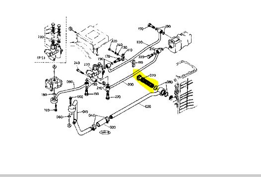

I have not tested the PTO. I honestly don’t understand the test procedure. My position control lever is locked in the top position due to the previous owner’s installation of the BH(not professionally done..)
I’ll happily take any advice on tracking down “air leaks”. I’ve recently repaired a several leak on the hydraulic line going to the pump but changed the fluid with crap hydraulic fluid from TSC. It’s still milky and I have not put the tractor in the rain or kept it outside.

The suction side leak is noted by a soaked hose or fitting on the suction side of the pump, same pipe as the screen filter.
