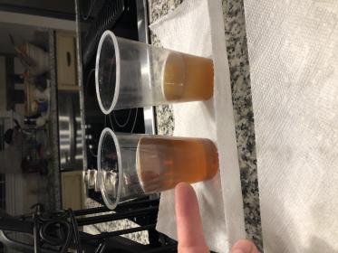

This is a photo of the hydraulic fluid after the second flush and filter. I ran the tractor for a couple hours today and pulled some logs. It’s moves better but still struggles up hills even in low. I was able to climb a small grade tonight without any load.
I’m going to keep flushing until the fluid is clear before going any further.

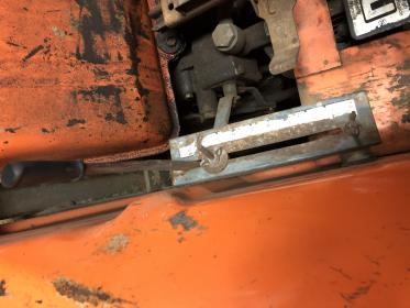

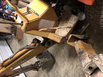

More photos. Looks like I’ve lucked out and have the lower serial number tractor (THANK GOD!!). You can see my PTO driven BH and the position control is jacked up and locked. Again, I’ll “try” to flush the fluid and see if a miracle occurs. Thanks

Are the three point arms attached to any part of the BH?
If they are attached then it's not a subframe mounted BH.
If they are not attached, loosen the wing nut on the stop thats holding the lever from moving, and move the lever towards the front, this will change the hydraulic system if it's going into bypass.
Then try running the tractor again, I didn't know you hadn't addressed the three point control issue, until 85Hokie brought it to my attention.

Update #17
Great news! After another flush (that’s three if you’re counting...) and can of seafoam, the fluid isn’t milky anymore.
The tractor seems to run better and is quieter.

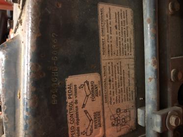

You can get the gauge and parts to hook it up on Ebay or amazon for about $15.
First go to the hydraulic block and take a picture of it, I'm wondering if the valve is in the wrong position?

I’m doing the deep dive into the hydraulics. I turned the directional nut all the way clockwise and the FLE completely stopped operating. I backed off the nut little and it worked again. I think the FLE hand control is Plummer wrong. A diagram or schematic would be really helpful.

The abbreviation is FEL (Front End Loader).
The part about turning the control on the diverter valve cutting off the FEL sounds normal.
Post some pictures of the plumbing if you unsure of routing.

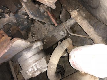

Did you replace the HST filter when you did the No.3/last oil change, or are you still running No.2 filter?
The water/sludge in my machine was bad enough to restrict and break the filter when I got it.
