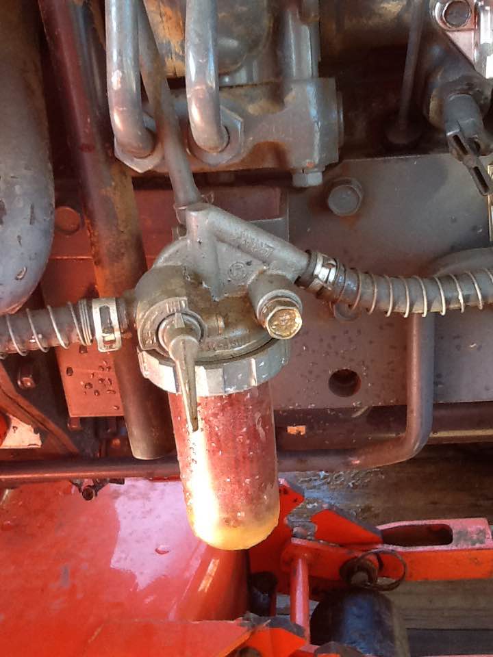

Here is a photo of the glass fuel filter bowl from my B7300. Any opinions as to the "stuff" at the bottom of the bowl . . . is this normal? If it is not normal, can you tell me what I have, and what needs to be done? Much thanks!

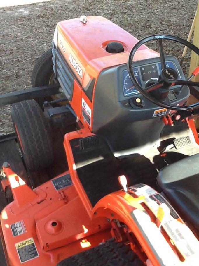

Just to put a "face" on it, here's a photo of my new B7300. Haven't had a chance to clean her up yet 'cause I can get her off the trailer until I can get her started!

Judging by the crud in the bottom of your fuel bowl I think it would be wise to drain it out And hit it with some fresh fuel. Bleed it as long as it takes. Try again.

That screw next to the fuel shut off on the filter looks like it is the air bleeder for when you replace the filter. Back it out and fuel should come out when the petcock is open, tighten it up as the fuel is coming out with no air.Now you will know which way the petcock is open.
From that picture....that fuel looks like .....well, BAD! hard to tell, but I would do what others said. Get cha a good battery, and get rid of the old fuel, and replace - bleed the air out if any, and hit the glows for a 10 second time and see what happens.
