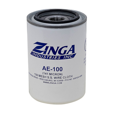

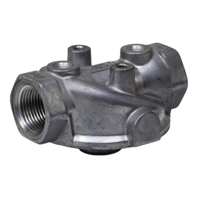

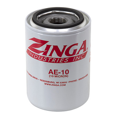

Is it better to tap into the existing hydraulics to feed the new steering pump, or better to use a separate reservoir and filter ?
If I keep the systems separate, is a spin on style filter (see below) in the return line to the reservoir a good choice, or is there something better ?
If I buy or make a separate reservoir, is bigger better ? My thinking is that a greater volume of oil and larger reservoir surface area will help with cooling.
Many thanks.
13,195
7,445
I have some more questions....
Many thanks.
You have 4 gallons in the sump and a 4 GPM pump on the tractor. Significant head room there. What size PS pump are you contemplating? i would think pretty smsll.
A suction side screen and return side filter would be optimal and an improvenent over OEM.

Thanks Dan.
When I get to the shed today I'll see if I can work out where to tap in for supply and return lines.
The pump I've bought is 4.9 ml/rev. So 12.2 l/min, 3.2 GPM at 2500 rpm. That gives me 1.9 GPM at 1500 rpm - the tractor isn't much use below that.
Are you saying that the filter I've pictured above would be suitable for the return side ?
Suction side screen - is that something that would be fitted into the suction line to the new pump ?
