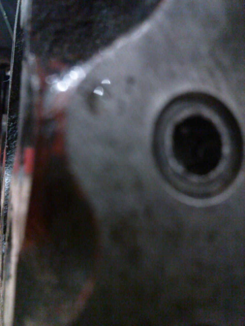

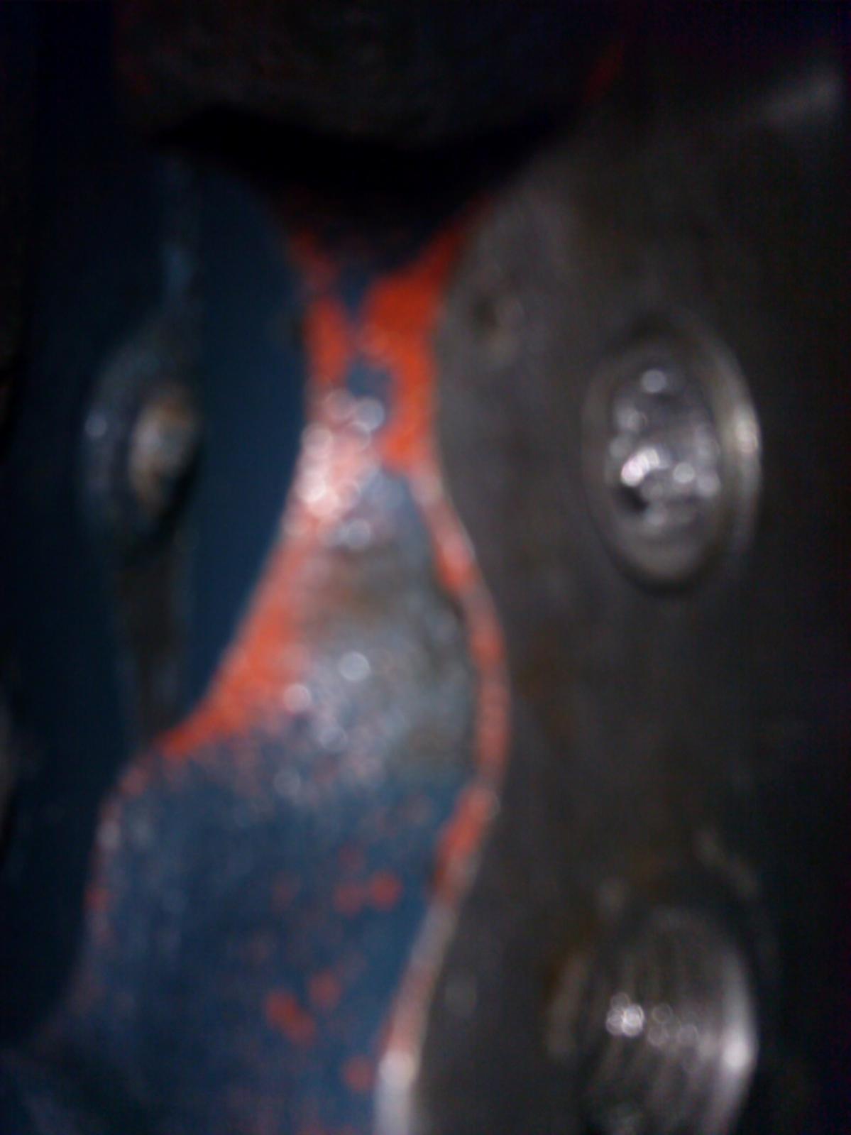

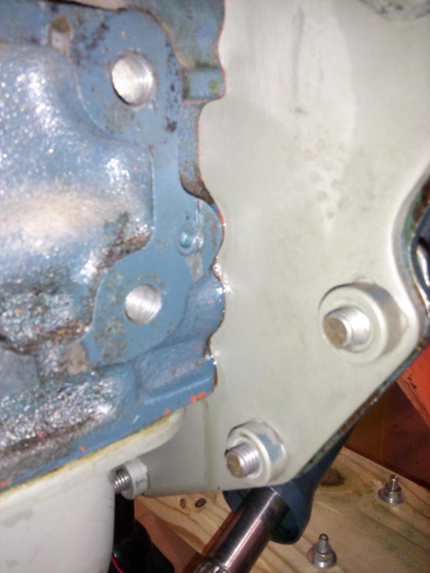

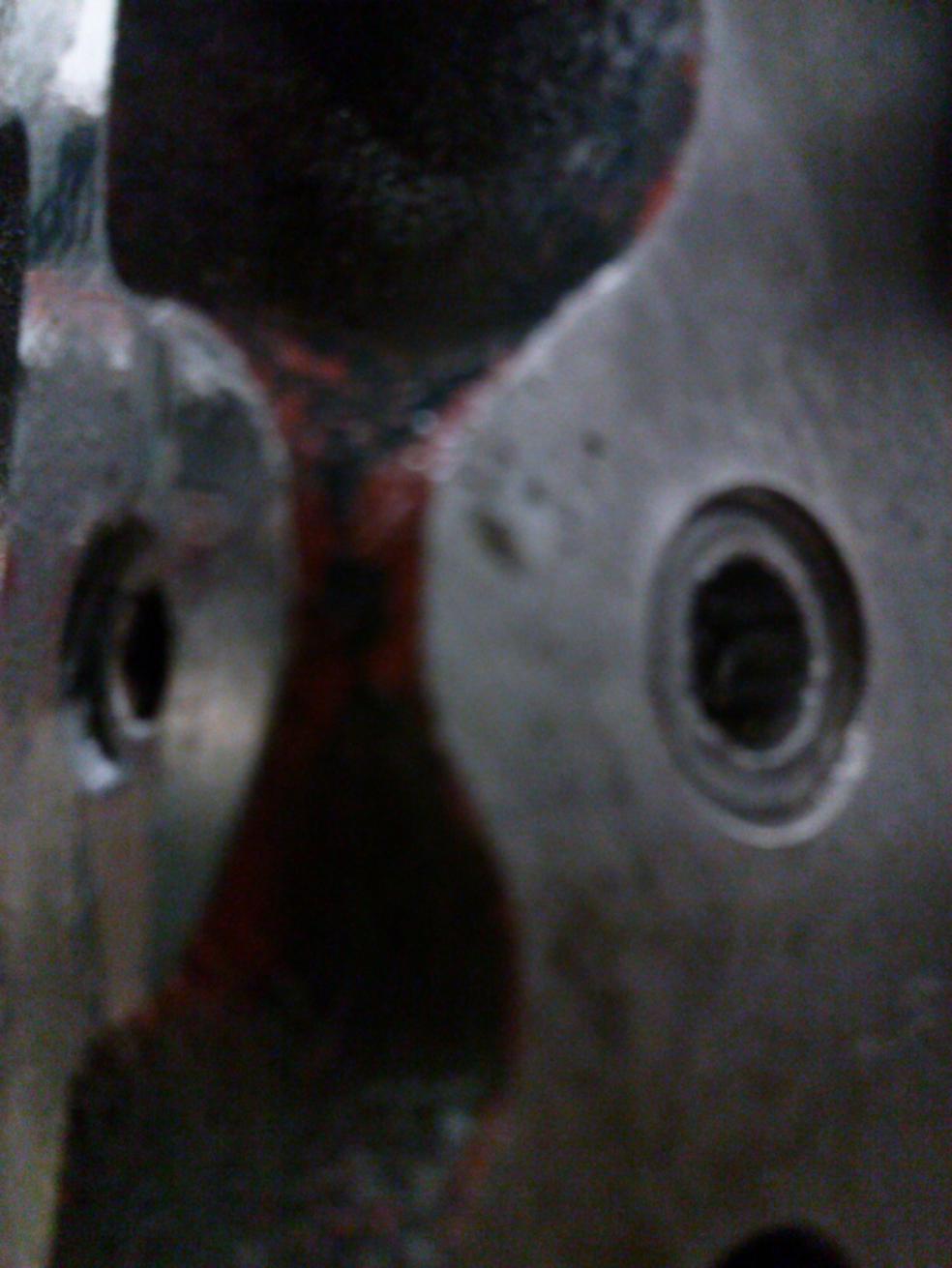

Thanks guys for the suggestions.
These pics should tell the tale. Look closely and you can see the pin hole and another pic you can see oil seeping out.
I've drained the oil and the engine is on the floor upright with nose down. I just bought some JB weld. I will stop at the plumbing supply and get some Xpando tomorrow.
I'll take a closer look at the block tomorrow and decide where to go from there.

Weird. Man, you're just lucky I guess....
Before I did anything else, I'd be calling Kubota. Talk with someone at corporate and explain the situation. I doubt they'd be willing to do anything but one never knows... This is CLEARLY a manufacturing defect. They might just be willing to take care of you. Yeah it's old and out of warranty, blah, blah, blah, but you bought a brand new crate engine and it's defective - PERIOD. Also mention that you are documenting this restoration thread on the Orange Tractor Talks site and you've love nothing more than to be able to give Kubota credit for stepping up and backing their products.
The other thought that comes to mind is brazing the holes up. A good machine shop would likely have other suggestions like maybe drilling, tapping and installing plugs. It's really hard to see it clearly because the pics are so blurry. My only concern is if the metal happens to be thin in that area. If so, it might not work to drill and tap.
If going the epoxy route, use lots of brake clean and compressed air to clean and dry the area first. You want all of the oil out of there...
That X-Pando dope looks to be very cool stuff. I'm going to order some just to have it around. Read the testimonials, lots of use with oil and at much higher pressures than we're dealing with. Would be perfect to use that with a gasket and the rear plate. It would force the stuff deep into the hole when it expanded if it had nowhere to go out the back of the block.
http://www.xpando.com/testimonials.php
I'd remove the plug on the back and side of the block to see what you see. I'm wondering if you could somehow seal the oil galley in a bit deeper so it would eliminate the oil at the very back of the block. I'm guessing the plug on the side of the block was for machining the passage to the rear main bearing. Obviously one can't block that off. That being said, there is no reason for the oil travel any further towards the back of the block beyond that main bearing passage. Hence I'm wondering if one could machine an aluminum plug that would fit from the rear that would be pressed in by tightening the threaded plug. I would think it would "dry up" any oil back where the casting shift occurred. Just an idea... You'd have to look carefully to make sure there aren't any other passages that you'd be blocking off. You ought to be able to see all of them with a flashlight once the plugs are out.
Finally one last thought is to machine a 1/2" thick bell housing adapter plate, mill it flat and gasket the entire back of the block. You would need to make sure there was enough clutch adjustment for the increase in depth. I mention making a new plate out of 1/2" for strength. It would be more likely to maintain its flatness once tightened up.
Perhaps consider gasketing the entire back of the block no matter what. It would add additional support to whatever you use to plug the holes.

Looking at the pictures and comparing it to the block I have here, I'm afraid that it's actually cracked and not a casting flaw.
It looks like there is a dent on the mounting pad directly over the side plug??? I could be wrong.
Being that it is that close to the edge of the block, I remove my earlier statement that JB weld would be the best choice, I now think that brazing it would be a way better option!
Like I said to you once you start to heat it with a torch, you will see any traveling cracks or holes and they will be better repaired.

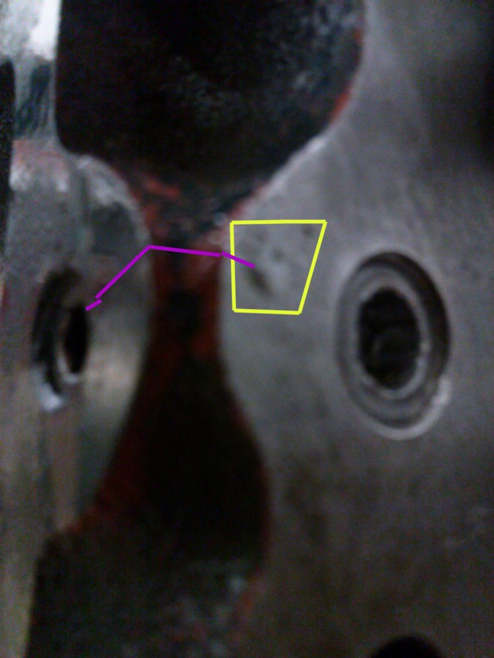

Just so I know I'm understanding things, the leak is at the spot in yellow right? If so I'm worried that it's cracked along the line in purple.
For others notes, the hole or crack is no bigger than a sharp pencil point, and the holes to the right and left are threaded plugs that lead to the oil galley for the crank shaft that were used when the machined the block.

Steve,
One other thing - in this case I would STRONGLY recommend you take the engine to a welder that works with cast iron on a fairly regular basis or at least has knowledge about it. This is not something you want to try using a little propane torch. Sounds like you work for a pretty good machine shop so perhaps one of the guys who does welding work in the shop would know how to properly handle it.
To do it right, the holes need to be opened up, the area preheated hot, hot, brazed, then slowly cooled down. To do the preheating correctly, one needs a decent size rosebud. It's actually a fairly easy repair, it just needs to be done by someone who knows what they're doing.
DO NOT let them weld this with nickle rod or try to tig it. Too much heat concentration in the weld zone and it will likely cause other cracks. Plus the weld will shrink more quickly than the cast iron when cooling.
If it is a crack as Shawn mentioned, then holes need to be drilled at either end of the crack to stop it from running further. If it extends from plug hole to plug hole, then don't worry about it as the plug holes will act as your "stops". He's completely correct that it will show once heated if it's a crack. Based on the other pinholes, I think the casing has porosity in that area and it's a defect. In either case, once heated good and hot, the bronze will follow the cracks or holes and you should be good to go. Bronze is plenty strong so no worries there, and unlike epoxy, the oil from the leak won't affect bonding.
Again, I'd make a call to Kubota before I did anything else. It likely won't go anywhere, but it can't hurt to ask. Need to get to someone fairly high up like VP of sales or someone like that. They may be willing to send a new block, one never knows.
Also, you need to decide which direction you're going to try. If you attempt an epoxy repair and it fails, then you have a mess from a welding standpoint. If it were mine it would get brazed. Food for thought...
Finally, those plugs should be removed or at least loosened while the heating taking place. They are a tapered fit and one doesn't want them expanding at a different rate than the cast iron and cracking the block any worse.

Thanks everyone for the great advice here. This is something I've never had to deal with before and I really don't want to make any quick moves on a repair that could break this projects continuation if it fails to work.
That said, I can positively tell y'all now that the block is NOT cracked. My machinist from work stopped by this evening with his friend from our local machine shop, that was a surprise visit as I was not expecting that.
They used some sort of scope, heat gun and some kind of chemical that they brushed on the area around the oil plug. I was assured right then that it was not cracked. They called it a cold casting flaw whatever that means, I don't know about that kind of stuff.
Yes it can be fixed and YES it will be fixed and NO I'm not the one who's going to be doing the fixing here, I'm gonna play this one smart and let the professionals who do this every day fix it.
I'm going to drop ithe engine off at the machine shop Thursday afternoon and leave it there. I didn't ask how long it would take to repair it because I didn't want to sound like I was being pushy in any way.
