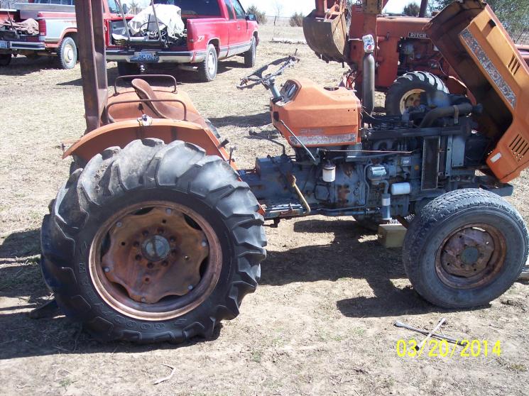

B7100 with a slight mechanical issue.

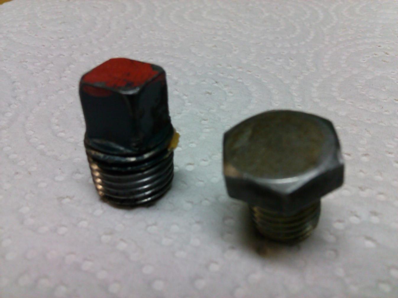

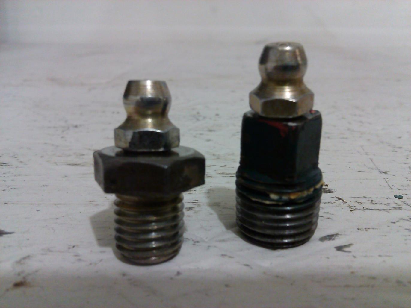

I've pulled the fill and drain plugs from the steering box so I can drill and tap both of them for zert grease fittings, this should be easy on the CNC drill press.

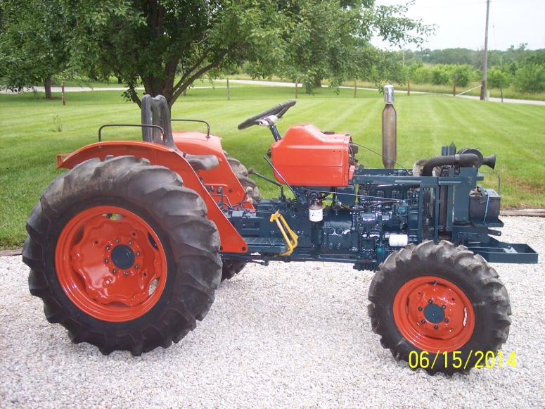

My L305 had been in a barn that had a fire, then set outside for 4/5 years. Here's a link when I first posted on this forum. http://www.orangetractortalks.com/forums/showthread.php?t=14932&highlight=L305
I used OSPHO rust neutralizer (I bought off of Amazon) after I power washed and cleaned(but nowhere near the extent you have). Then roughed up with a scotch brite pad before painting.
My friend told me, "1 part catalyst to 3 parts base". I used an inexpensive gun I've had for years, but I don't paint so I didn't really know if it would spray paint. I watched a couple of YouTube videos to broaden my horizons!
I mixed the paint as suggested but I didn't have an exact measured amount of catalyst, just a wild a**ed guess. I used Ditch Witch paint, because I had a gallon of it, and it's a working tractor. The blue is Kubota.
I bought a Massey 1246 loader and adapted it to the L305. I had to fabricate all the mounting iron. I have not painted the loader yet.
Here's some pictures as I rebuilt the tractor. I painted the front wheels first because I had to get new tires, and I decided if I couldn't do a half way decent job I'd get a high school kit to do it for me. (I know the local HS shop teacher and he has a couple of good students he'd recommend.)
After the front wheels, I proceeded. No where near perfect, but much better then spray cans.

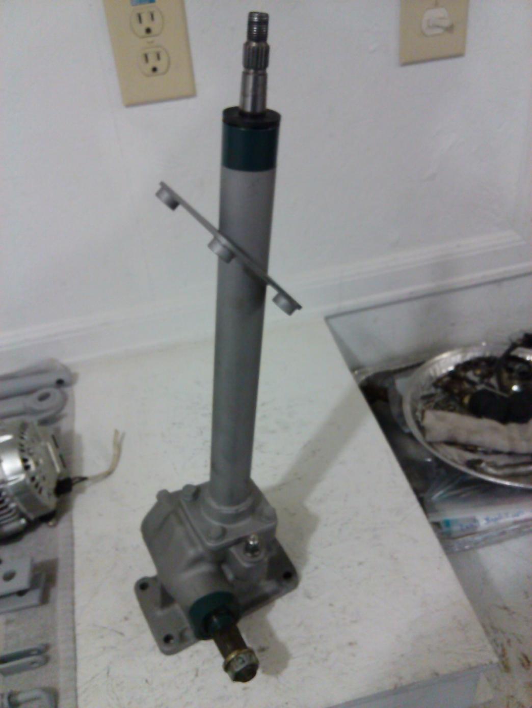

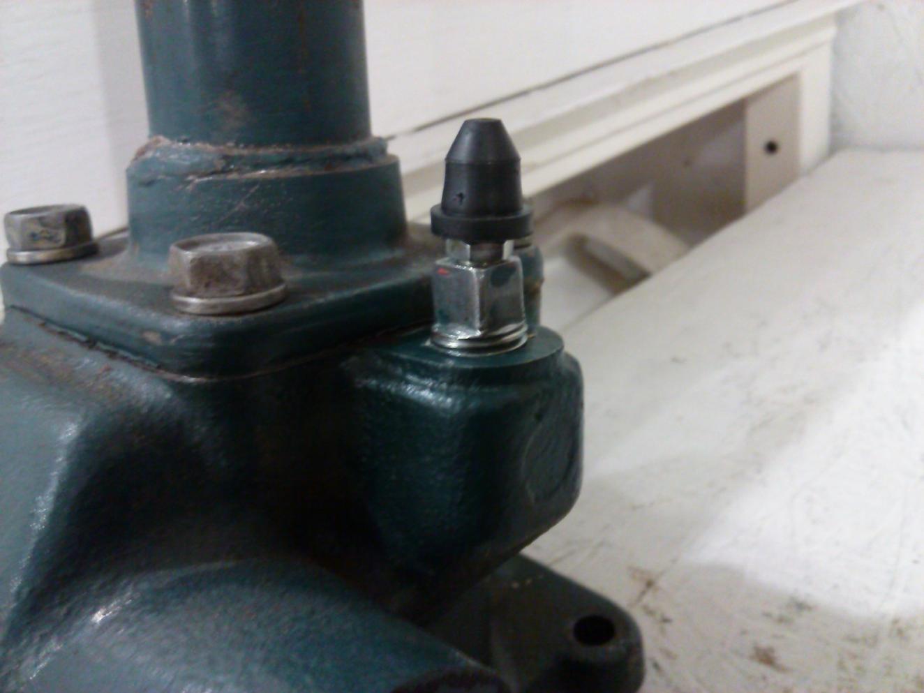

Got the oil plugs for the steering box drilled, tapped and new zert grease fittings installed. I'll take it to work and pump it full of grease tomorrow. I used our shop media blaster to clean up several parts today.
I've got a few more parts to blast so I'll be working on those through the week. I'll have some help prepping the chassis again this weekend.

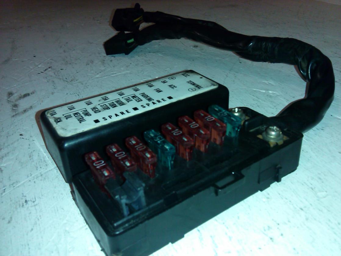

The fuse box I'm going to use for the electrical system is from a 87 Honda gold wing GL1200. It has 8 fuses and that's more than enough for this project, I got it in the mail today.

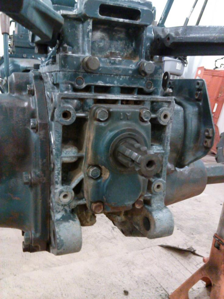

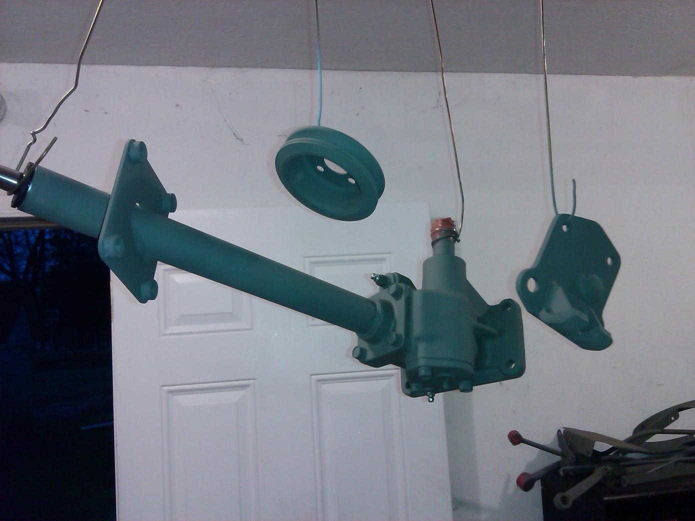

Got a few more parts blasted today. I went ahead and blasted the steering box too but only after I taped off the parts I didn't want touched. I also pumped the gear box full of grease.
I have just a few odd ball parts left to blast, I'll let dad do the rest because they won't fit in our blaster at work.
I made a small flat screen box that all the nuts, bolts, washers and such can go in so I'll have an easier time blasting when I get to it later this week.

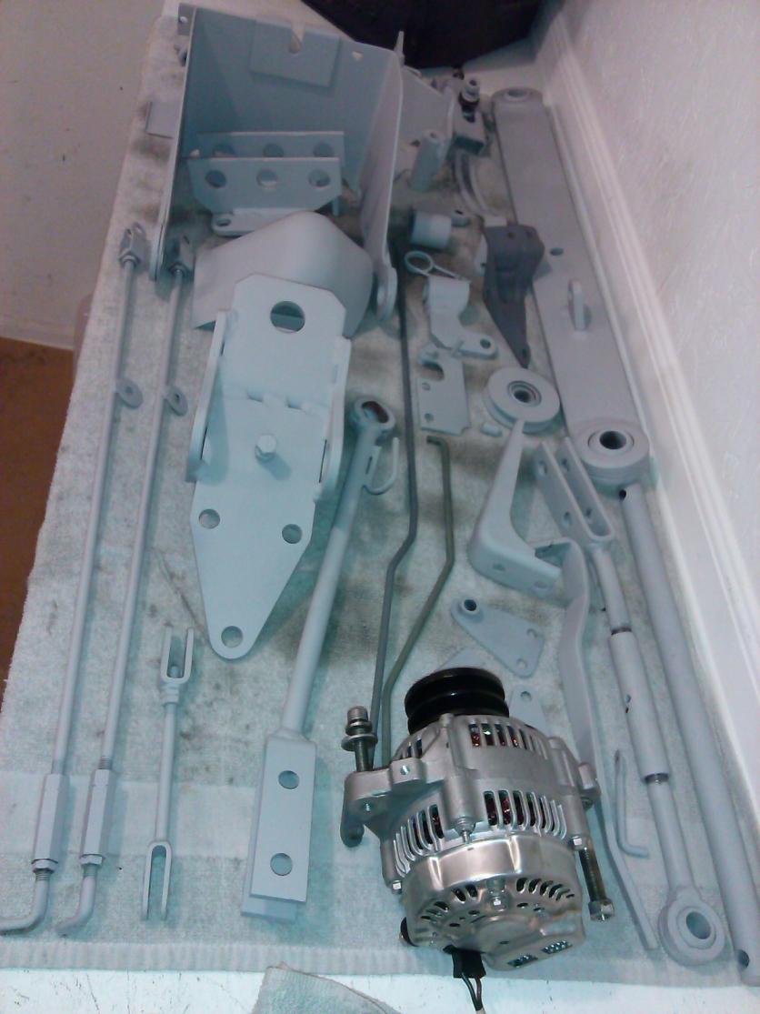

You know, that alternator would polish up to look like chrome. I mean, since the rest of it is looking so nice....
Just sayin...
Just sayin...
Hey Steve, great idea. How long would it take you to polish it up, I can send it out to you today.

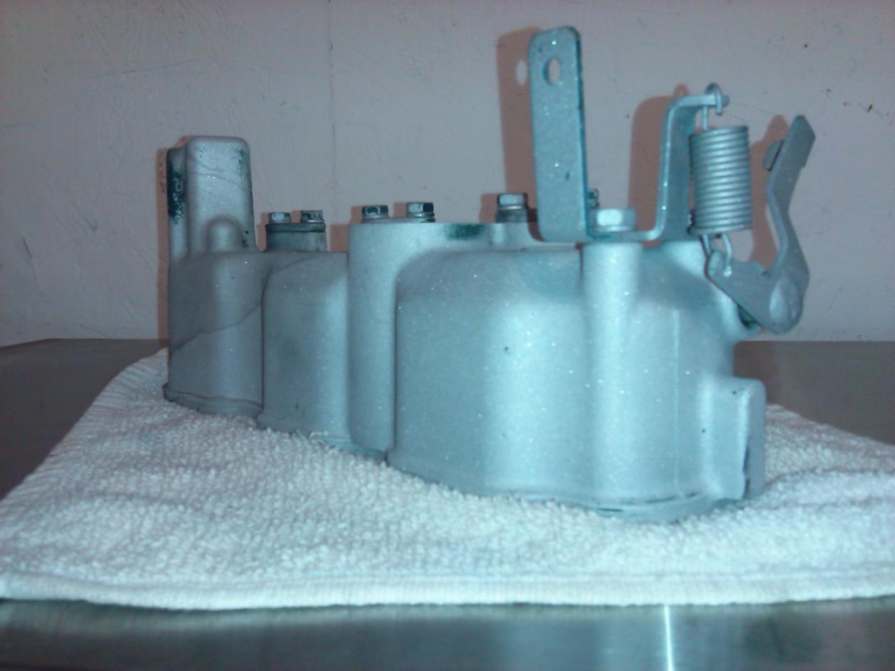

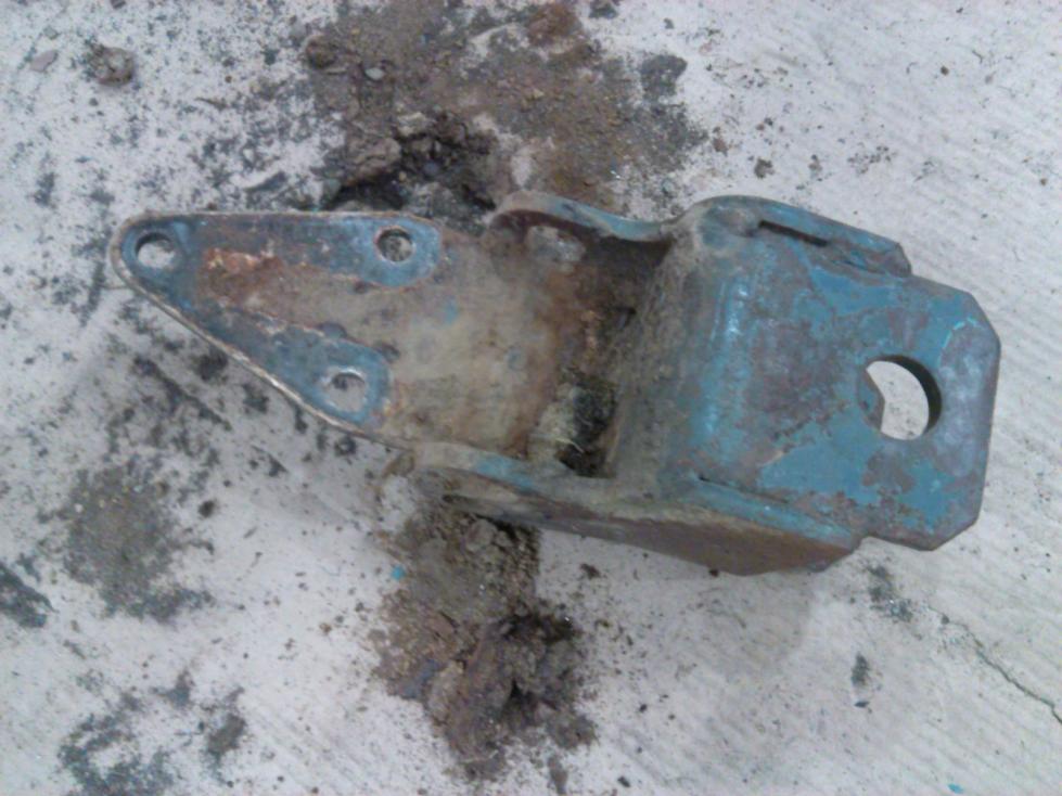

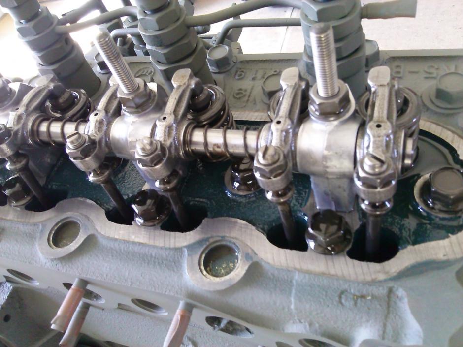

I've got all of the small parts media blasted with the exception of the valve cover, I'll have to redo that one. The D950 I have did not come with the decompression option. I searched eBay and found a valve cover from a D850 that did because I'd rather keep that option.

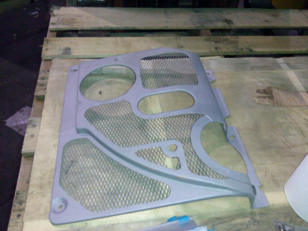

I'm going to try and replace a small piece of mesh screen on one of the engine side panels. I'll have to patch up the other panel the best I can with mesh I removed from one of my old panels since it was cut up anyway.
I've removed all internal/external parts from the replacement valve cover so I can properly blast it tomorrow. I'll need to run it through the parts washer afterwards.
All I've got left after that are the 23 or so zip lock baggies full of nuts, bolts and washers and I'll be done with blasting parts.

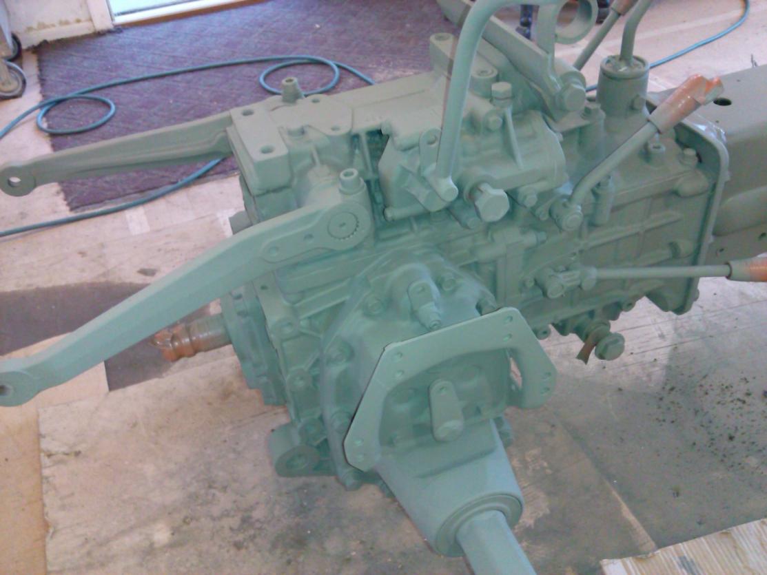

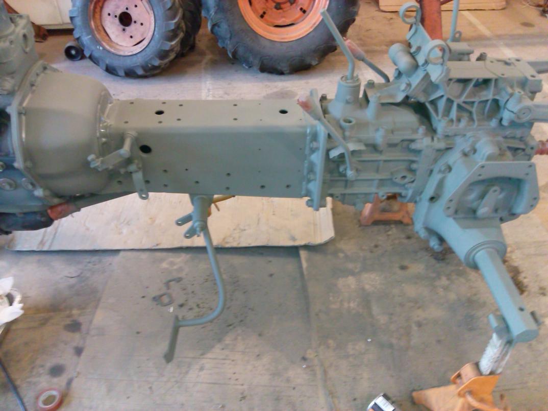

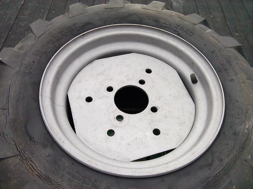

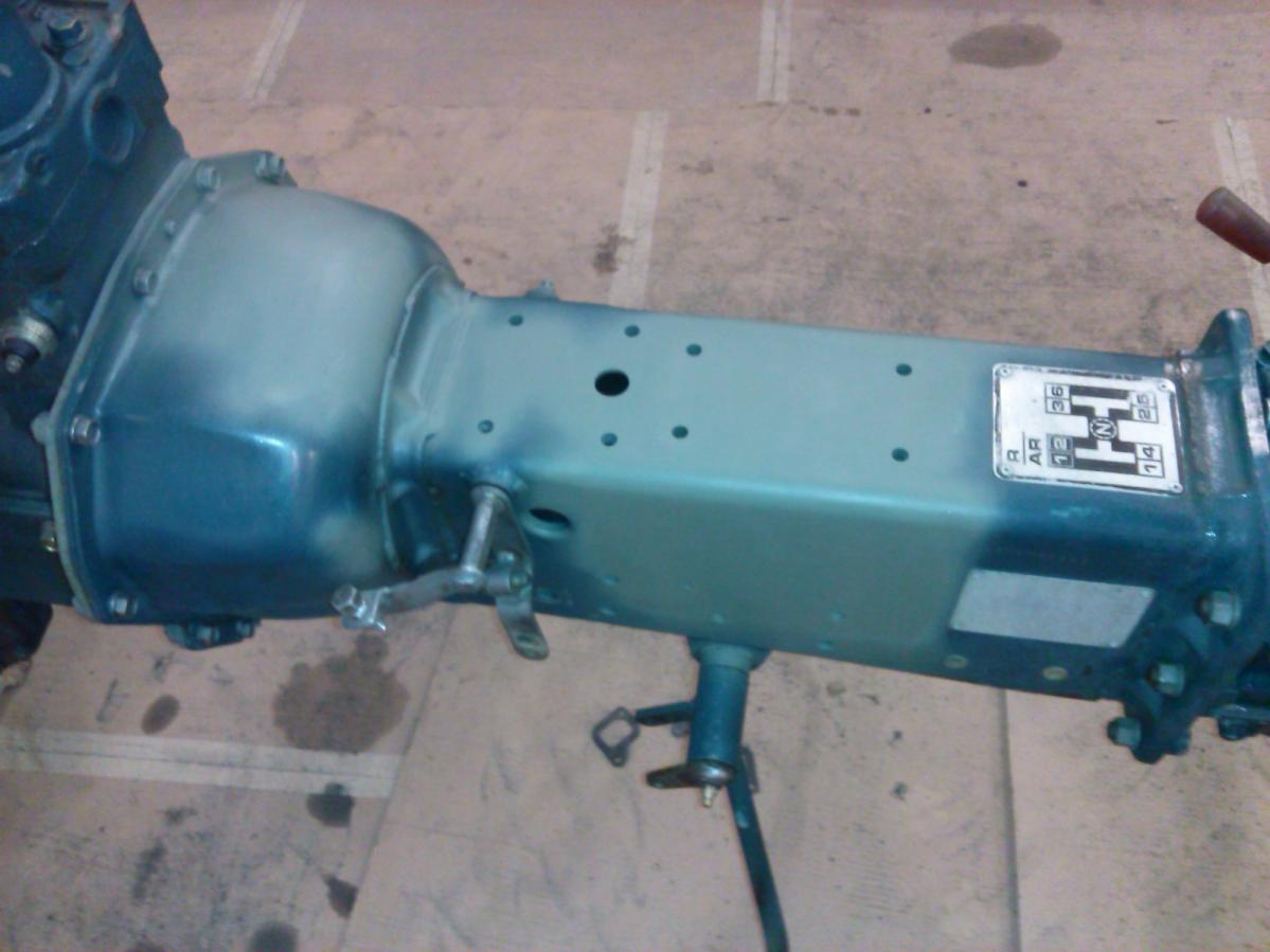

Alright, we got the wheels, hood and the last 2 loader braces media blasted yesterday. The wheels have some nicks and dents and were going to fix a few of them along with a couple minor dings in the hood and dash panel.
My dad will deal with repairing dents and dings this week because if the weather permits we are going to paint the orange parts next weekend, the loader frame and bucket will be done last.

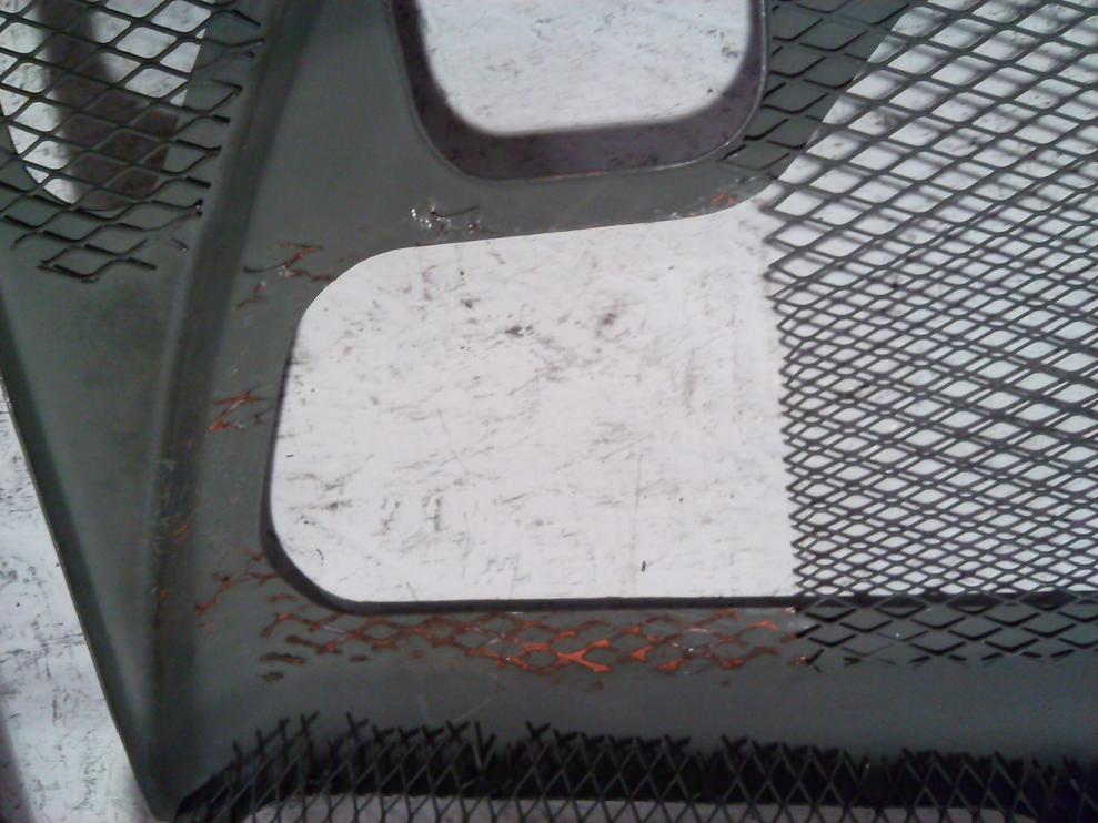

I've been working on the engine side panels. There was a small hole in the mesh where the belt adjustment is and there was a huge section on the other panel that was mangled up. I cut a few pieces of good mesh from my old side panel, trimmed those to fit and JB welded them into place.
I'm almost done with sanding and other prep work on the chassis but I have to pull the front axle apart to replace a leaky seal so I'm going to do all of them while its apart. I ordered the seals and some other parts from the dealer last week and I should have those by Thursday.
My painter dropped off his sprayer and some other stuff. I'm going to our local Sherwin Williams paint store tomorrow to have a gallon of industrial enamel mixed. If they can match the painted sample I have then we are good to go.

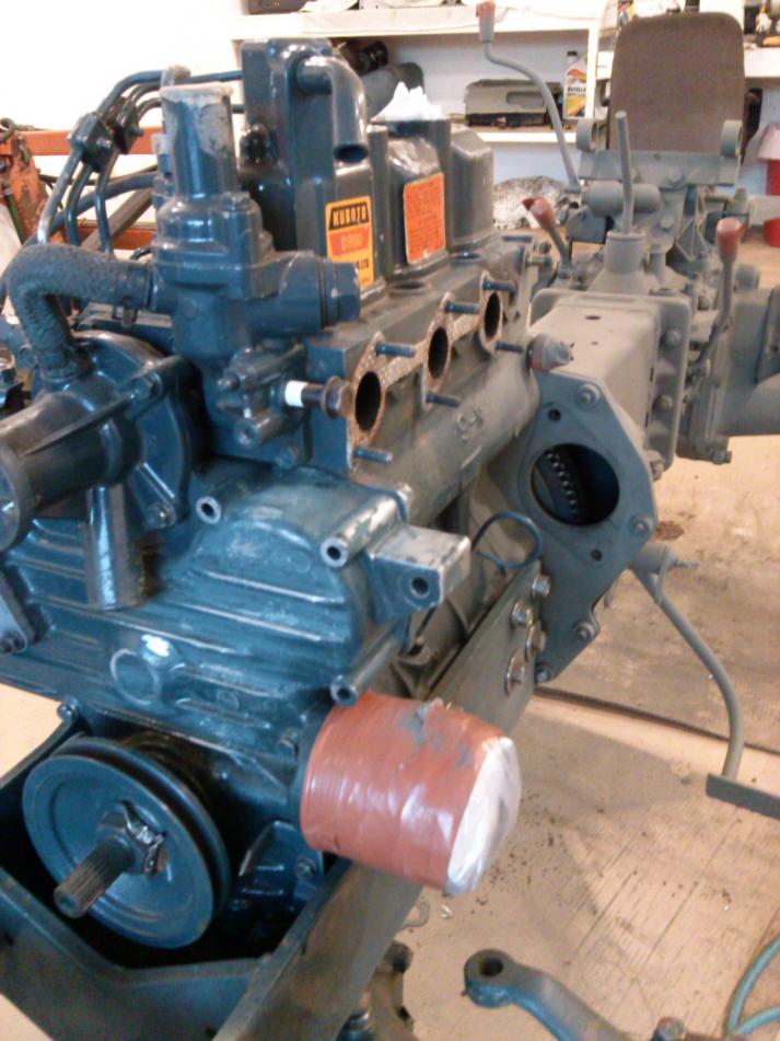

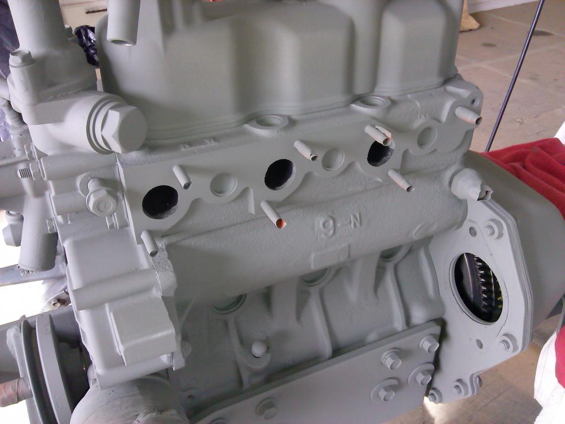

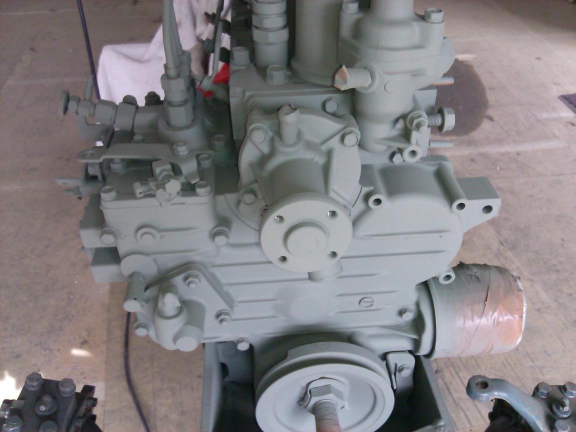

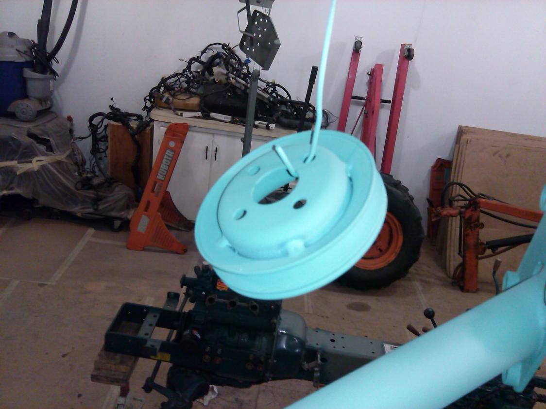

Almost done with the prep work. I changed out the valve cover and installed a new gasket, it was really clean in there. I used the CCV parts from the valve cover I took off because those looked brand new.
Got the extension oil fill spout on and tightened down. Everything on the engine has been prepped and in primer. I taped off fittings and exhaust studs as I don't want those painted.
I also finished up patching both engine side panels and I'm very pleased how my patch job turned out.
I should have my new seals for the front axle tomorrow. I'll need to tear it down and replace those before I do anything further there. I also ordered every seal needed to install the pump and hydraulic lines.
