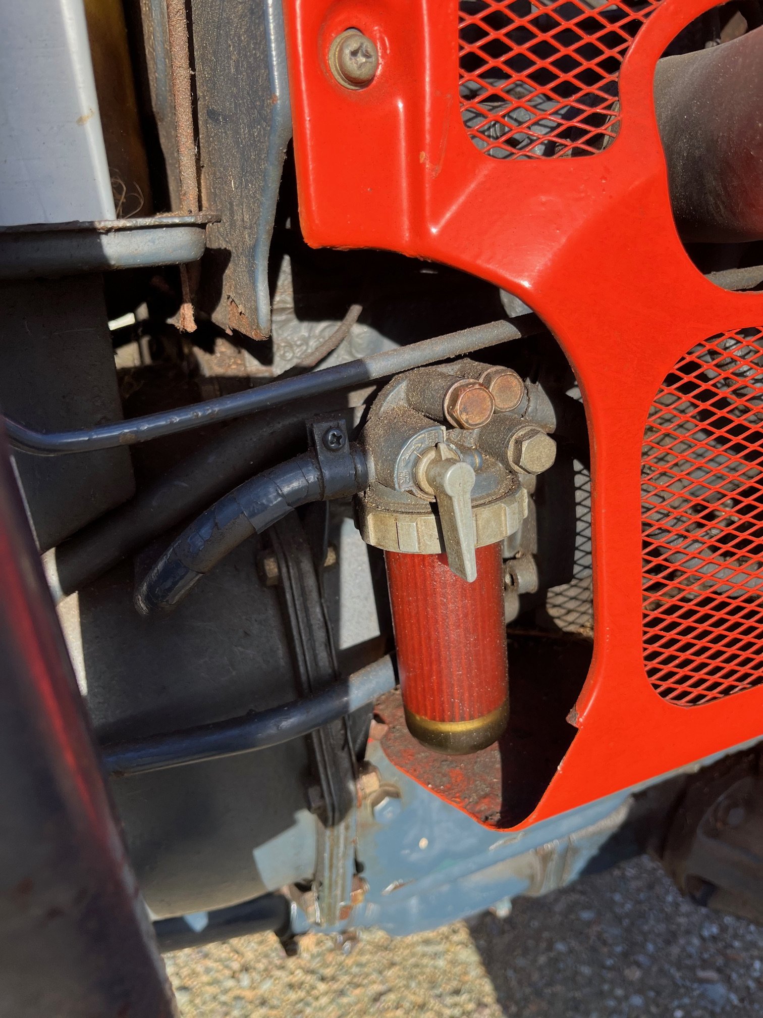

The B7001 was the Japanese market version of the B7100, and so it shares much of the same parts.
Look on the right side, just rear of the engine behind the fuel filter. Does it have the block pictured in the first post of this thread? If so, then this cover will work on your machine. If not, then you will have to cut into the line, as Dan mentions.

The pump is behind the sidecover, hidden by the air intake. I can see the line that comes from the pump and there's definitely no block. No diverter under the seat either, which really surprises me. Maybe very early model or maybe the Japanese home market didn't get them (the one visible warning label is in Japanese characters).
Well, like Dan said, you can always cut the line and fabricate your own set up. WARNING: you will need to ensure you have a way for the oil to circulate when the windmill tower is disconnected! If you run that tractor without a way for the oil to circulate, you WILL damage something in seconds.
Nor can you simply install a tee in the line. The 3ph has a built-in method of circulating oil so you will never build pressure in your accessory if you simply install a tee.
I suggest you study the manual carefully, draw what you think you want to do, and start a new thread on the topic for further advice.
