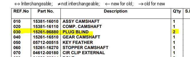

Your model is 1979 ... so I gonna say ...... plug be a missin':)
If you decide to drill and find that PLUG is in there...... OOOOKKKK .... did I mention the rear plug? That my friend is a royal FPITA:cry:

Assuming the camshaft plug has fallen out, I think we all understand that the oil pressure throughout the system drops because there is insufficient back-pressure in the camshaft branch of the system. Put another way, there is less oil going to the crankshaft and camshaft bearings because of the excess going out the end of the camshaft.
