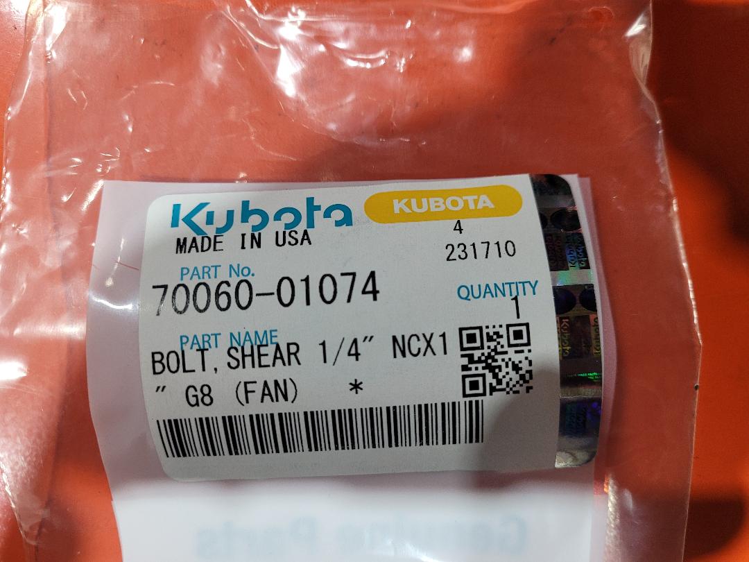

https://messicks.com/ku/86613 Once page load type SHEAR in the search box. Two items will come up. There are pictures of each if you select the camera icon.
15 BOLT, SHEAR 51&6- Shear bolts 70060-01337 $2.86 2 5/16(SPECIAL) LOCKWASHER & NUT 657296
20 SHEAR BOLT/GR 8- SHEAR BOLT 70060-01074 $1.26 1 1/4 NC*1 1/4 GRADE 8 & STOVER NUT 656048
Notice the fan shear bolt is grade 8.

The shear bolts i got from my local parts counter were all grade 5, and in fact the guy went so far as to say I could use the auger bolt in the fan.
The auger bolts I was sold were all machined to reduce the diameter, the fan bolts were not machined, but all were grade 5 stainless.

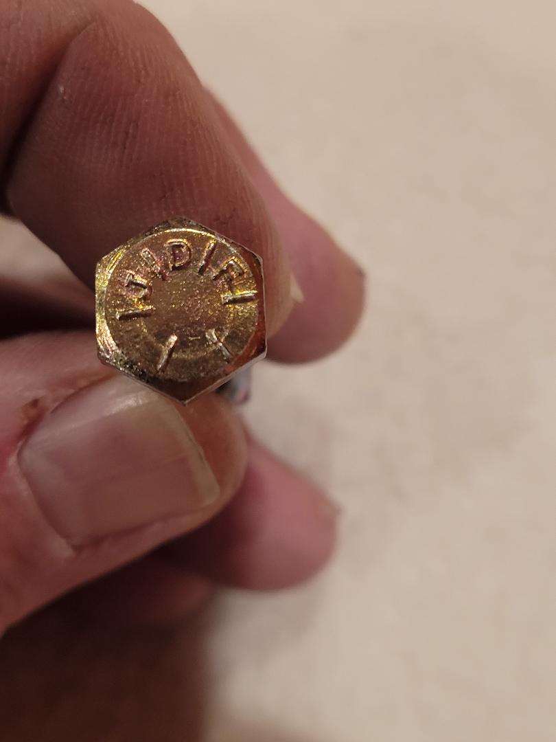

The replacement shear bolts given to me by the dealer when my snowblower was delivered were not grooved. Looking up the part number for the auger and fan shear bolts for my LX2980 which were found on Messicks' site are not grooved either.
Head markings (there are none) on my auger bolt identify it as a Grade 2 and the fan (3 lines radiating), Grade 5.

A long time ago I posted information about shear bolts because I thought a Grade 8 bolt was too strong for the impeller fan on my snow blower. Rather than repost the entire post here is a link (that I hope works) to the original post:
One thing I found out is that Grade 8 bolt is threaded which reduces the force needed to shear the bolt.
Second thing I found out last winter is if you tighten the bolt too much on the fan it won't shear. I found this out because a piece of my tar driveway when through the snowblower and ended up on my lawn. During the winter I noticed a slit in the bottom of the fan housing. I am guessing that piece of tar did that, so I am going to undo the shear bolt and make sure the two flanges did not rust together from the bolt being too tight.

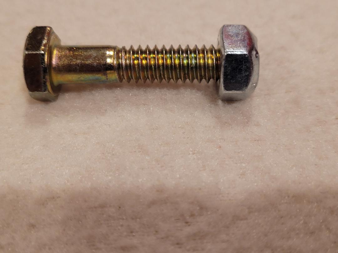

Bringing this up again because my local Kubota dealer is out and no ETA on new stock.
When I look at the bolts for the fan, compared to my auger bolts, these do NOT have a relief groove and to me appear to be just a standard bolt.
What is your opinion on the bolt, specialty shear or just standard.
No need to rehash the "only by Kubota shear bolts" portion unless someone has tried and failed with the standard bolts.
Thanks!!!

If you have one of the original shear bolts, take it to your local lawn mower shop and see if they have any like your Kubota Shear bolts. Also, some hardware stores have shear bolt selections. I just looked at Messicks website, and they have over 100 in inventory according to the website. Part # 70060-01338 Price $3.23 . I think that I will be purchasing some soft bolts and grooving them myself when I run out.
I am NOT buying from Messick's, the shipping is outrageous on something like this!!!!!!!
Again, no groove on these.

Are these the Fan shear bolt or are you using this in the auger?
