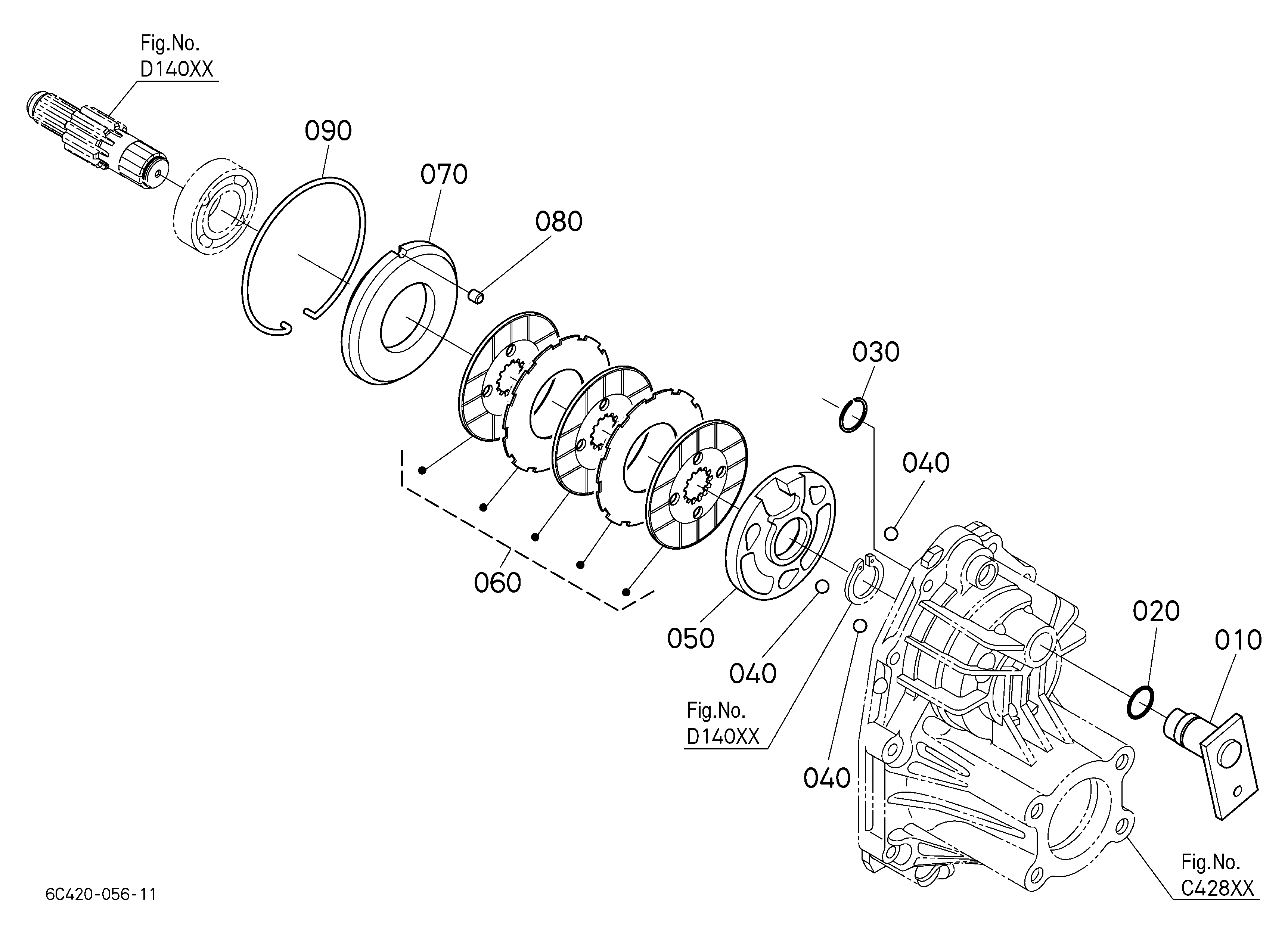

I just did some quick checking ... here's a link to the exploded parts diagram, available on Messicks.com. I also attached the PDF to this message.
I think your switch is assembly #060. The boot is #080.
