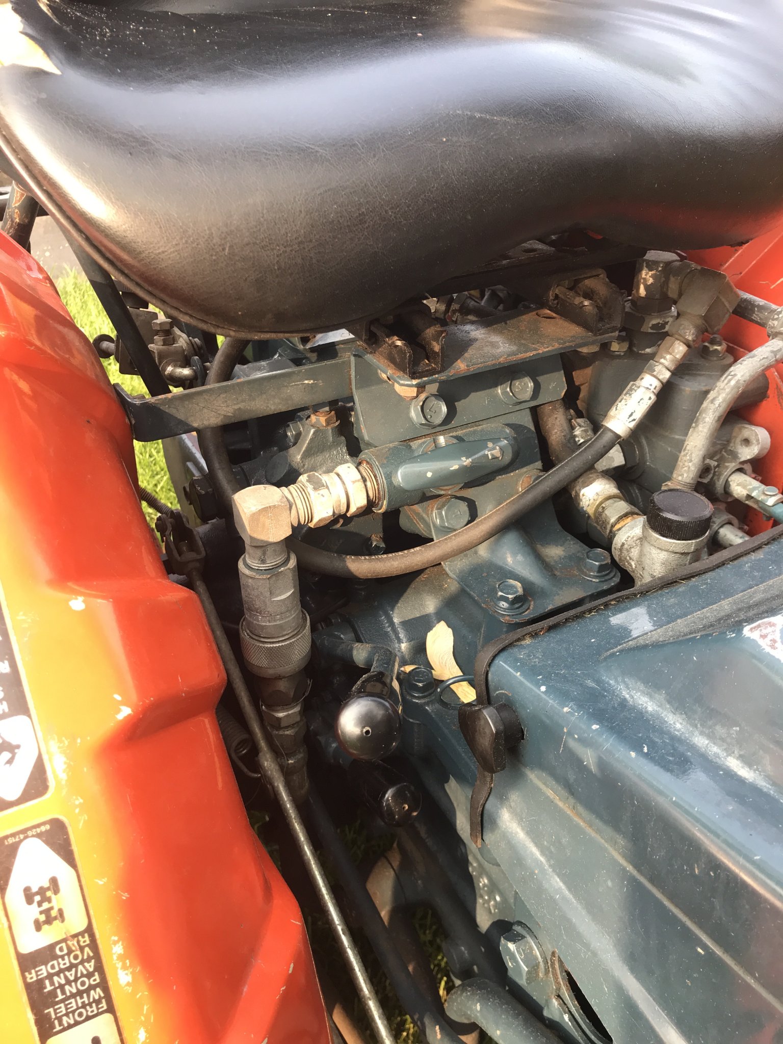

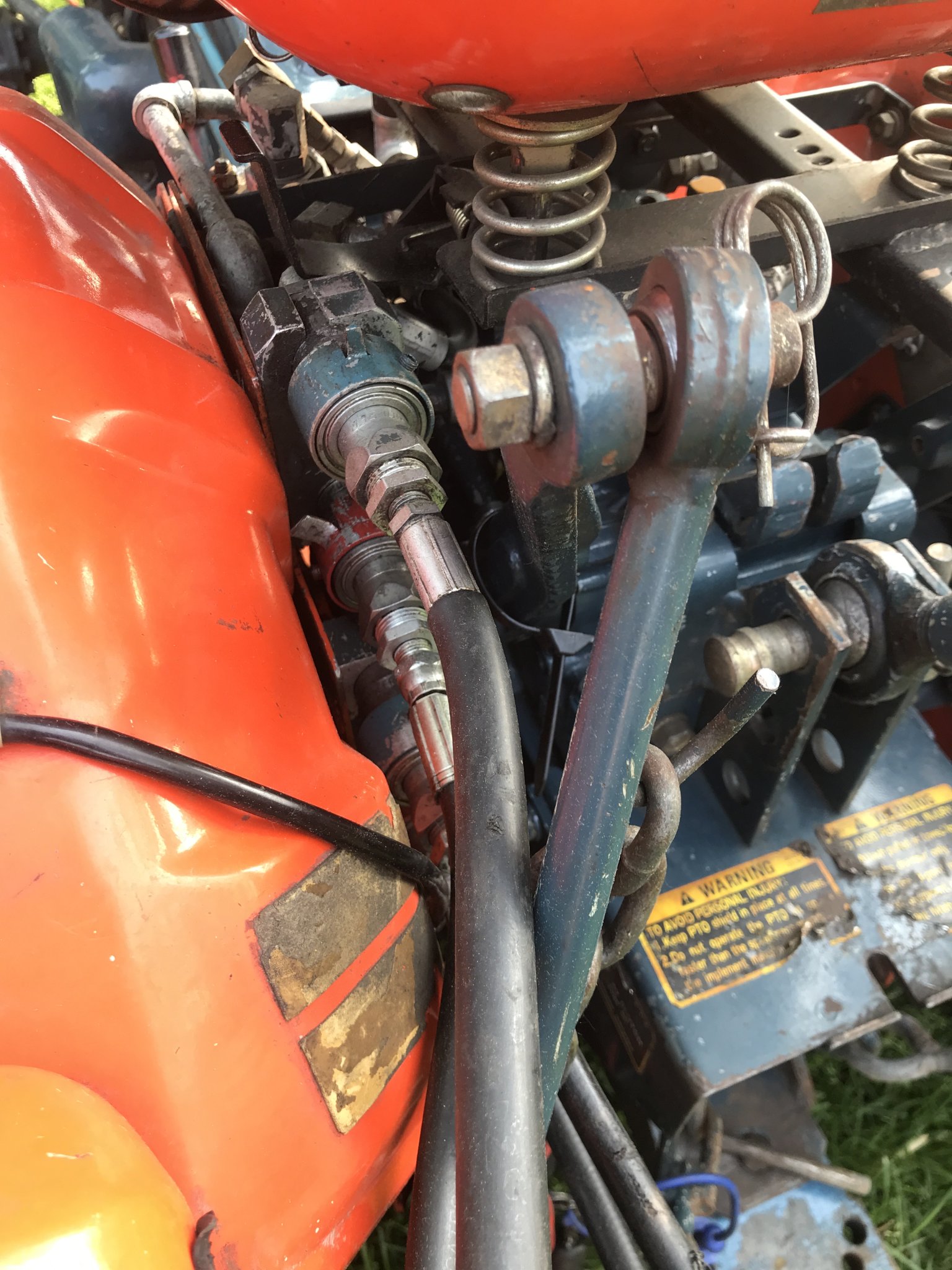

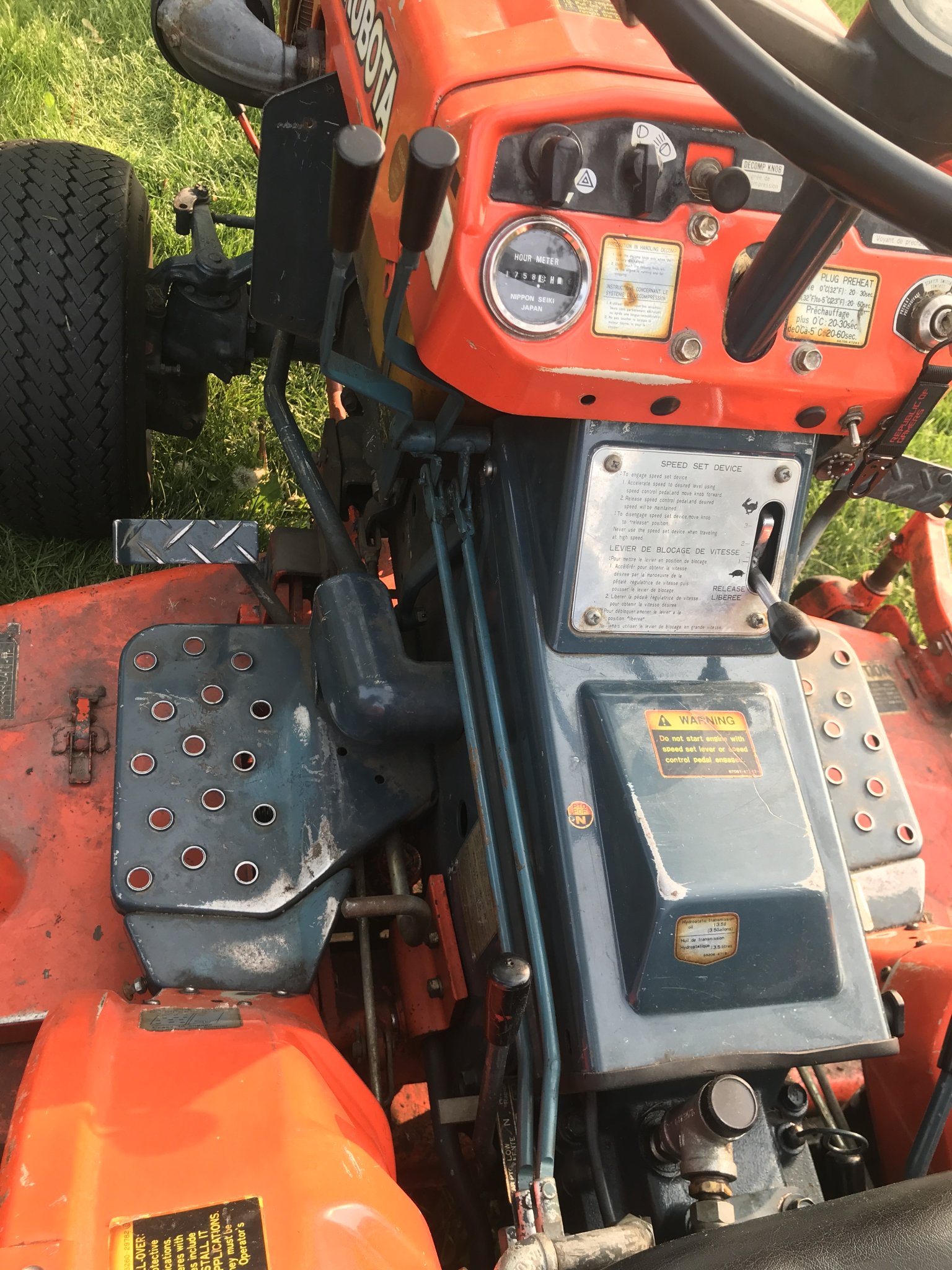

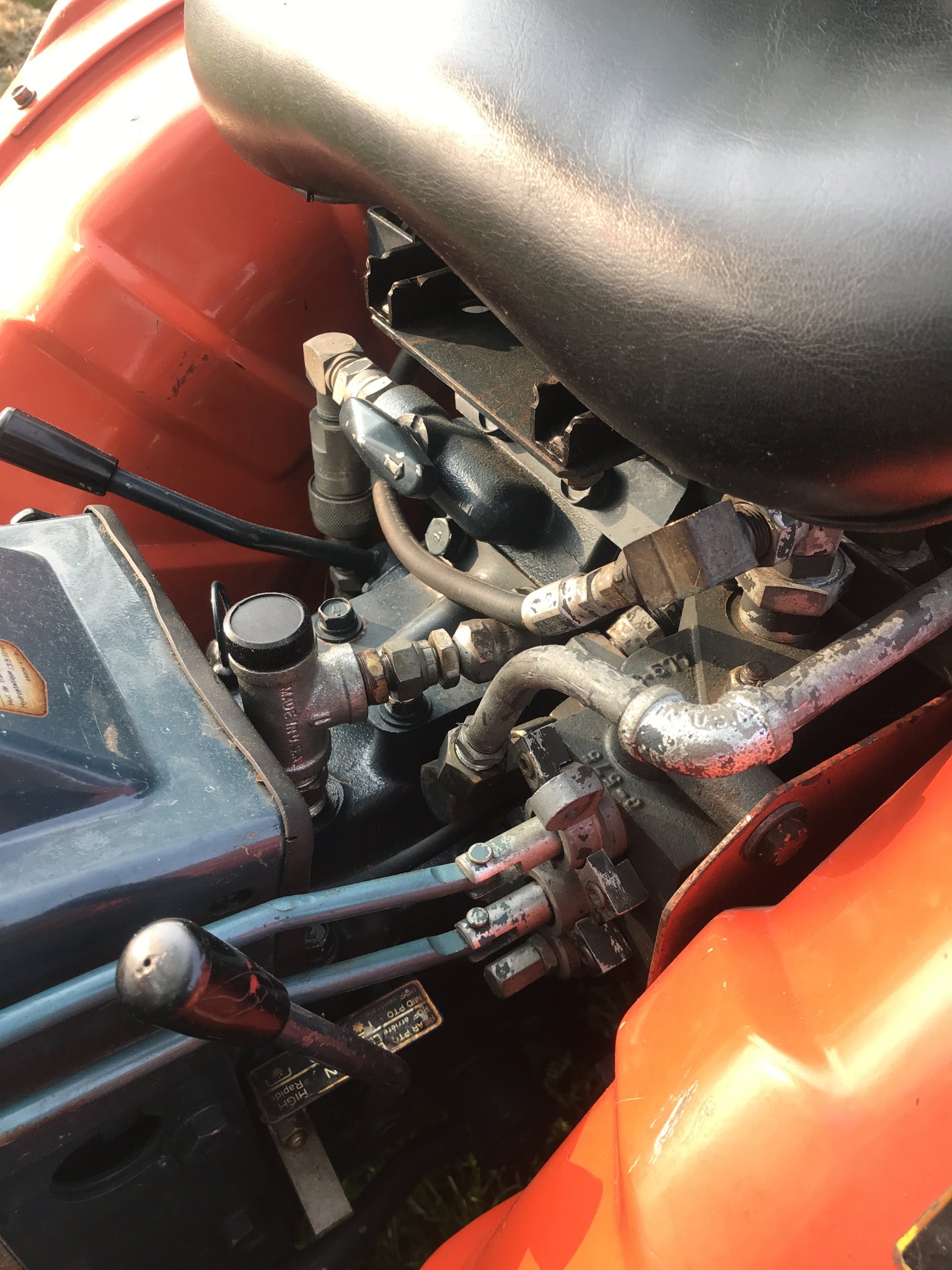

Bought the tractor with a rear pto snowblower. Previous owner used aux hydraulic to turn the chute, that worked fine. Two lines are available each with a lever.
Included is a homemade implement. A scraper blade with a piston to raise and lower and another to tilt the blade forward and back. Used it to clean his culvert ditch.
When connected neither ram will move. Tried moving hoses to each connection and no change. 3ph works fine moving up and down.
Is it the rams? Am I missing a switch I should be turning?

Read some more and figured out how to make it work. https://www.orangetractortalks.com/forums/threads/auxiliary-hydraulic.15413/post-119034
Hold the 3ph in the lift position. Then use the aux controls. As you can see in the pic both rams are dual acting.
