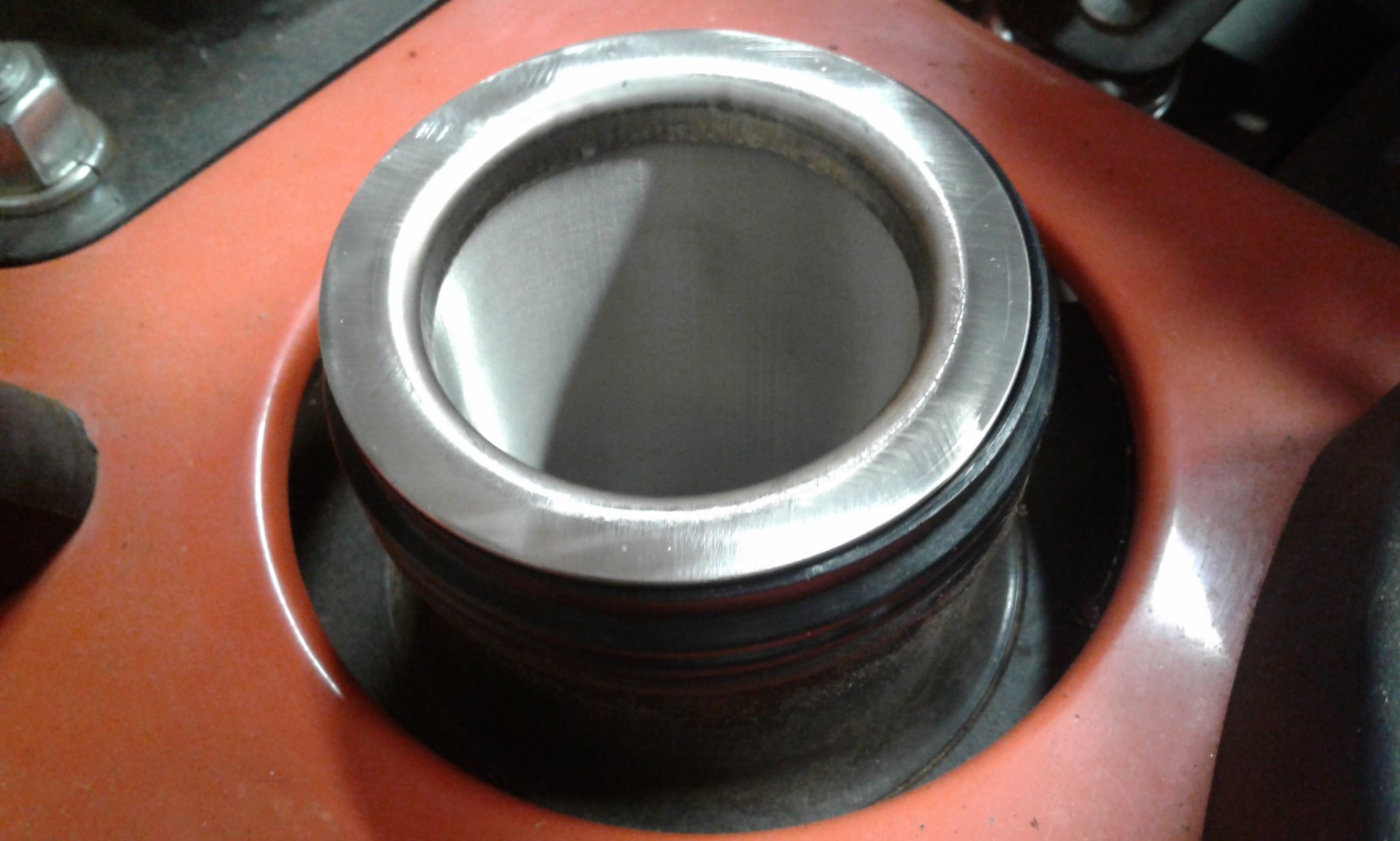

I got this made a while back - cost a little penny too! However if it went to production, it would have been a lot cheaper. Stainless steel - something like 75 micron, fits inside - never need to remove other than to dump out debris.
What is the exact ID of the filler hole on the L60?

Not bad, does that seal correctly? it is above the flange so the cap gasket would be against the strainer lip.

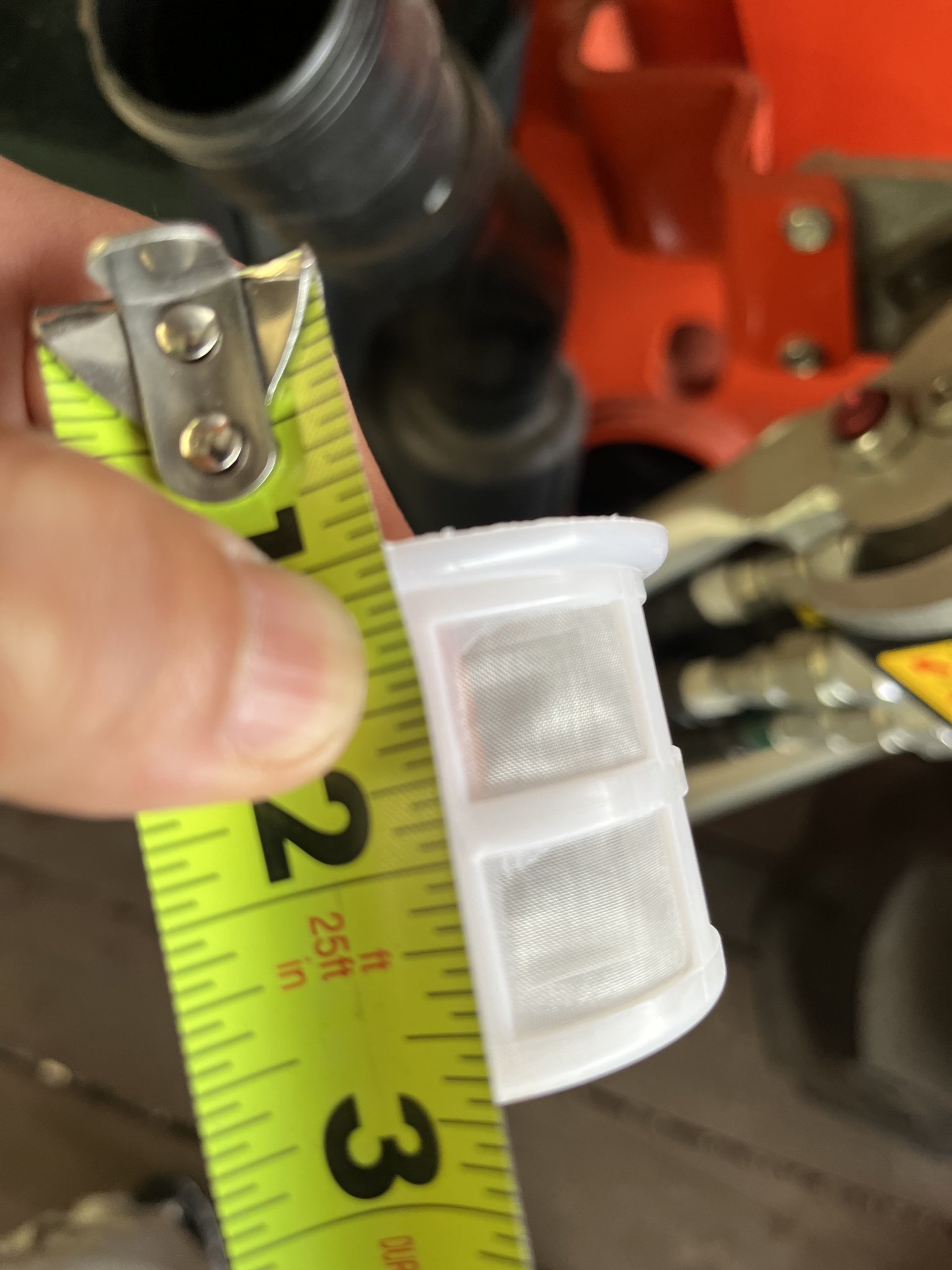

Not following the need. Keep bugs out maybe?
L60 have a dual split tank under the station. Is a major pita to drop if you have a loader.
More for sanity than anything. The mouth on the fill spout is over 3 inches. Never fails, I'm mowing and the wind is blowing and I know grass, bugs or other junk can fall in. Would be cheap insurance. There is a post someone made about filling dirty kerosene in his tank. If he had one of these the sediment wouldn't have gotten in the tank.

Looking at your pic in this post it seems you could have someone 3D print that framework and you could line it with the mesh of your choice maybe? they could also 3D print some retainer rings that could go around the outside or inside to help keep the mesh in place while it's secured with some fuel resistant adhesive.

I like the looks of that but have many memories of getting sudden gasoline splash back refuelling small engines. I don't like wearing diesel cologne.

Splash back is not a problem at all - it goes through as fast as you can pour- but what can be a real PITA is getting near the full mark and then NOT paying attention as the fuel rises ...... and it spills over.
I don't end up wearing it - I end up cleaning up after;)
I made a permanent "bent" nozzle that allows a pour to hit the bottom of the filter and not the sides. No splash - no overfill

Mike - you mean the filter or the nozzle? Nozzle was bought off Amazon along with shrink tubing and the filter was a custom design - but it could be made again.
