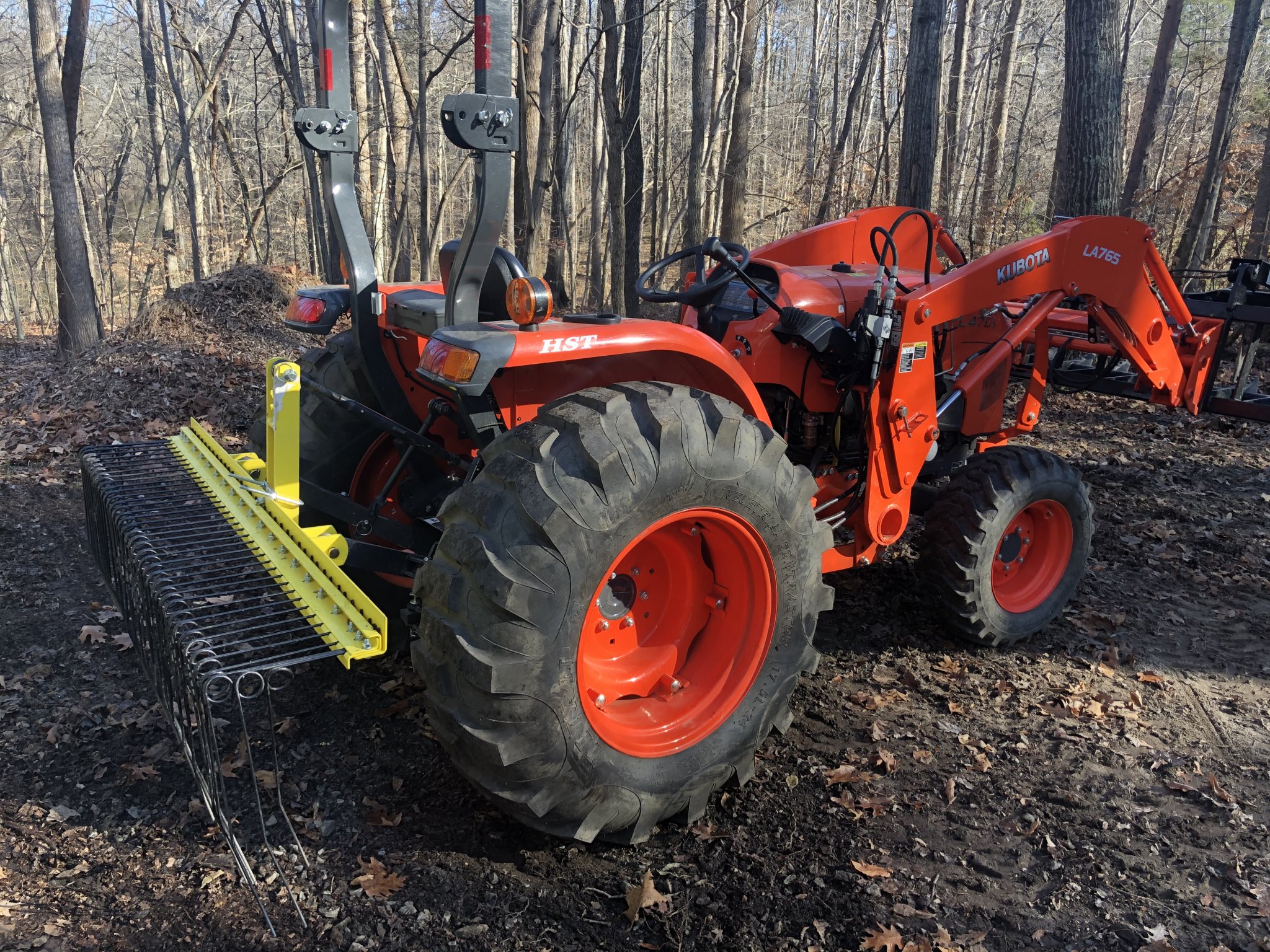

Look At the EA Pine Straw rake if you decide to go that route. Made in USA and is built nicer than the imports. Mine shipped Fedex in two or three boxes, so no delivery hassle. Only drawback is it was not Quick Hitch compatible. I knew that, but fixed it before I even assembled it.

I have a similar situation with maple leaves along our drive and private road. I have used the pine needle rake to clear it. However, once the pile is about 2' high, the rake is full, the tine springs flex rearwards and it starts skipping, leaving little piles. I get maybe 50' or 75' in one direction, then rake the next section in the opposite direction so I end up with a 100' or 150' clear stretch with a big pile in the middle. Then bucket the pile into the bush.
But if your leaves are already 2' deep to begin with, I don't think the rake will be very efficient. It will compact them somewhat, but I think the distance cleared before the rake starts skipping will be rather short, especially if the leaves are wet. Also, the pine needle rake works best on relatively flat surfaces. I don't know how dished your ditches are, but there is a good chance the rake would not reach down into the centre of a deep ditch.

What about a pine straw rake?
Been using mine for 2 years now. Even fabricated a rear center mount adjustable gauge wheel on it. Just the ticket for moving a large amount of debris while sparing the surface it rakes.

I use a cheap Chinesium pine straw rake a couple of times a year to gather the leaves in the three yards and variety of other places on the property where leaf cover is undesirable. Not exactly recommending it as it’s lighter than light duty but it does the job and it just sits in the shed 363 days a year. When the leaf piles get too much for the rake, they’re big enough to pick up with the grapple. Between the grapple and rake 95% of the leaves go away. For the other 5% the zero turn finishes off the grass and blower finishes off non-grass areas very quickly.
Looked at leaf collection systems and PTO blowers. I’m sure they would be wonderful. The Chinese rake was about $350 a couple years ago. The other options, I just couldn’t bring myself to part with the $.
If you have to rake leaves, a 72” rake on a 3 point hitch is better than an 18” rake on a stick.
