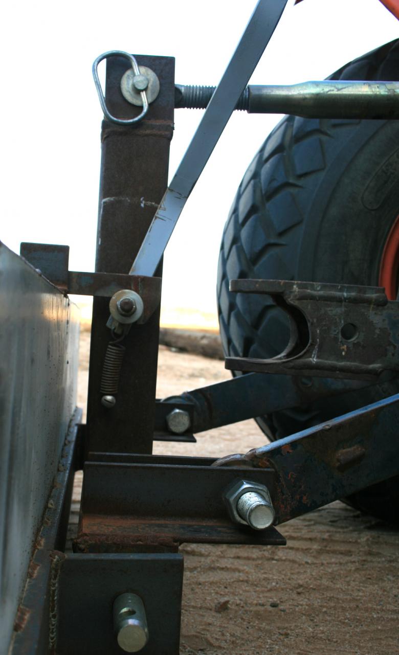

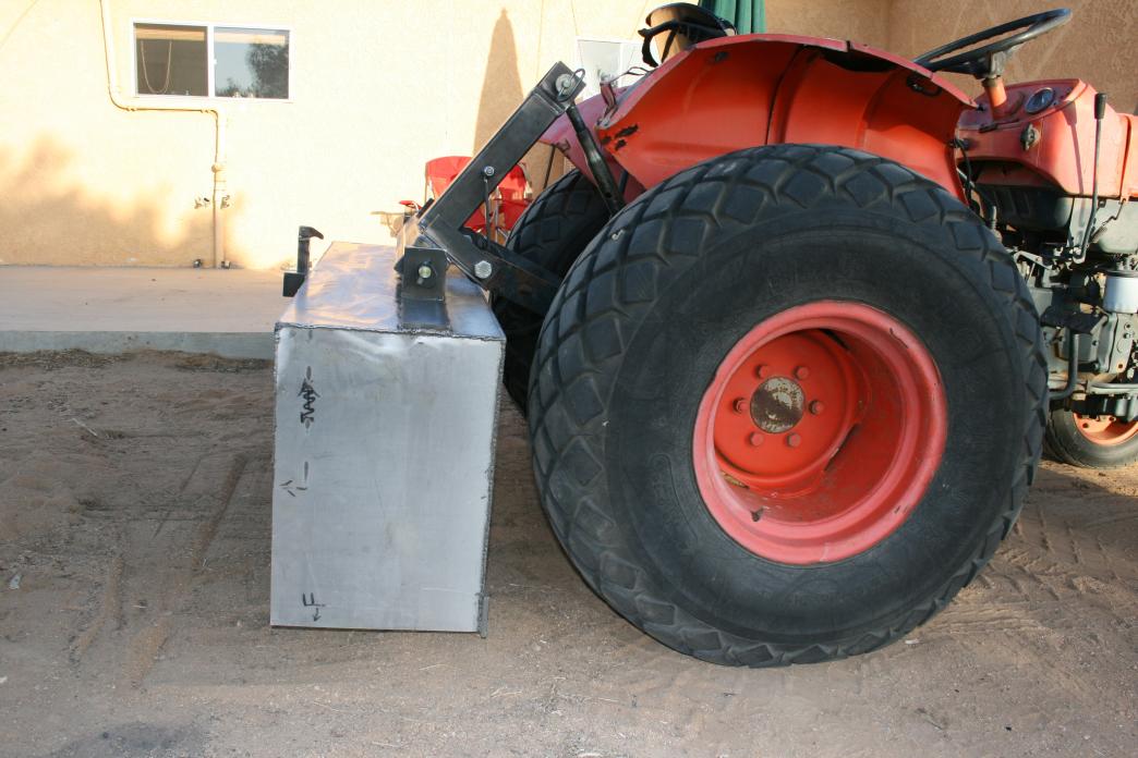

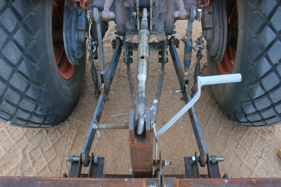

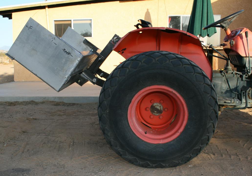

I welcome your thoughts on this and thank you for your time. What I really need is a controlled tipping of the bucket. In the attachment you can see how close the solid frame hitch is to the bucket. In an uncontrolled gravity dump the bottom of the bucket bangs into the hitch. As it is now I have to lower the 3 point so the edge of the bucket hits the dirt then raise the 3 point up to finish dumping.
As you can see in the attachments I've tried to get the release handle up where i can get to it. But with my old shoulder injury it still becomes a problem.

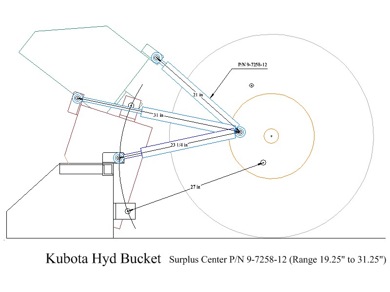

In the line drawing you can see what I'm planning. I'm going to go with lower lift arms that are 27" pin to pin. The arms on the Kubota are now 23" pin to pin which leaves me with little clearance between the hitch and tires. Attaching the top link directly to the top of the bucket will allow me to eliminate the T section holding the latch.
I think I've found a cylinder (on the line drawing) and a single spool with power beyond (Surplus Center P/N 9-7861) and I'm pretty sure I can machine a diverter block. What gets me is not knowing if these parts will do the job or how to route the hoses before spending a bunch of money.

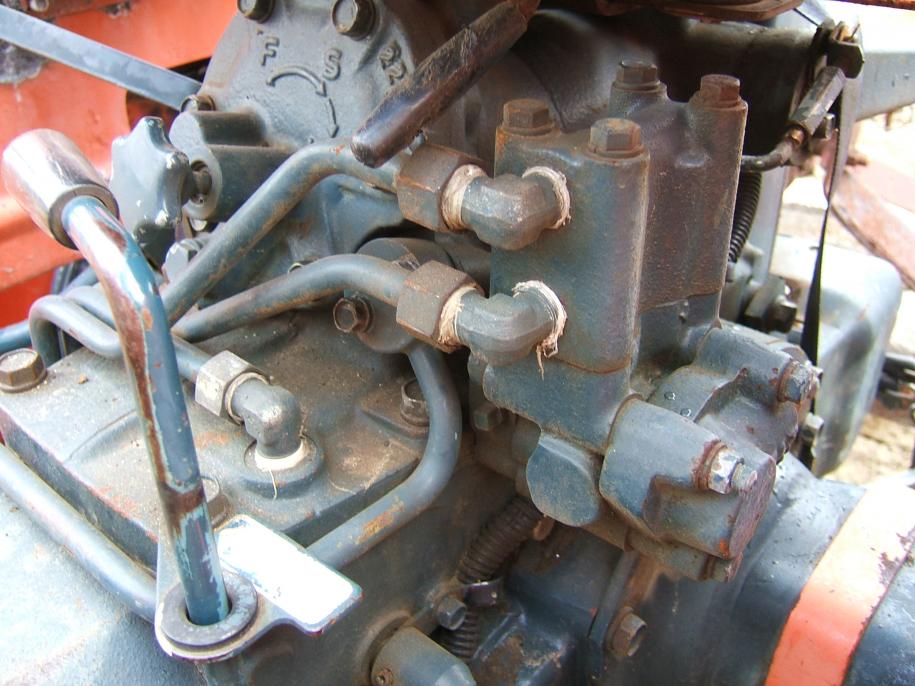

Thanks for the help guys. I've been doing a lot of studying the last couple of days and there is one sure way and one possibility to tie into the high pressure line.

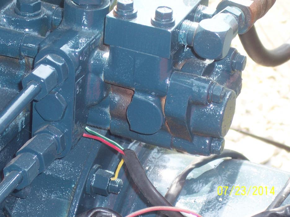

The sure way is like North Idaho Wolfman said; split the high pressure line and go to and from the valve. The attachment shows the (other possibility) cover on the 3 point hydraulics and it looks like there may be a port on the front. I'll have to wait until I can get out to my cabin at the end of January to check that out. I need to verify some measurements on the bucket before I can begin to modify it anyway.

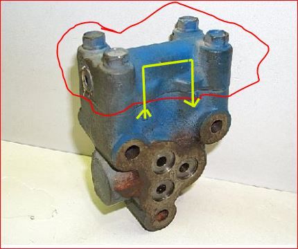

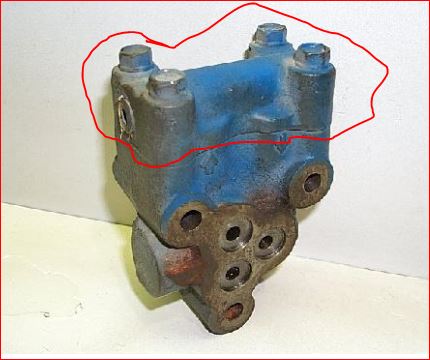

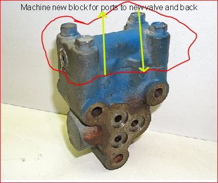

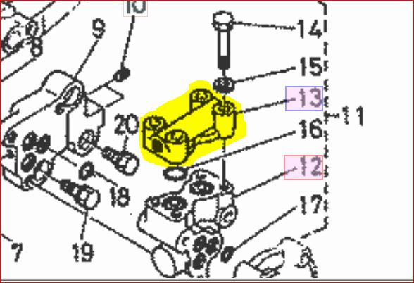

That model is fairly easy to tap into the hydraulics, the cover with 4 bolts ac be removed and replaced with a block to directly tap into the pressure of the system, in and out and your done.
Trying to purchase the block is not easy but if you can machine it, then you've got it made!
Part#13 is the part that need replaced:
That block has a path that allows fluid to flow in and out.
New block should have 2 threaded ports for new in and out.

NIWolfman... aren't those end caps on that top block the taps for that flow? They look like they have allen screws on them from those angles.
I think there is a screw in for them that blocks the flow between the channel and diverts it out to the external hydraulics. Or it looks very similar to a system I have worked on that did that. It looks very similar to a power beyond interface.
28,710
5,125
Aren't those end caps on that top block the taps for that flow? They look like they have allen screws on them from those angles.
There is only one plug (end cap), it is there from when they cross drill horizontally to connect the two vertical port holes, you could either drill from the other end and block the center cross over to get it to work, but I'm not a fan of messing with cast like that, too easy for the whole thing to go bad!

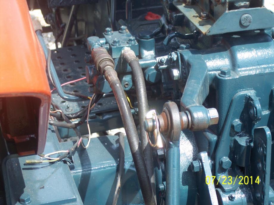

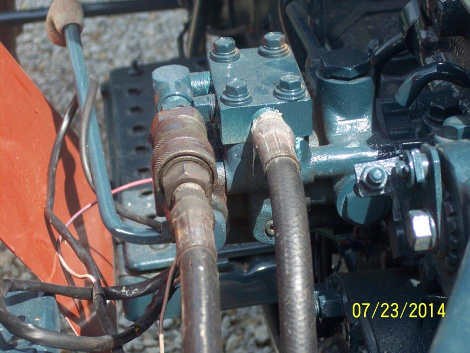

Wow, I'm learning a lot on these Orange Tractor Talks forums. The attached picture is from another thread and it shows how Kubota ties into the hydraulic system.
I'm thinking I'm going to make a block like the one D2Cat showed. I spent some time as a machinist/toolmaker and it doesn't look that difficult. I've seen more pics of this block on other forums. It's just four bolt holes and two threaded holes in a block of aluminum. I just have to get out to my tractor (130 miles away) to pull the dimensions. With Christmas visitors and my rotating days off I won't be able to do that until the last weekend in January.
I would rather make the block than splice into the high pressure line. If I screw up I can remake the block or put the original cap back on. Screw up the HP line splice and I'm down until I can get another line. I have mountains of dirt to move and can't afford down time.
Thanks again to everyone that has showed interest in my project. NI Wolfman your attachments are invaluable, I learn from each post.

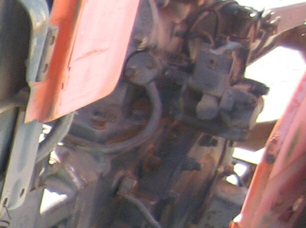

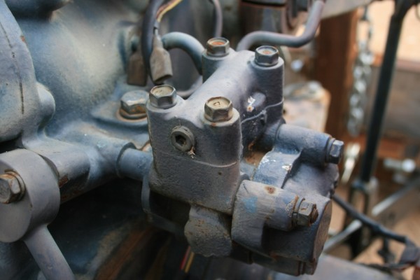

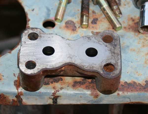

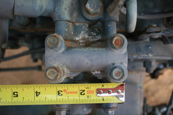

UPDATE: I've got my new lower lift arms installed and took some pics of the part that I'm going to replace. It's much smaller than I remembered it being, it's only 3 1/4" on the long side. I thought I was ready to start machining the adapter block but I realized I didn't take dimensions matching where the hydraulic fittings need to be. I'll have to take the part off to get the dimensions from the mating surfaces.

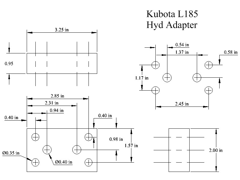

I've got a prelimenary drawing done. I don't have the hydraulic port dimensions so don't use this drawing yet. I'll post another drawing when I get all the dimensions nailed down so someone else can make one if they want.
I'll be out to the cabin on the week end of 3-13 through 3-15 and will get the dimensions then.
Sorry this is taking so long but life keeps getting in the way and I have to set priorities.

I went out to the desert property and pulled the part I'm going to replace with the adapter block I'm going to make. I got some pics of the part and where it was mounted. I also made a drawing taking the dimensions off the casting. You're welcome to use the drawing but know that I have not made the adapter yet and the drawing is unproven. I used a 6 inch dial caliper and checked the dimensions all the ways I could without inspection equipment. My dimensions are in decimal inches and the part was made to millimeter dimensions. I think that is why some of the dimensions seem a little odd.
I'll update this thread when I get the block made and check the fit.
