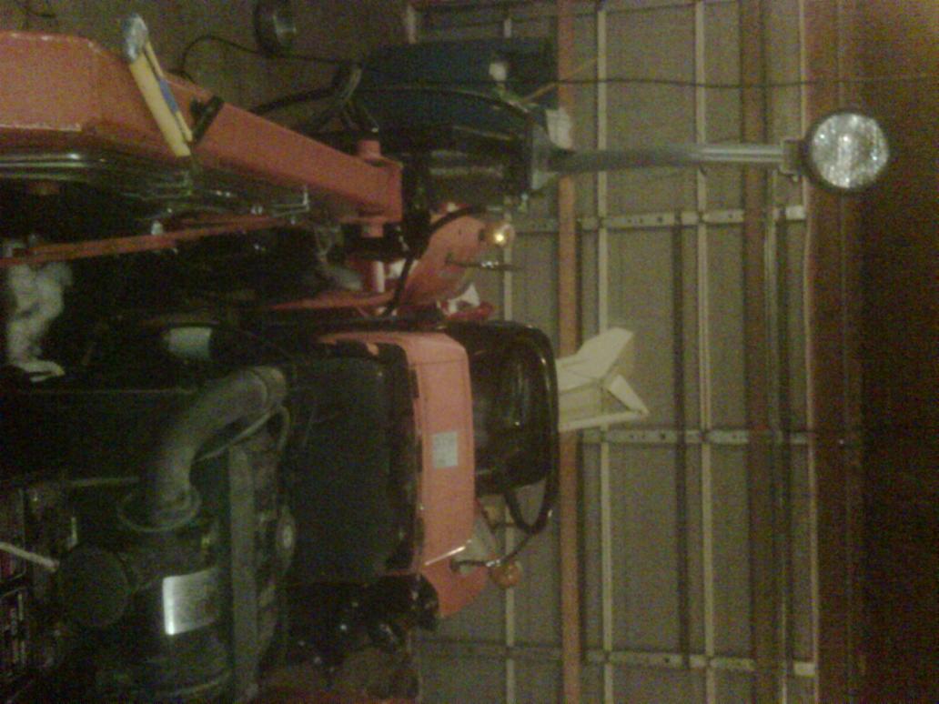

Attached is a 3 pack of pics.
Originally I was going to use 1 inch pvc as a light stand.
Toying around in my garage and I came across an old satellite dish bracket.
Perfect!
All wires are now run.
Battery post to fuse, to toggle switch, to light.
Still need to attach the light so it can swivel 180 degrees.

Dish arm makes a terrific base. Tilt is a nice touch.
I'd like to add 5 feet of wire at the light.
Be able to remove it and reach all corners of the tractor.
Will add two led lights on the rear fenders.
