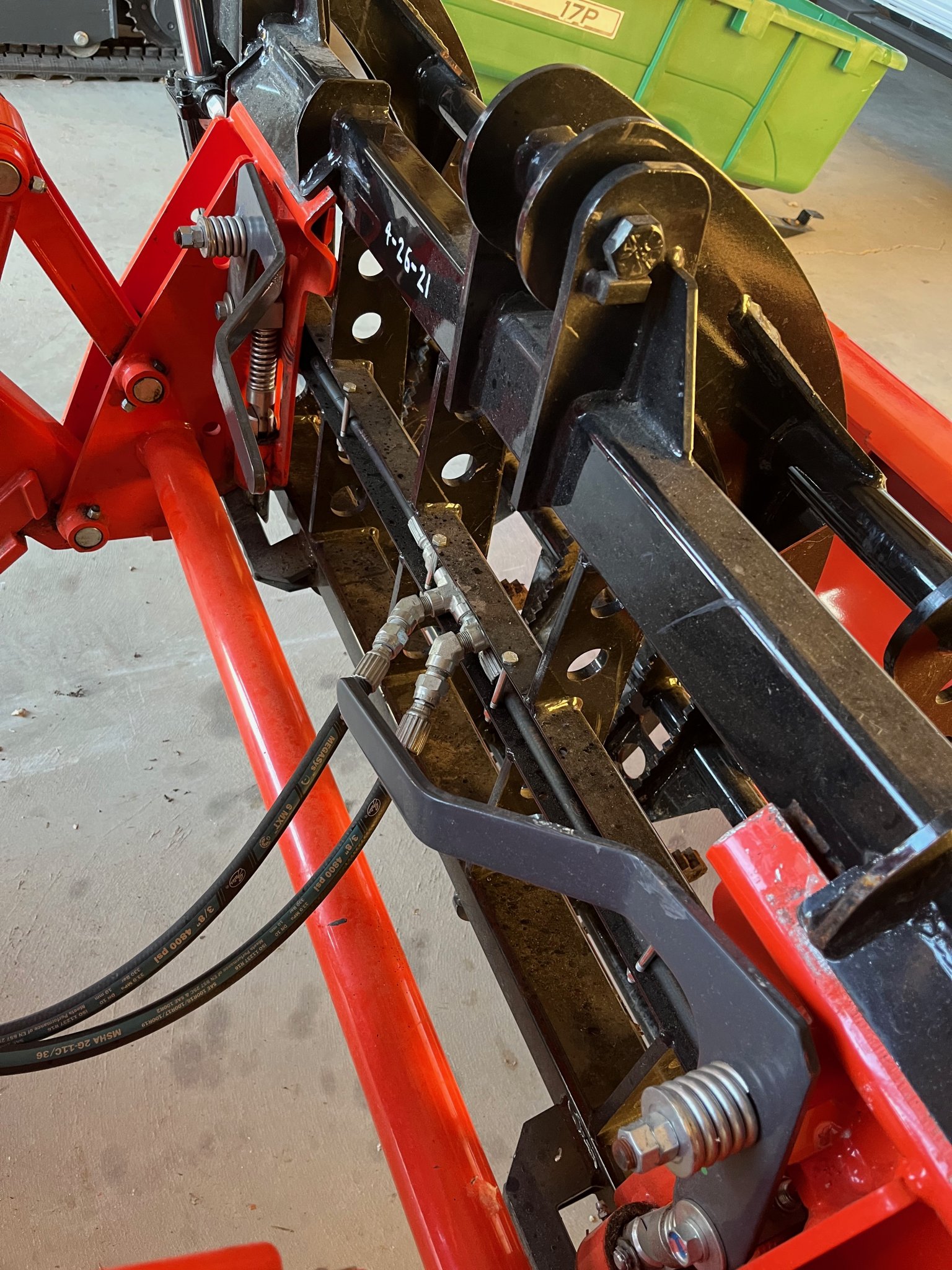

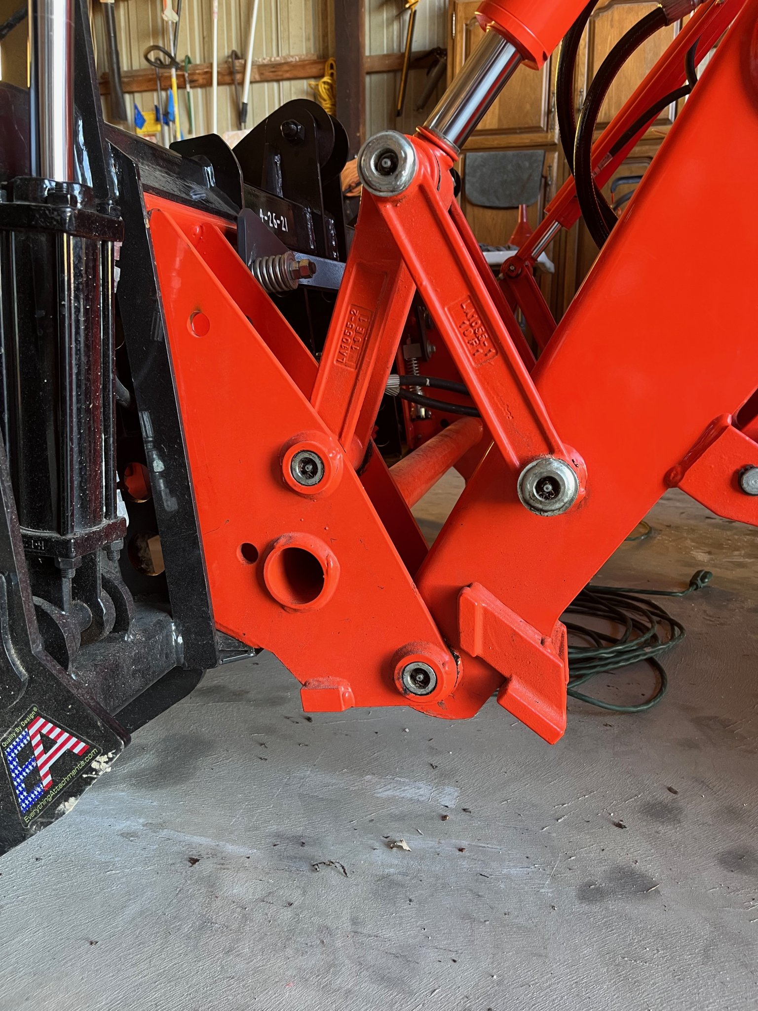

Hopefully I will not ever see a similar situation.
My locks are bussed together, by a hydraulic cylinder, with hydraulic power supplied by a 3rd function diverter.
The diverter/locks can only be activated hydraulically from the operator station.
At 81 it is a wonderfully convenient accessory.
This incident has sparked my interest in such an accessory. My compact track loader had that option and it was great!
