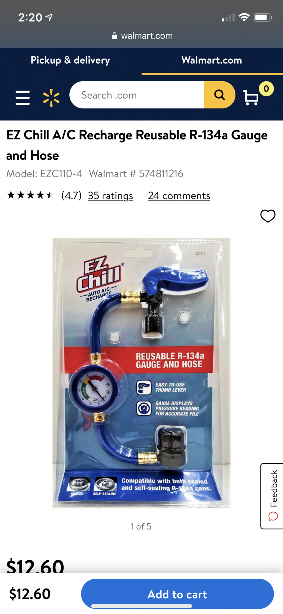

We can walk you through checking the pressure. You can pick up a cheap can tap at Walmart/Atwood’s. It will have a gauge. The new style cans are valved, so they keep well.

DITTO what dvcochran stated.
I know very little about the EZ-chill hose/gauge BUT if one can't monitor both high & low pressures of the AC system you would be better off if that gauge/hose was still in the retailers inventory. It's common practice for the ill informed about AC systems to over-charge with refrigerant lowering AC system ability to cool.
