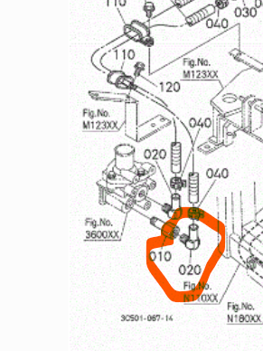

Where would a suitable place for the for the valve go?
Being careful, it you have some welding vice grips you can clamp one hose shut for a test. Conditions and ambient temperature may make this difficult without a good thermometer. In a pinch I have done this with a couple pieces of wood and regular vice grips

Well, I peered under the hood from all angles and I could not locate heater hoses amidst and behind the harnesses of wires and other hoses and fittings that inhabit the underhood world.
2010 M6040 cabbed.

One heater hose should come off from water pump area, usually the thermostat housing which will be attached to the pump. The return can go into the water jacket of the block towards the rear of the engine.

You're welcome. Look at the bottom of top radiator hose for thermostat housing.
