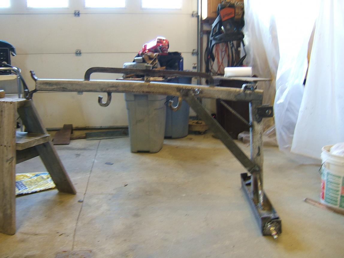

A work in progress. Still a few things to do. :)
Think I have over engineered it for my tractor.

Useful tool !! What say you beef up that gusset ??? That is the only weakness in the picture!:eek::D:) - Hate to see what weights you gonna need on the front end when you go about picking up something......heavY:)

I have wanted a boom pole for quite a while so while I was watching the paint dry I figured I would start on it.
That is part of the work in progress. Haven't decided if I am going to gusset the pole or use two pieces of angle iron from the base to the pole forming a triangle. Either way, it does need additional bracing.

If you can move the corner brace out further it will add greatly to the strength.
My black in in your photo illustrates my suggestion.

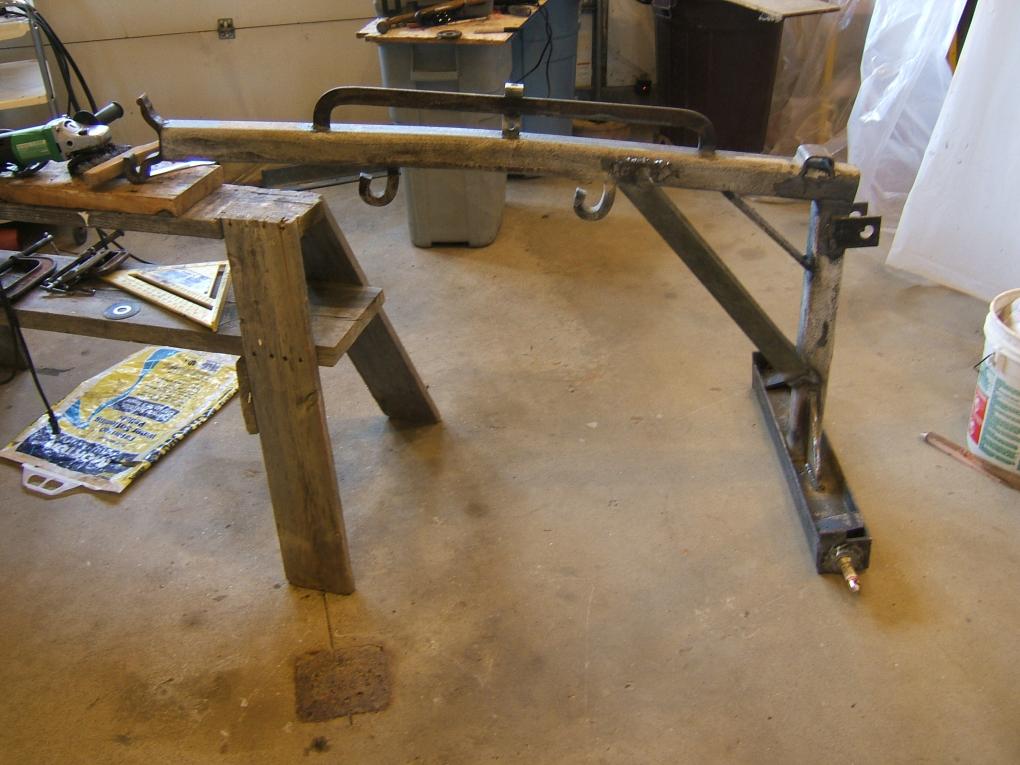

The top is 51" + 4" for front hook = 55"
If you add the 4" for top link attachment tabs = 59"
That looks like belt line rail, and track clips,, hmmm you don't work around a mine some place do you??:confused: It looks like she should take just about any thing your little beasty can lift,, good deal
Nope, no mind around me.:p:D
Pole = 3/16" X 2.5" X 2.5" X 51" re-purposed torsion axle tube.
Upright = 3/16" X 2.5" X 2.5" X 27" re-purposed torsion axle tube.
Lower brace from upright to boom brace = 1/4" X 4" X 4" X 25" angle iron.
Hooks = re-purposed rail clips.
Base = re-purposed 1979 Fisher Plow Conventional Pushbeam.
Bracing from Pushbeam to upright = 1/2" plate.
Hooks = rep-purposed rail clips.
2 large thick washers to reinforce pushbeam where holes were drilled for the draw pins.
1+ lb of welding wire.

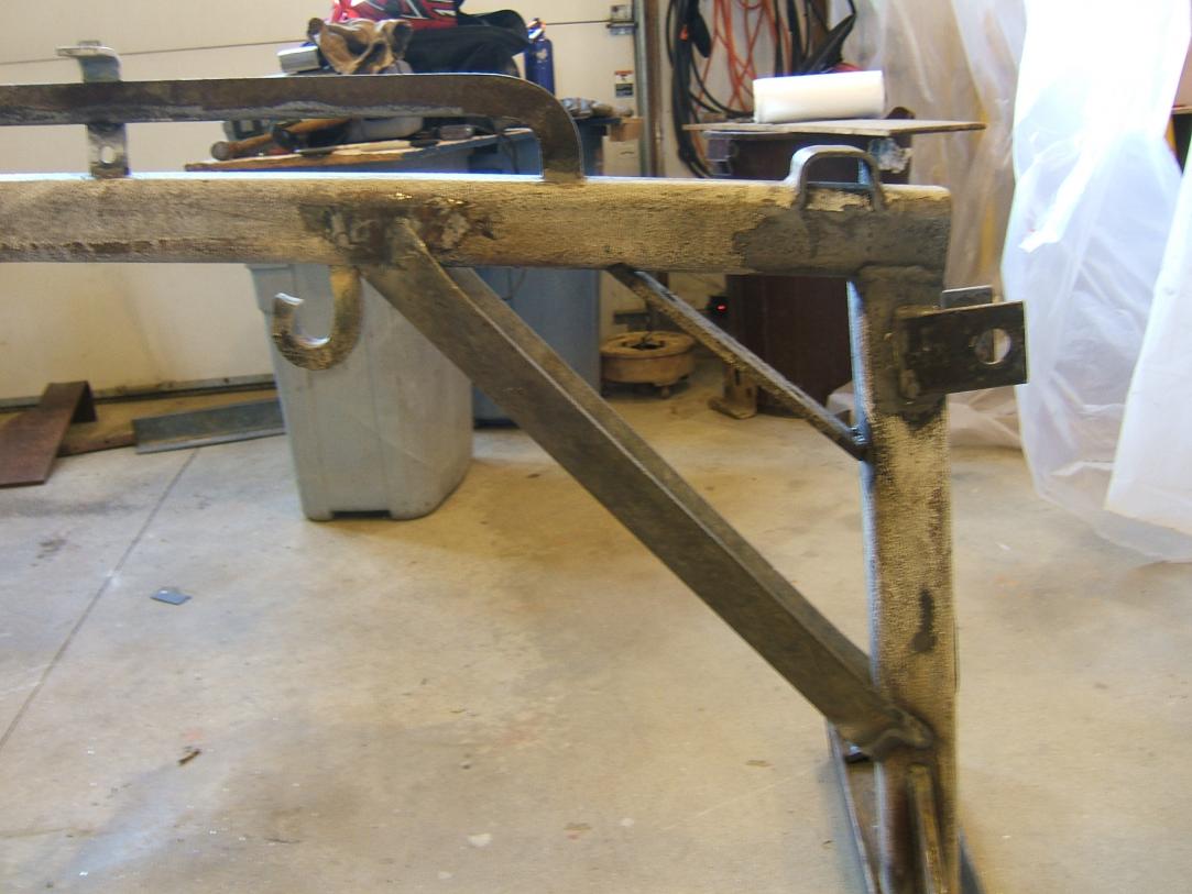

Is this where you are talking about? I ground the upright and recessed the top beam into it. I can easily add a strap if you think it should have one.
Thanks
