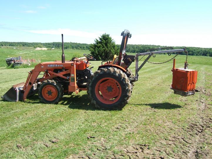

A work in progress (5' Boom Pole)
36,456
11,246
Is this where you are talking about? I ground the upright and recessed the top beam into it. I can easily add a strap if you think it should have one.
Thanks
Yes that is exactly where I was talking about. :D
Can anyone please explain any uses of this implement that would be preferable over a FEL or BH?
This post just schooled me on the existence of said implement, now i am just trying to understand it.
I can certainly see its usefulness for lifting stuff, but does it really only make sense to own one if you DONT have a FEL or BH?
Thanks in advance!

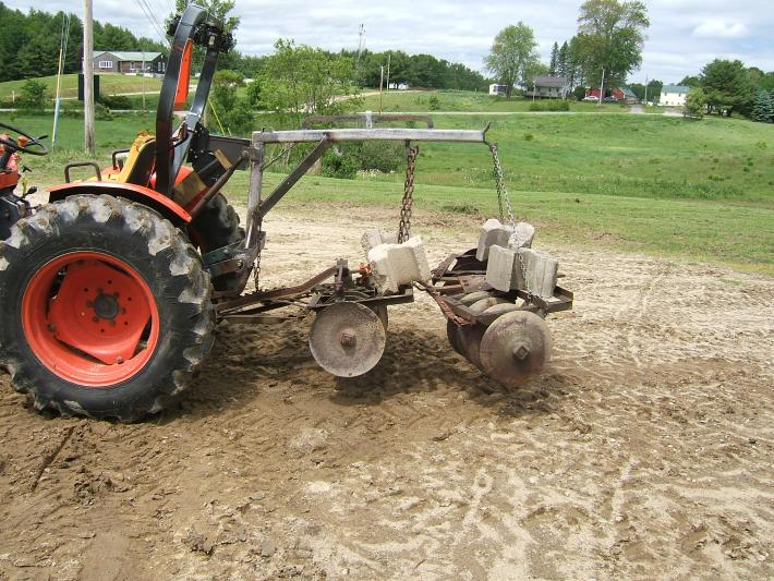

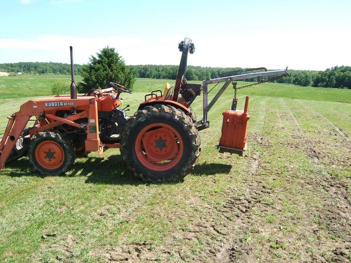

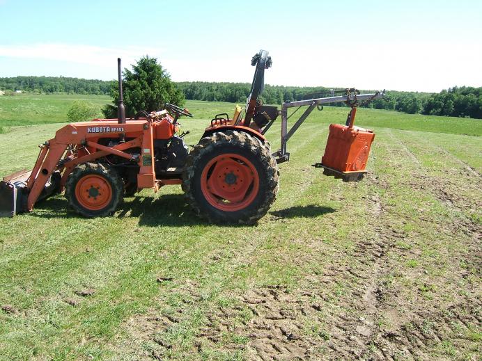

Update:
The boom is working great for my original intended purposes for building it.:cool::D
Sense its completion, I have used it or tried to use it for other purposes. Some have went great :cool: :D others sot so good. :eek: :(
The only problem I have encountered is that I wish I had made it 7' instead of 5'. I could not lift a chevy 350 engine high enough to load it over the side is a pickup bed. If it had been 7' I could have easily done it. I am seriously considering adding a two foot section to the boom with proper reinforcing plates and top brace.
