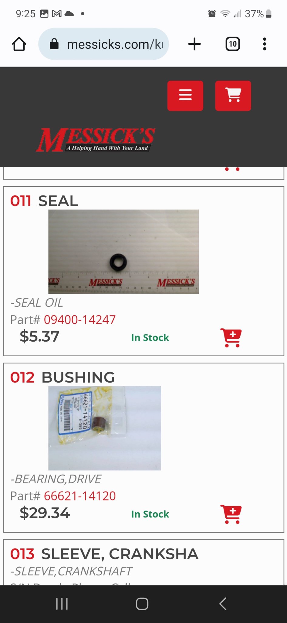

Found the part # for the seal on messicks after a long search its actually under engine: crankshaft etc in the IPL'S here's to hoping my local dealer has one in stock. Otherwise it's a order and wait for one from messicks
6,432
2,060
It will probably be cheaper to get it from your local dealer and have it delivered in their normal weekly delivery schedule so it is free shipping.
I assume you already have the pilot bushing but if not then you should replace it also.
There may be some seals on the throw out bearing carrier also? Again I assume you are already replacing the throw out bearing. The grease zerk you mentioned before does not lubricate the bearing but lubricates the shaft and carrier interface.

Gotcha and yes throwout bearing pressure plate clutch and pilot bushing where all part of the kit. The seal for the pilot bearing was not included. The other seals appeared to be in "good enough" condition for putting humpty dumpy back together but I will inspect further

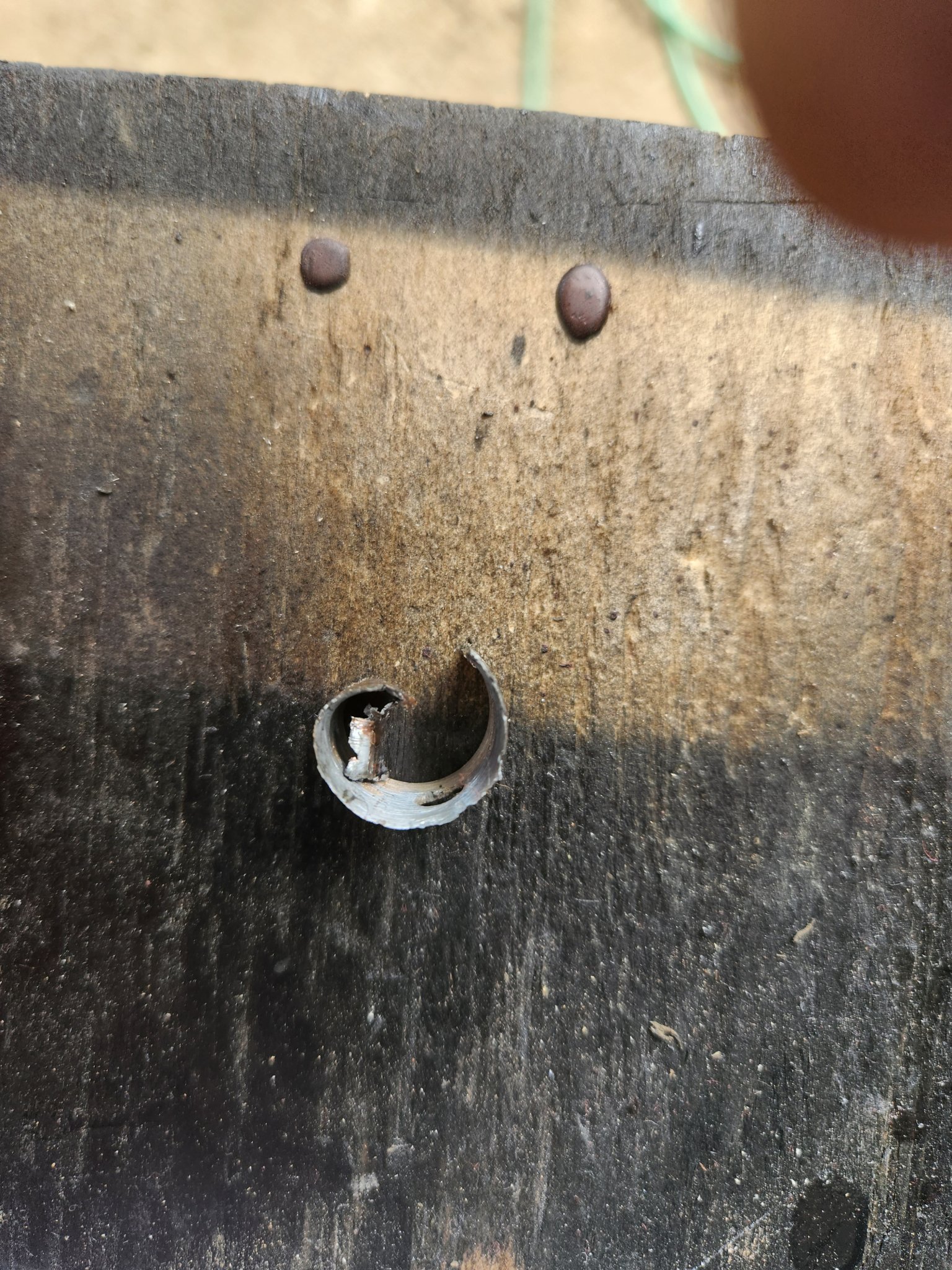

One small victory pilot bushing is out tool didn't help there wasn't enough of a lip left after yesterday's sanding and grinding, before we knew a tool existed but below is a picture of victory

Looks like Humpty Dumpty will have to wait till next weekend for reassembly. My local dealer did not have the seal for the pilot bushing o
In stock and it's a 190 mile 3.5 hour (each way) drive to messicks who does have it so that option is out. Hopefully I will have the seal by the weekend
So lesson learned. and this info is for anyone doing the clutch on a b7100 or similar. The clutch kits do not come with the pilot bushing seal, and it should be ordered ahead of time unless you know your kit comes with. You don't wamt to end up like me waiting on a less then 10$ seal to put the two halves of the tractor back together

I did not price out any of the clutch parts from kubota, but in looking at the IPL'S from messicks the clutch components would have been significantly more through kubota. The only two things I've ordered from kubota are the pilot bushing seal and a clutch pedal return spring. The clutch kit including the clutch disk,throwout bearing, pilot bushing and pressure kit all.came from a ebay seller north Idaho Wolfman reccomended. I should hope fully have results good or bad from the job by late this weekend or early next week.
33,482
8,755
None of the newer models after the B7100's used the seal for the pilot bushing.
And you could have omitted it without any issues.
