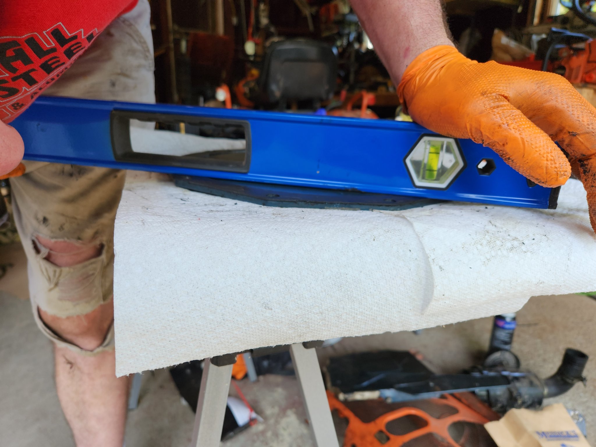

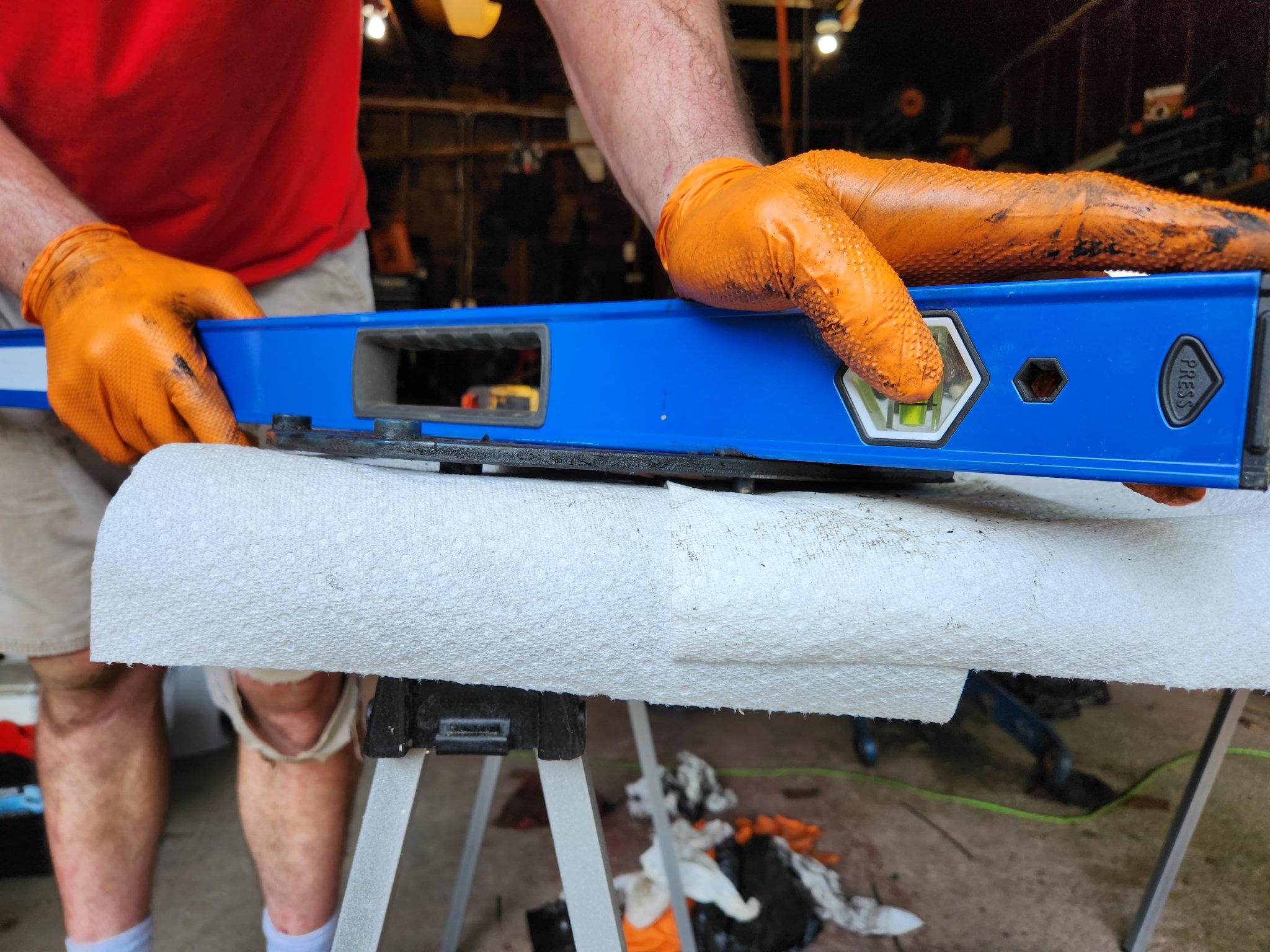

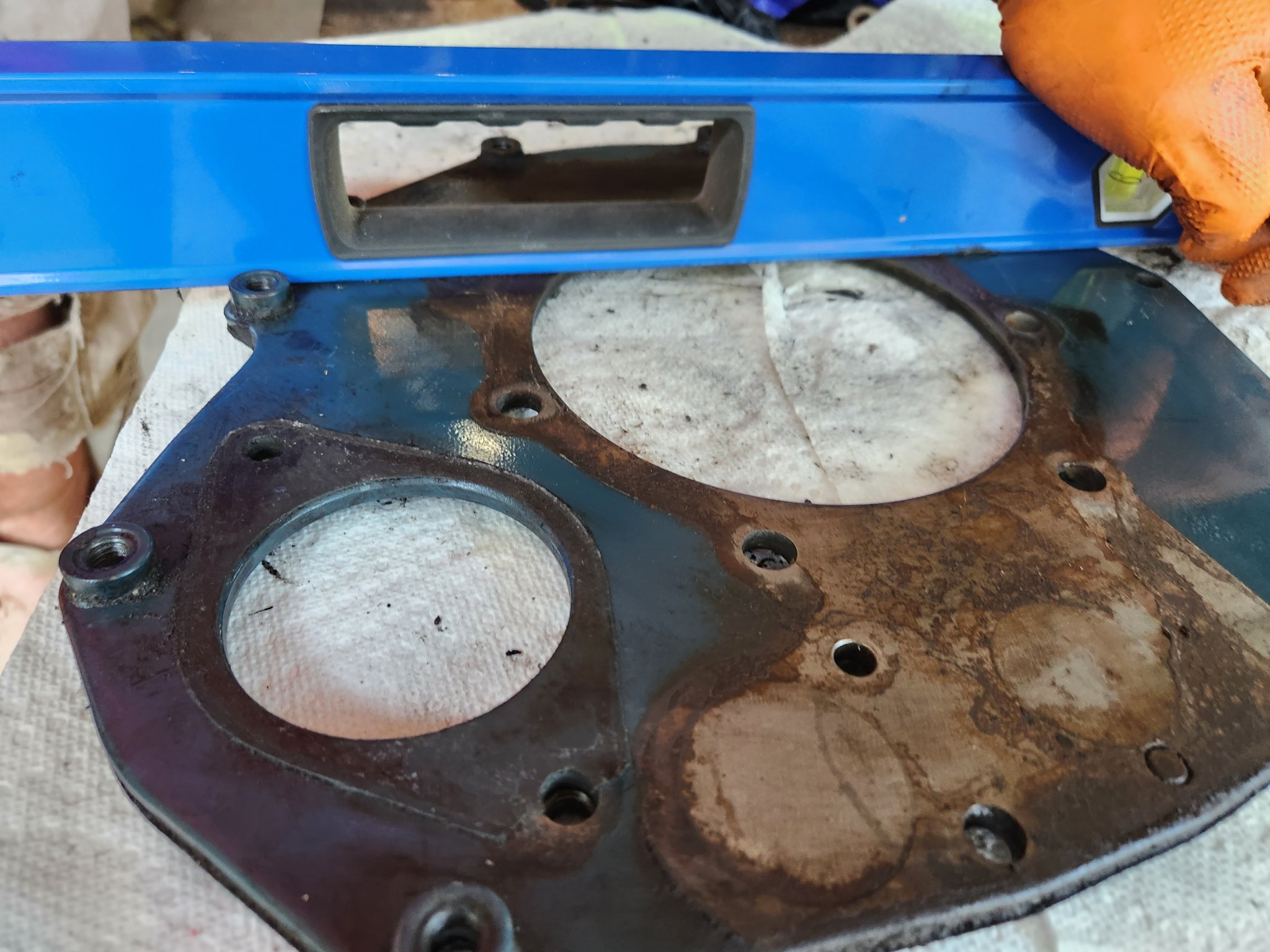

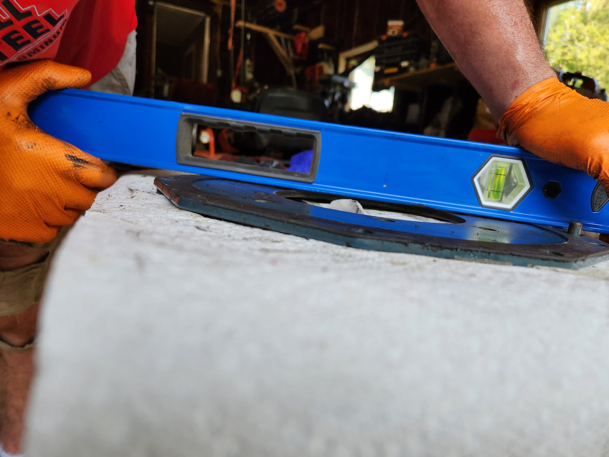

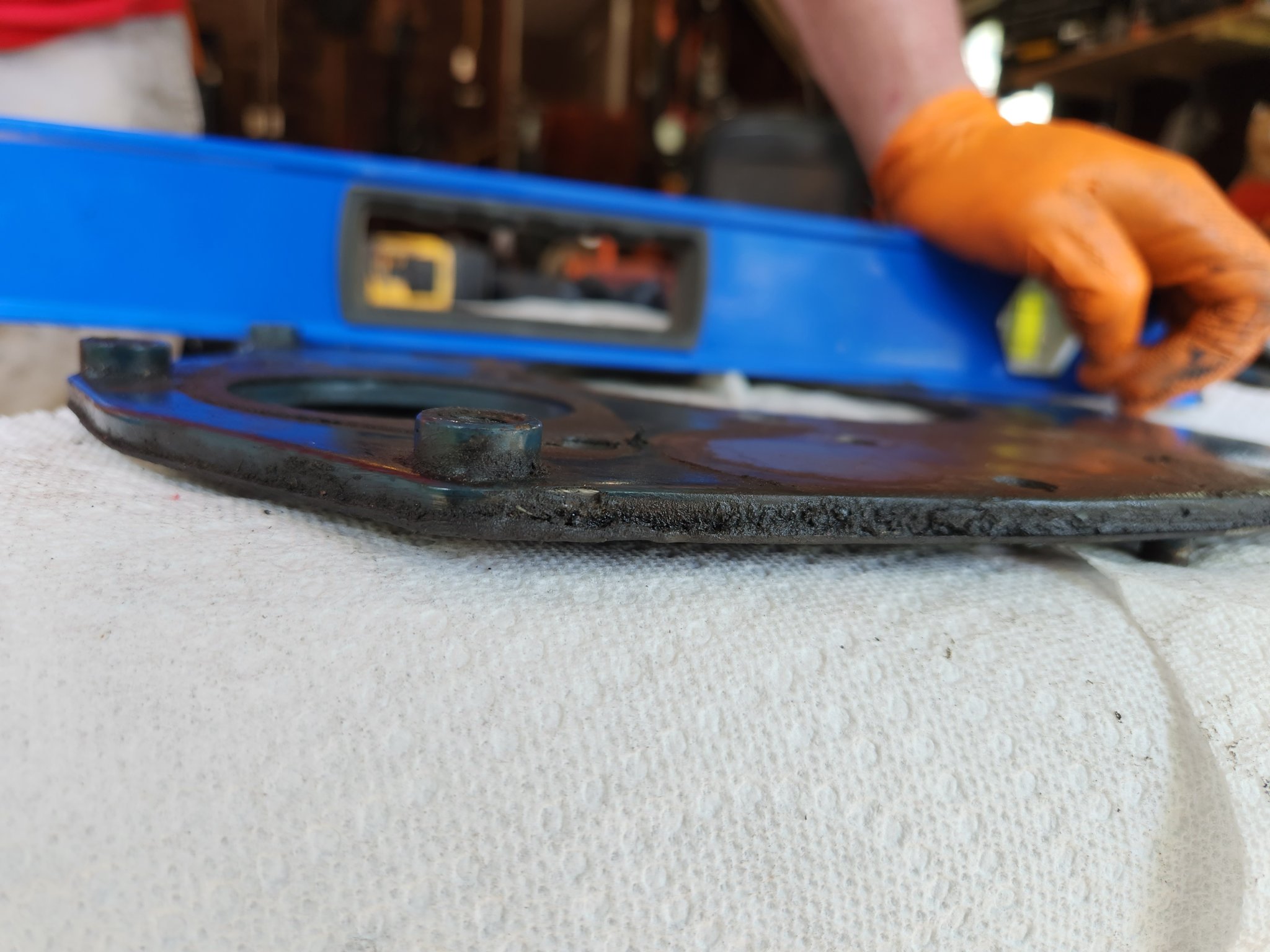

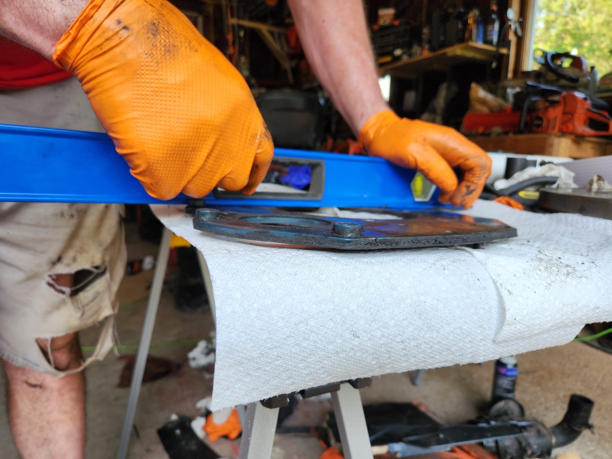

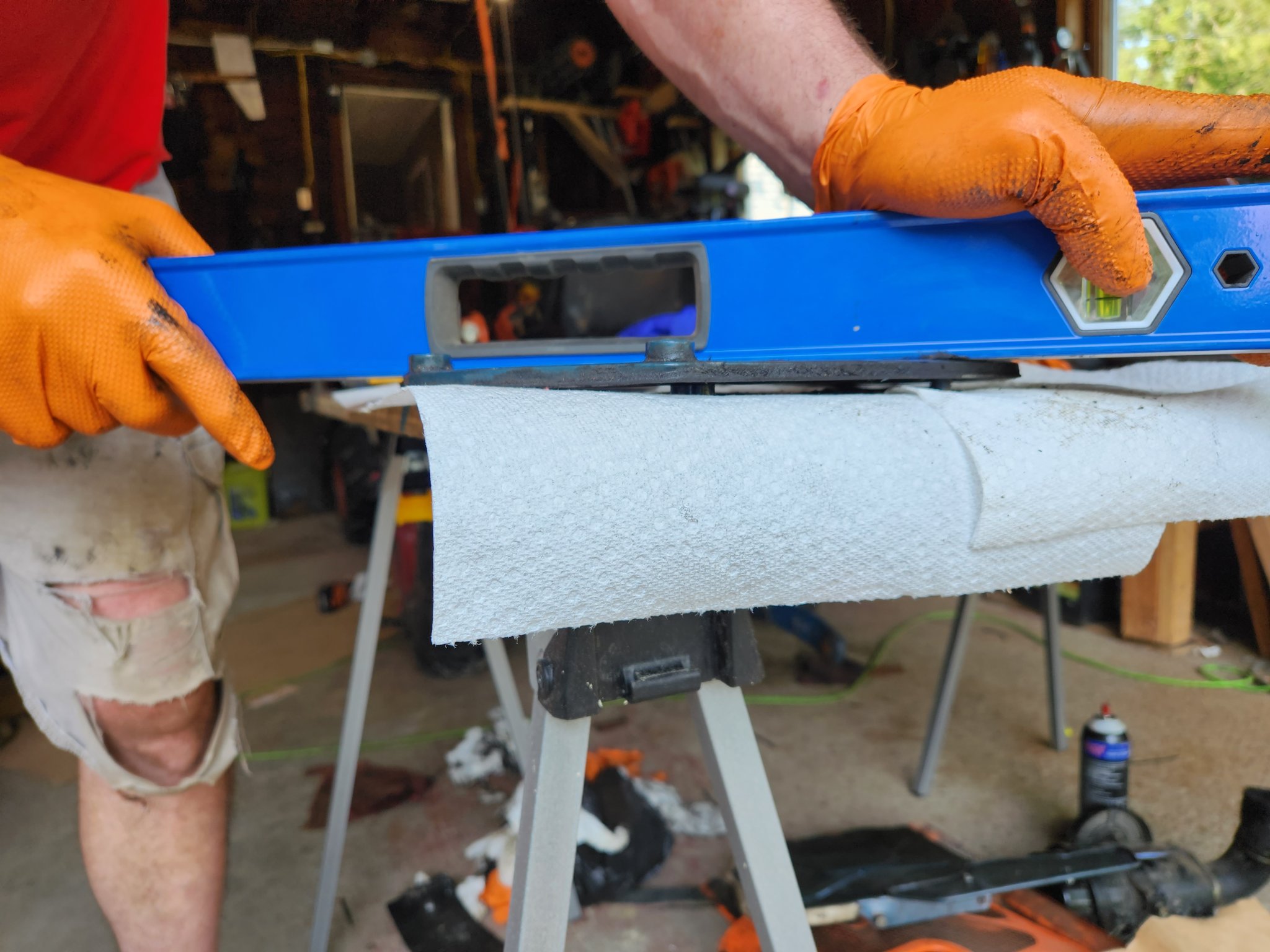

Alr9ght I took the plate off and put it flat on the bench with a straight edge across it. No noticeable warpage the gap in the middle from the gasket seems uniform. I also put the straight edge across the back edge and didn't find any warping i will post pictures below

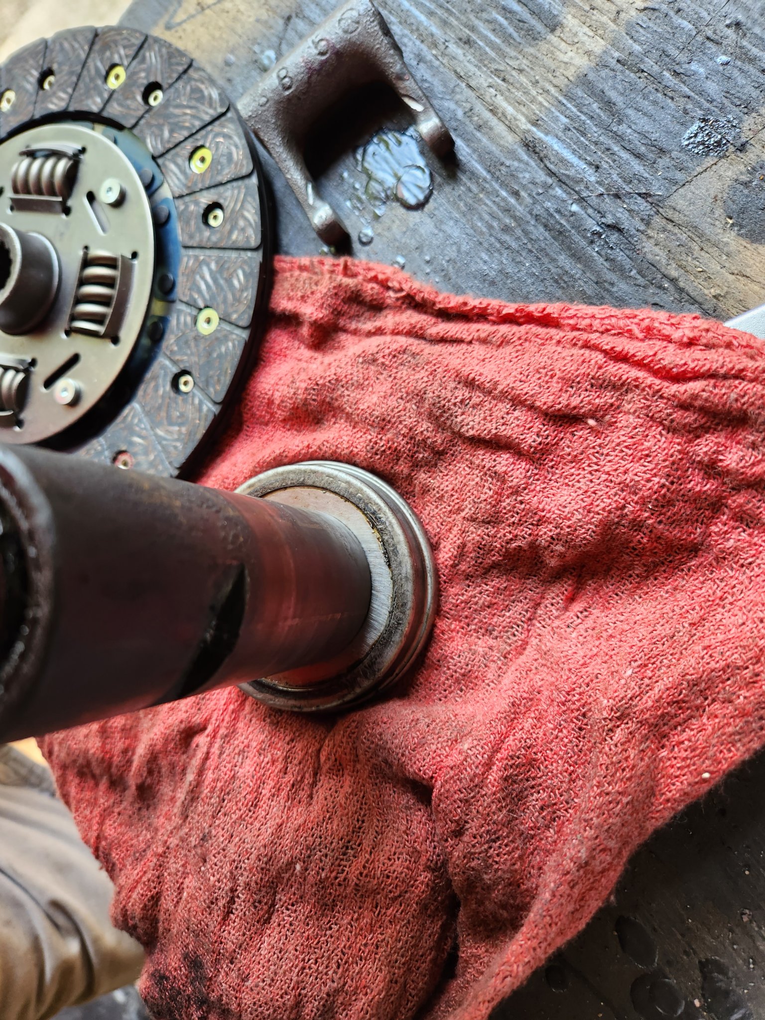

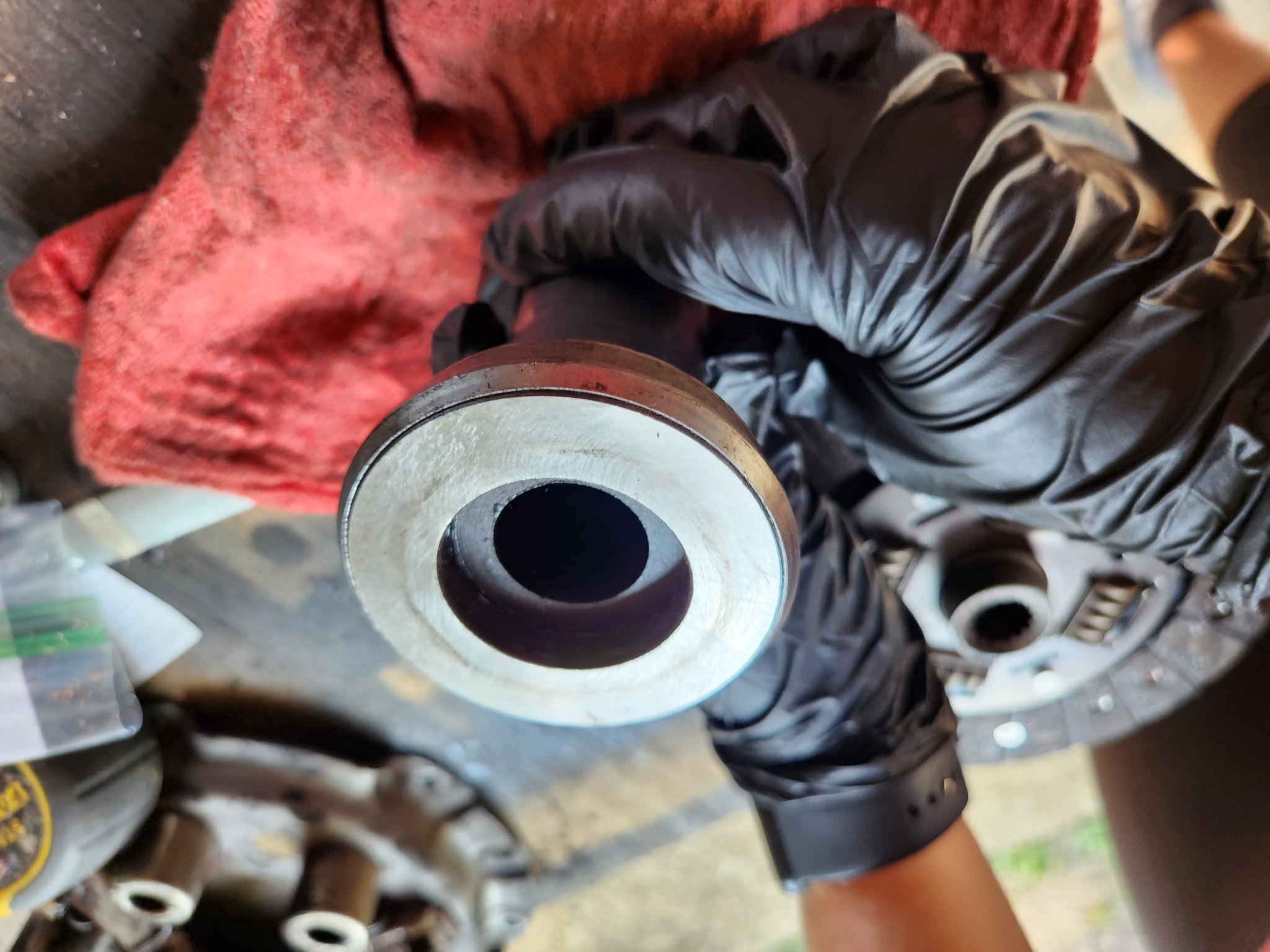

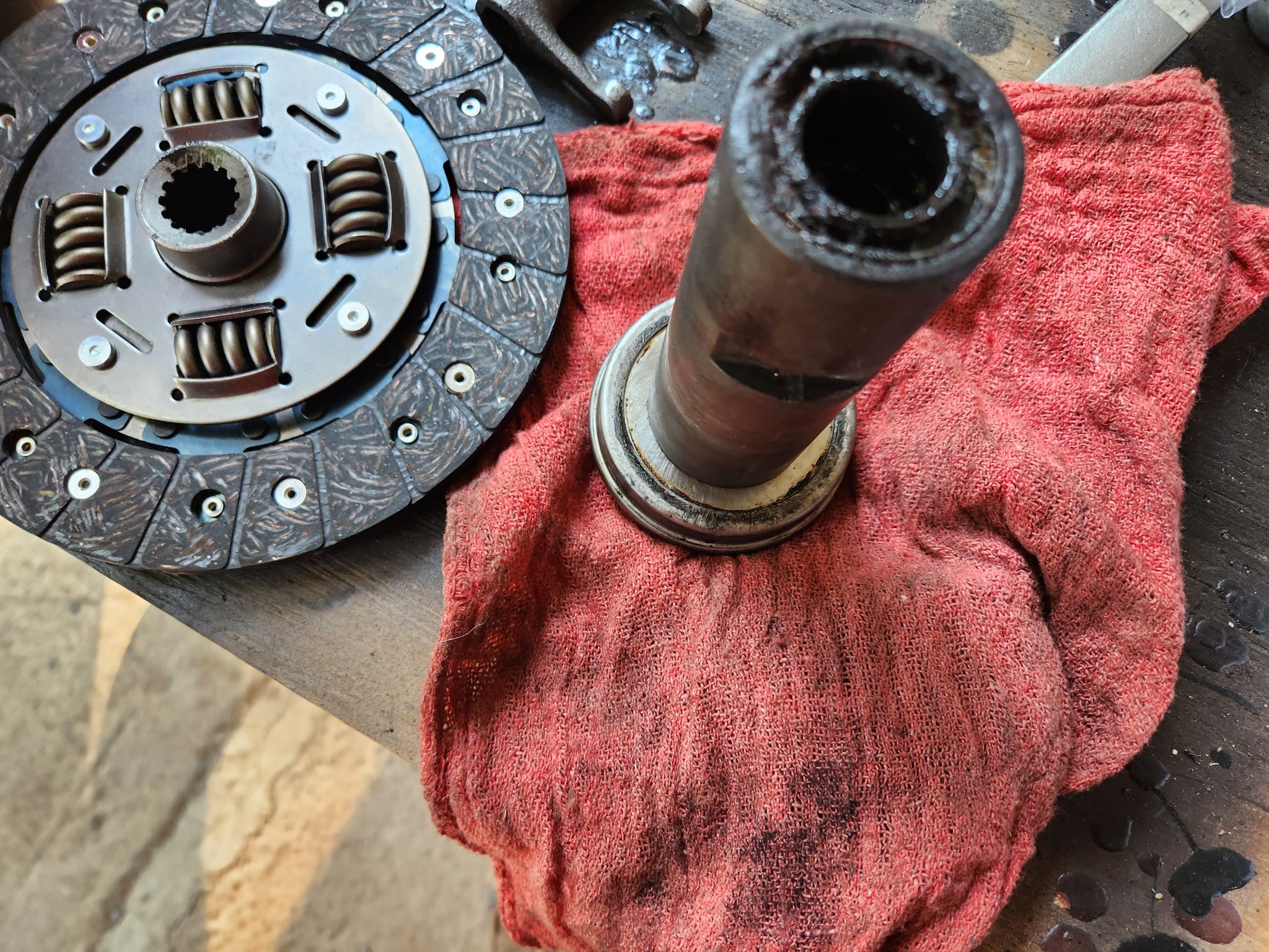

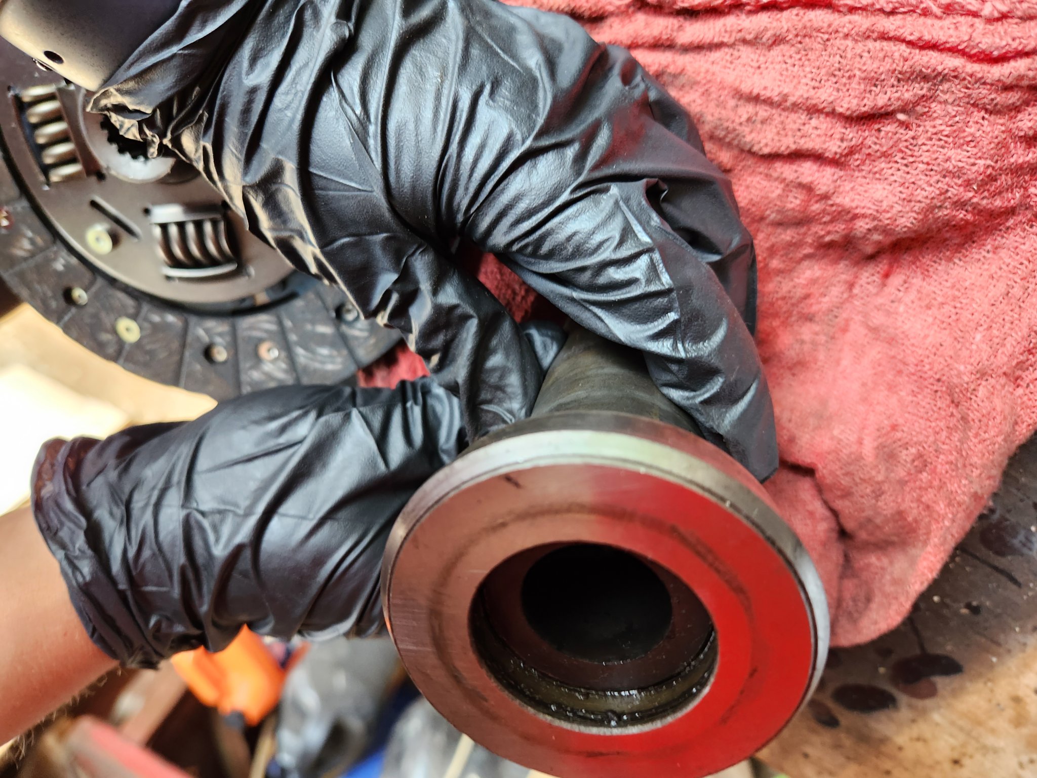

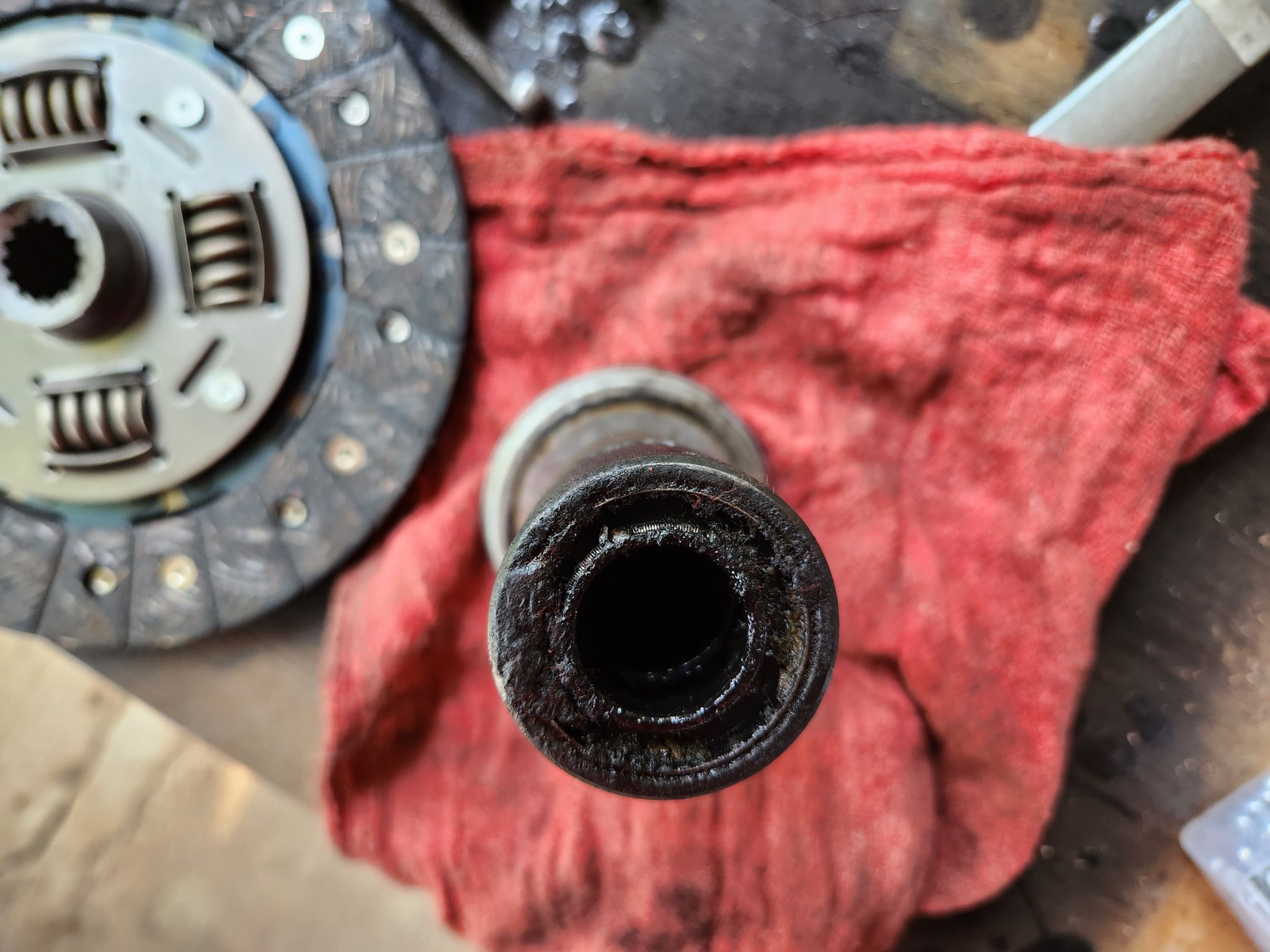

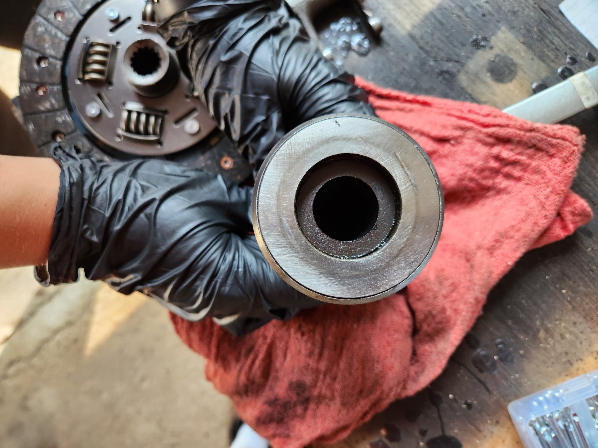

I also took several pictures of the throw out bearing on its sleeve in hopes that I have mounted it backwards (or not)
As for measuring the pressure plate fingers to the flywheel do I do that with or without the clutch in place? and from what place on the pressure plate to where on the flywheel? Having the clutch in place would make measuring to the flywheel with any accuracy nearly impossible unless I'm missing something?
Photo dump: throwout bearing. I will post the engine plate pictures in the next/seperate post

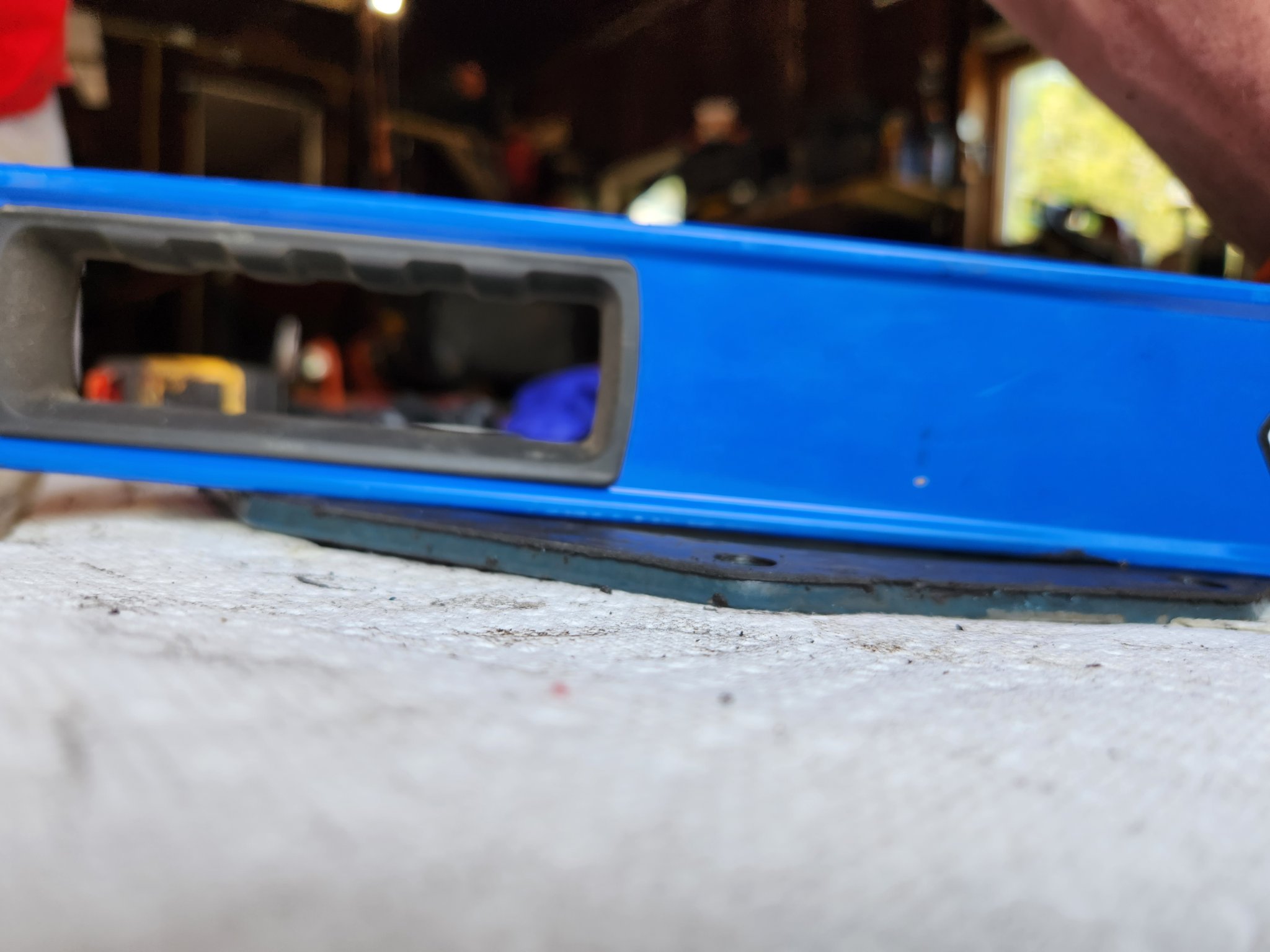

Below are pictures of the engine plate with a straight edge/new 4 foot level across it. The gaps in the middle are from the "gasket" that is still attached to the plate and look uniform IMHO

All of that looks good.
The only other thing I can think of is if the flywheel is the wrong depth that would throw things out, but that's a huge long shot.
Did you download the WSM? specs are in there.

Yeah agree that would be a long shot, nothing has changed with that, unless there is some sort of spacer that goes behind it against the crankshaft but I don't remember anything being back there, I will look at the IPL to verify.
Just to ve clear the throwout bearing is correctly mounted?
Yes it looks right, put your finger on the inner flat face ring, does it spin free of the outer ring and sleeve?

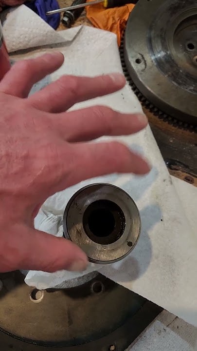

Will look into that on the bearing,
Ok so the part on the sleeve stays stationary. The front, or flywheel facing side spins freely. The rear part or part facing the majority of the sleeve stays still

If you can post a video on you tube with a link here @North Idaho Wolfman will be able to 100% confirm or deny it is correct. I would not trust the words written if you have to split it again.

Throw out bearing a OK.

Let's see if I did this right. Forgive the heavy breathing it is 90 something degrees in the garage 9 o'clock at night and otherwise silent in there besides my loud mouth breathing lol
Video of hand spinning the throw out bearing
