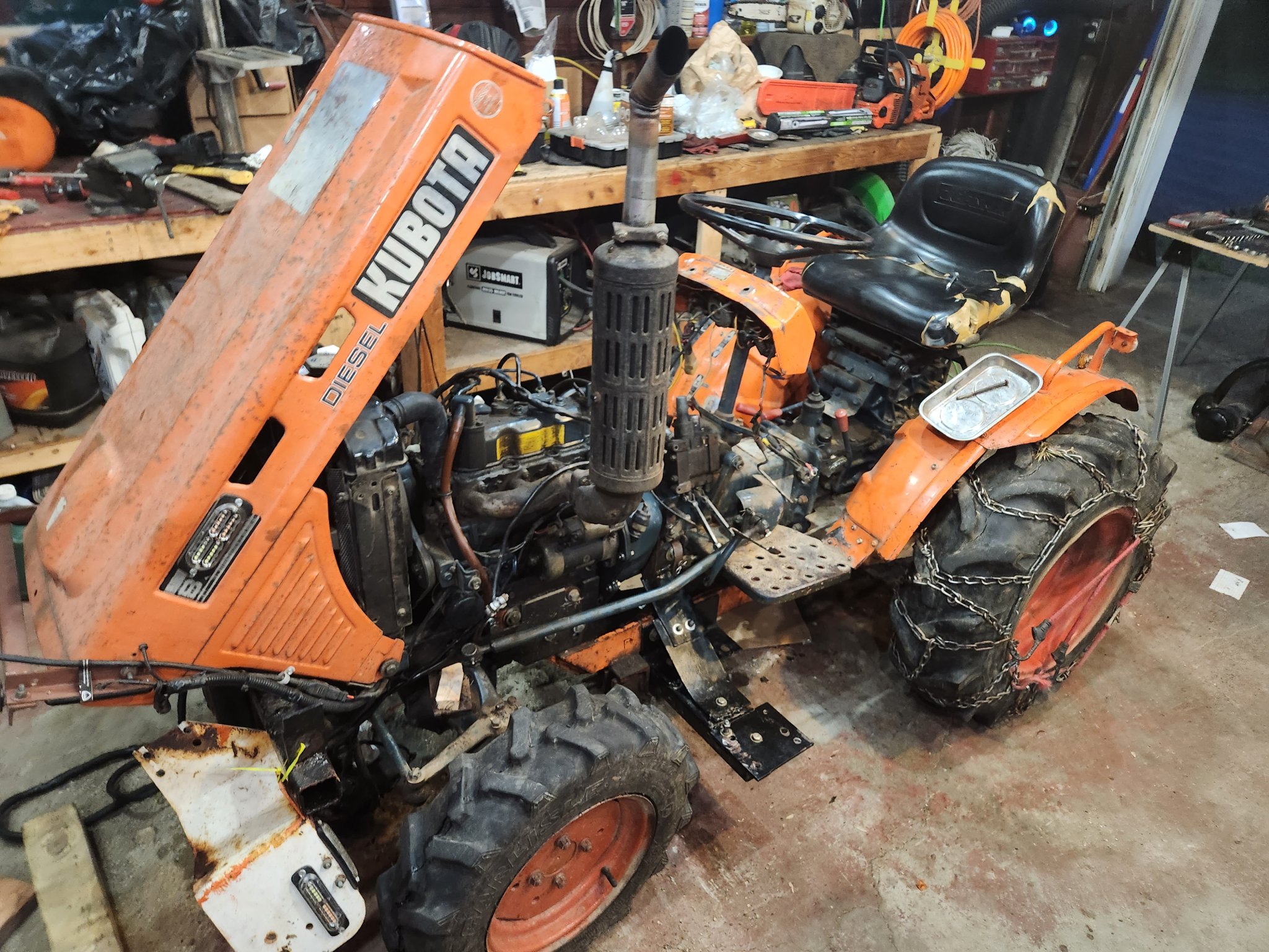

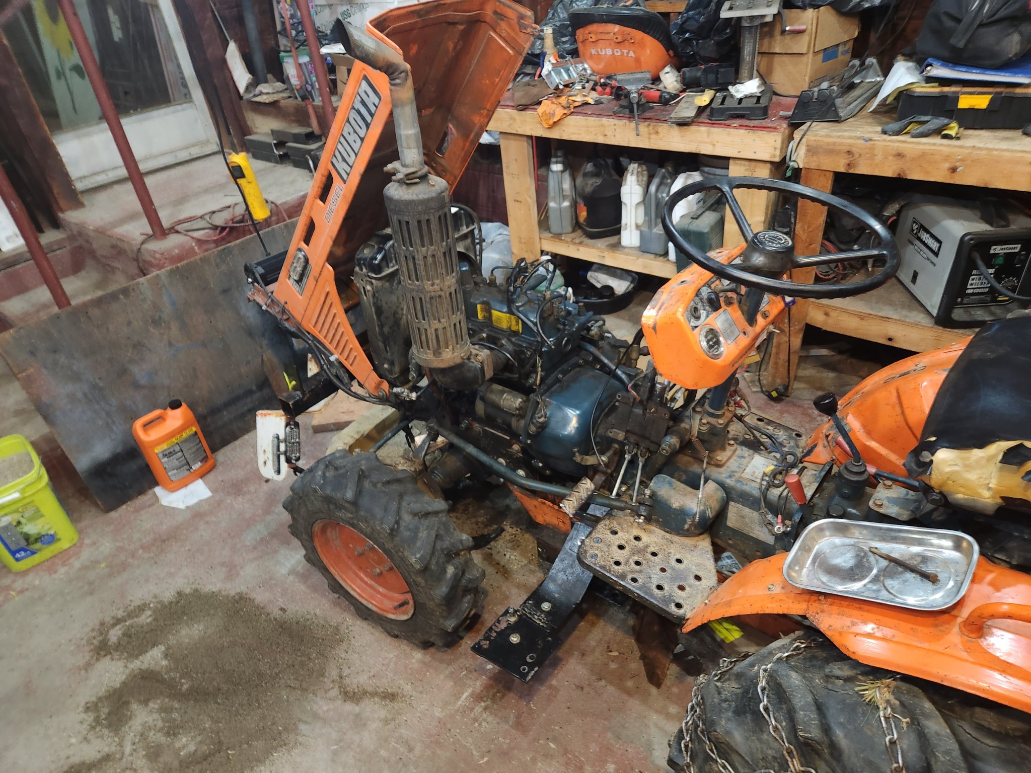

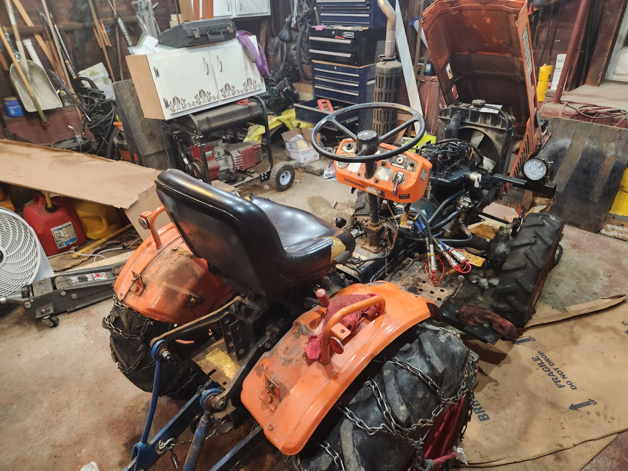

Huge news, it's far from operational, but I no longer have two separate halves of a b7100. Got the new seal installed flywheel back on (that was a challenge becuase although we thought we marked it we did not do a very good job and struggled as the bolts only line up in one pattern) got the clutch kit installed and all of the bellhousong to engine bolts in and snugged down. Also got the rear subframe bolts back into the rear axle housing and torqued down. Still have to go back around the bellhousong bolts and check torque but that's minor. The rest is relatively easy stuff just putting everything back in its place and giving it a test fire and run before everything "not crucial" goes back on
The re-marrying of the two halves although slow went very easily it practically fell together. Driveshatlft didn't even put up a fight as we didn't remove it and I was a little concerned about that going back into the front splines.

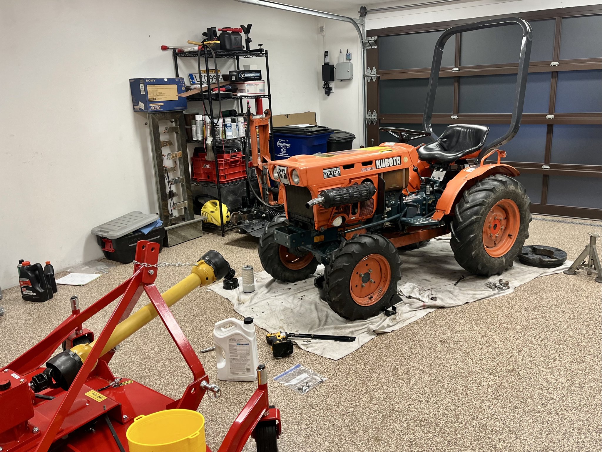

That's awesome! I've finally started on all of the maintenance on mine: oil & filter, fuel filter, coolant flush, radiator hoses, cap & clamps, front axle fluid (80w90), transmission fluid (UDT), air filter, and removing the plow, subframe & rear wheel weights.

That is one very clean tractor, I'm a little jealous. I would love to have a set if rear wheel weights, what are your plans for the plow and plow frame? They are rare and the frame is a good platform for building a FEL (ask me how I know lol)
Also the front axle gear oil changes are a pain getting fluid back in, so if you find or know any secrets of how to get the fluid back in without making a giant mess let me know.
The tractor only has around 960 hours and had two owners before me (I think).
As much as I want to hold on to the plow, subframe, and Kubota wheel weights, I intend to sell the pieces. The tractor will only be used with a rear mower (I recently purchased three original Kubota suitcase weights), and I intend to fill the rear tires once I've replaced them.

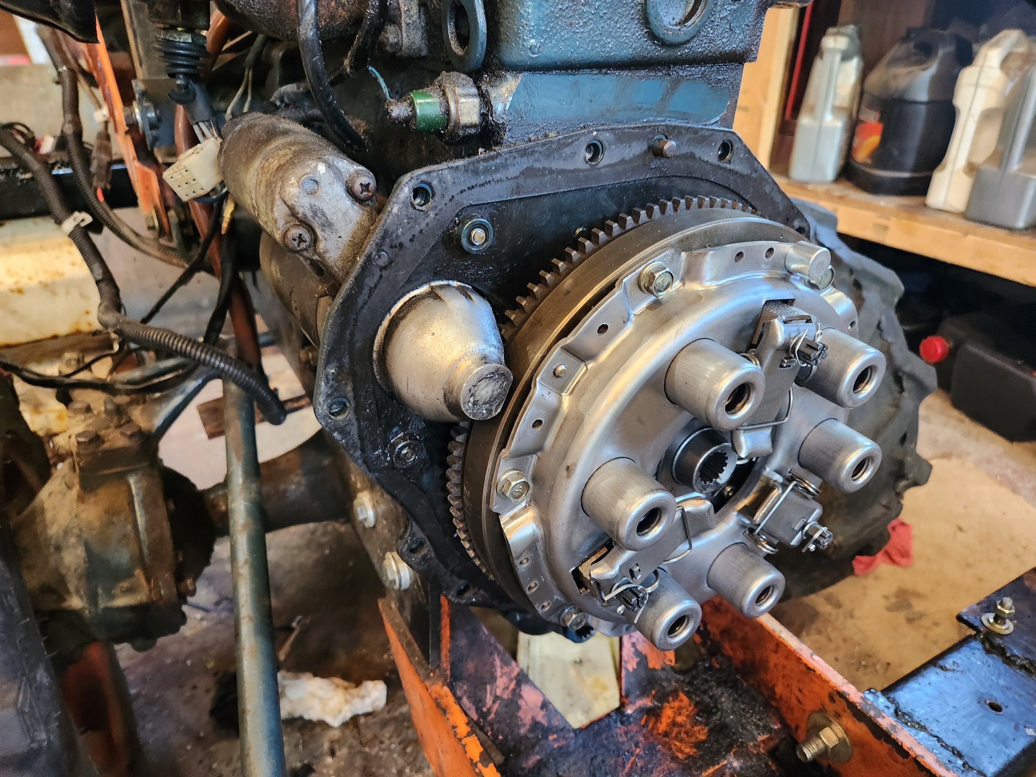

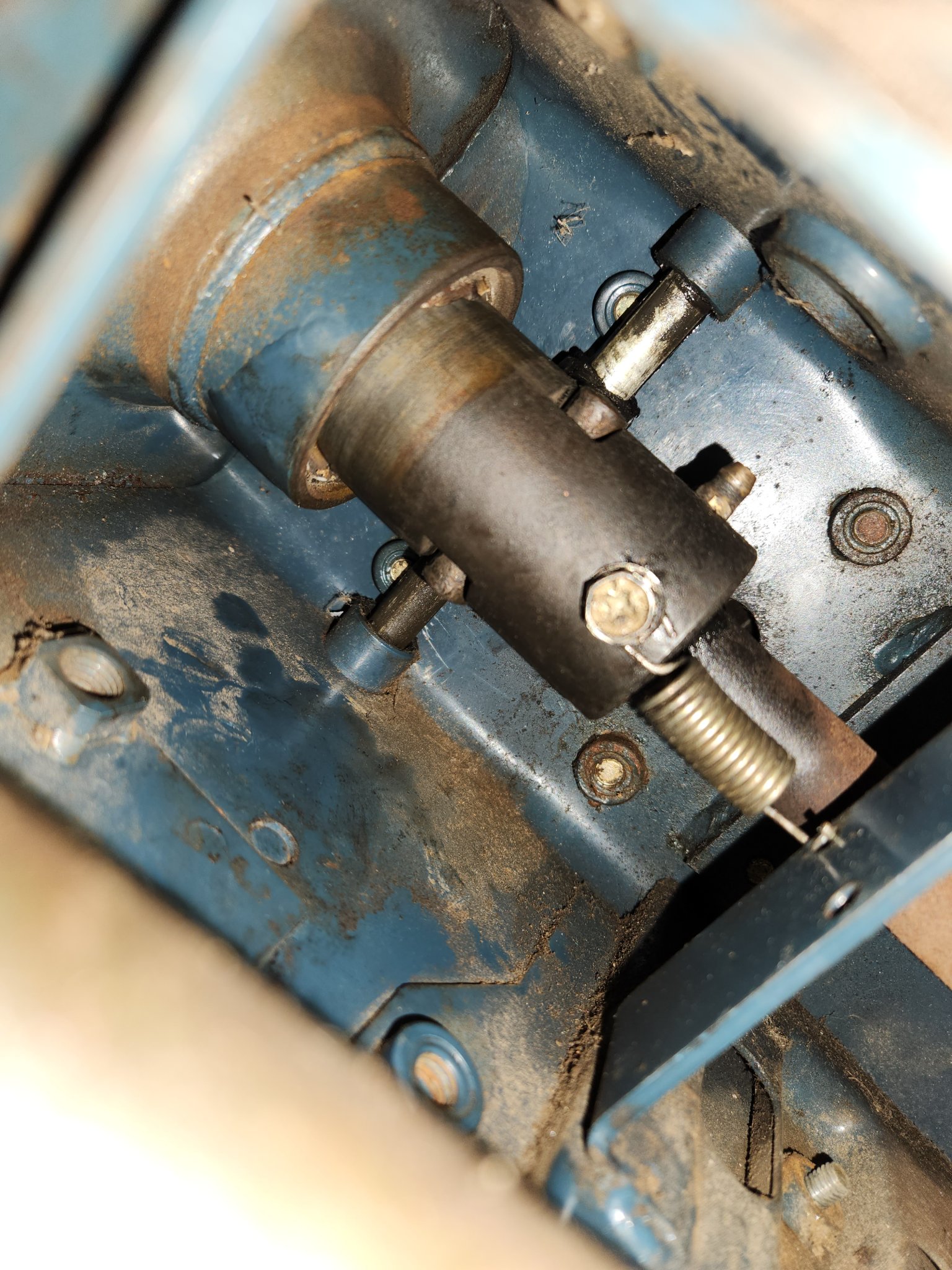

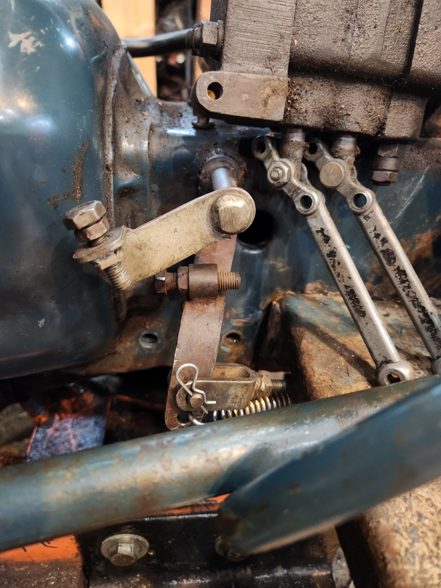

Ok here's where I am at and I hope it makes sense. We took it all apart this afternoon reassembled with the clutch fork (throwout bearing fork) reversed to what I believe is correct, did not snap any pictures with it apart and should have so I apoliflgoze for that. I seem to have a clutch that dissengages now, in that we can put the tractor. In gear (not running didn't do any extra work) to confirm clutch function) push the clutch pedal all the way and the clutch disengages and the tractor will roll. The pedal still has way more travel then it should, but I believe that is another issue as follows. I believe the bracket on the shaft that slips through the fork has been bent and tweaked over the years causing the pedal to have to travel extremely far to disengage. My solution to this rather then take everything apart and order a new shaft/bracket will be to fabricobble something to move both the adjustment turnbuckle fork and return spring back to regain some travel in the adjustment and get the clutch pedal to something near normal. I know this is not a "kosher" fix and is barely even a farm fix but I'm at a loss as to what else to do. The throwut bearing definately has more "throw" with the throwout/clutch fork turned around and now dissengages the clutch which I did not have yesterday.

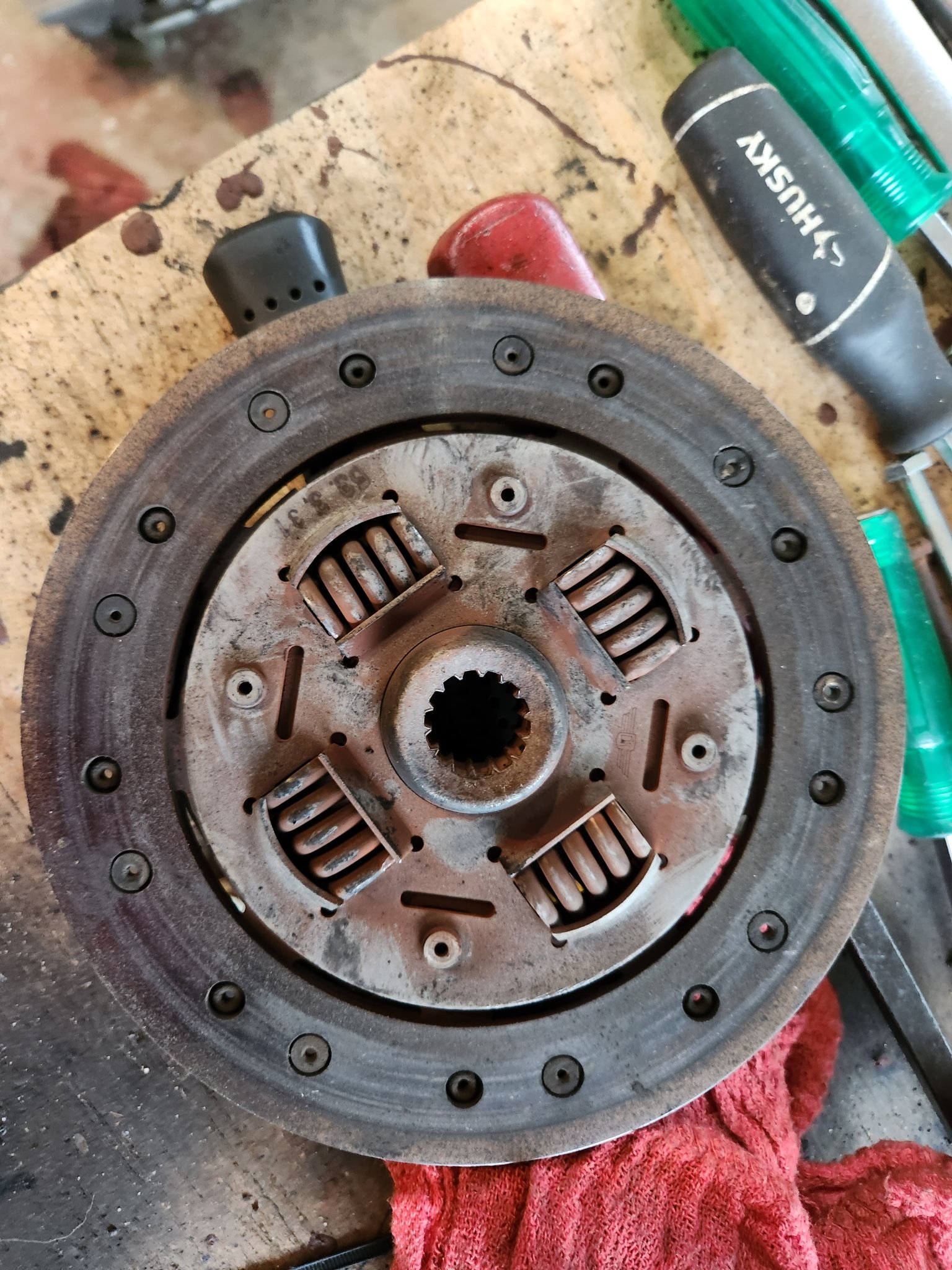

The old clutch was worn almost to the rivets so it was definately "shot".
Note: we did not completely remove the plow/loader subframe from the tractor to do the split we just removed the 3 bolts from each side of the rear axle and slid it forawd still attached to the engine end of things. We also did not remove the driveshaft we simply slid it out of the front collar/universal joint and left it attached with the drift pin to the rear universal joint. That left it dangling and in the way in the access hole where the throw out bearing sleeve slides over the output shaft that is what made it difficult to reach my hand in there to slide the fork on and remove the bolt and small spring.

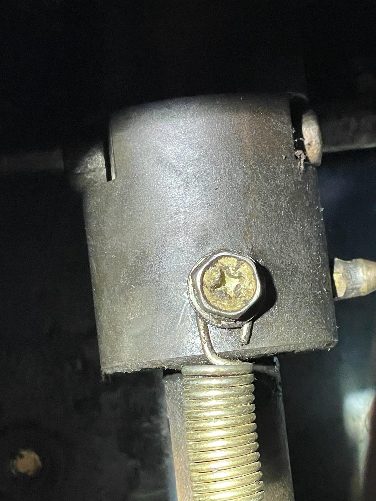

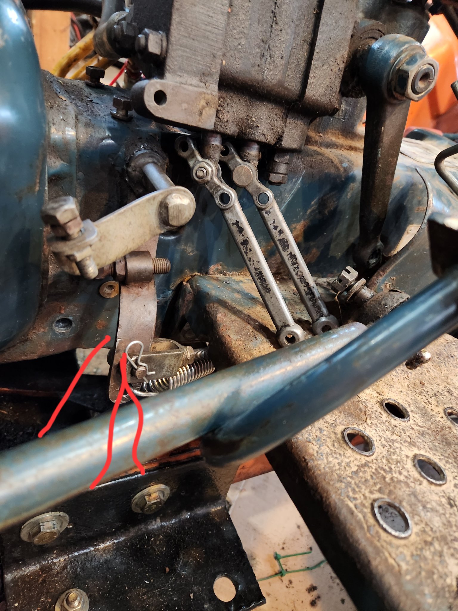

Below are some pictures of the throwout bearing fork the shaft/bracket that the clutch pedal attaches to and the old clutch. I've put a red arrow on one of the pictures indicating the part which I think is distorted causing the Long oedal throw. My plan is to make a peice of steel bolted into the two original holes (one for the spring and one for the turnbuckle) to move that turnbuckle and spring back so I regain some adjustment and hopefully don't have as fat of a throw in the clutch oedaln

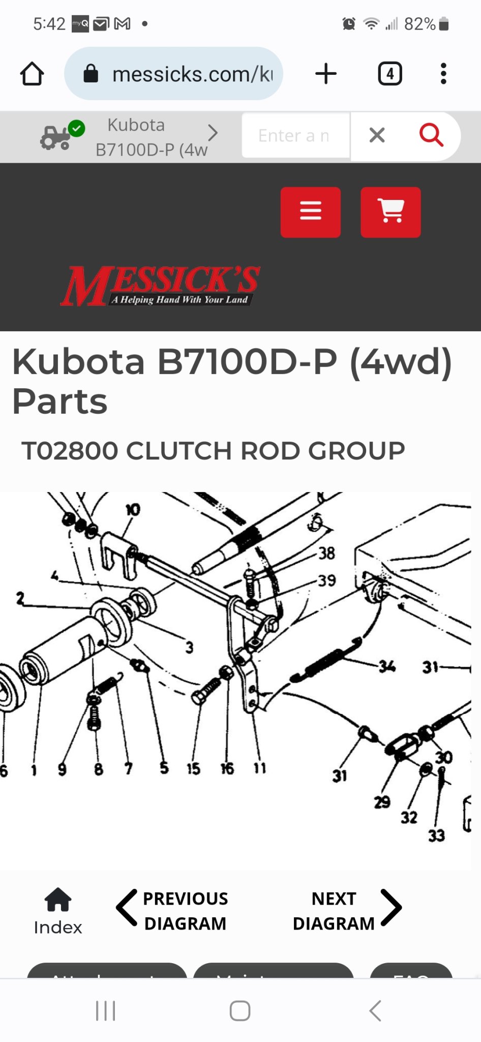

Edit: I added the IPL with the clutch rod, (# 11) forgot to add that screenshot earlier
Got the whole thing split again, the fork turned around inspected the motor plate, and back together (not anywhere near running) in two hours after work, I'm getting too good at this. Anyway with the clutch fork switched it makes no difference on oedal travel to dissengage the clutch its almost identical to yesterday if not identical.
The picture I took of the fork flipped today is terrible so you will have to take my word for it

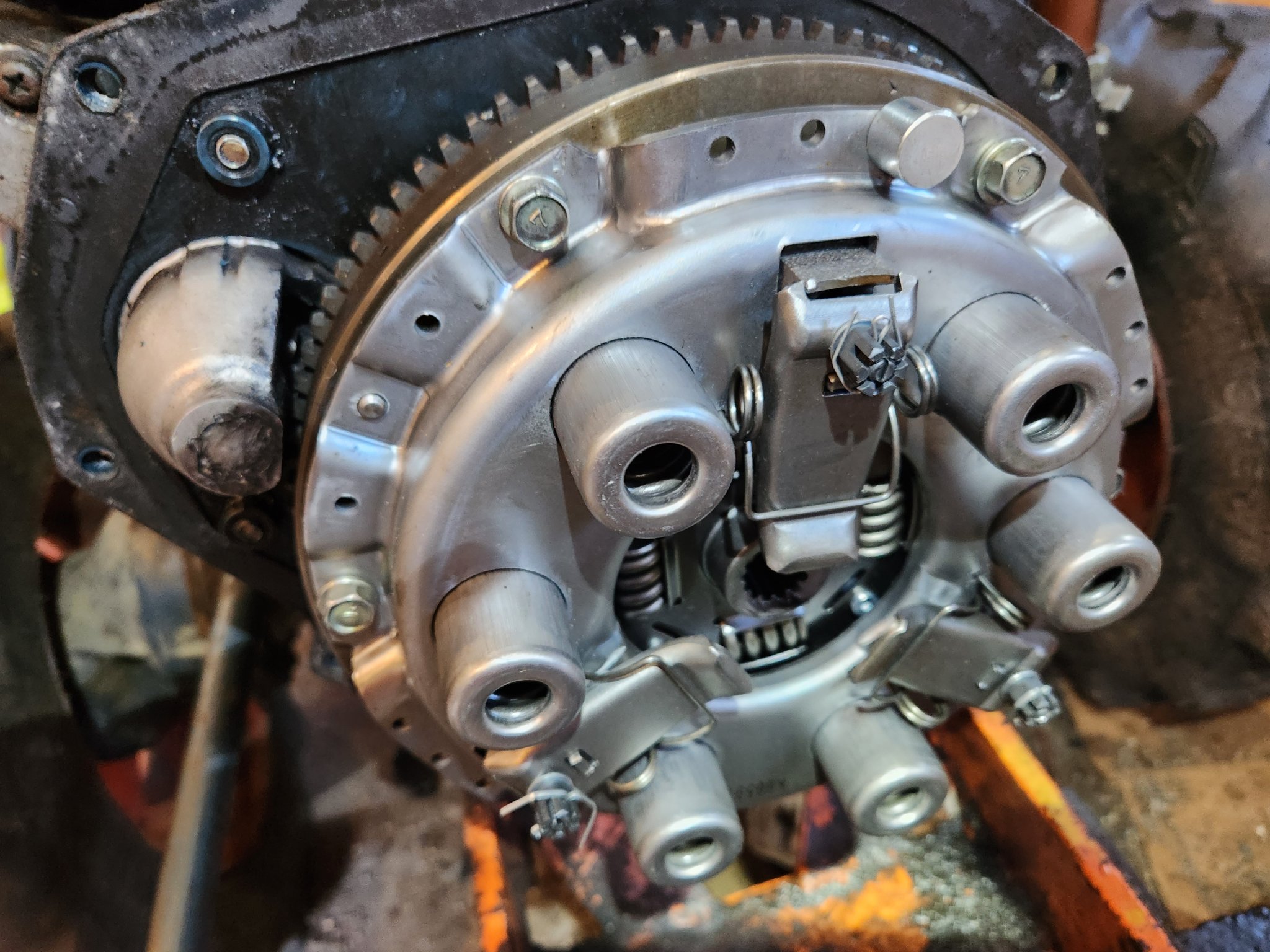

I'll also include some pictures of the clutch area, and I don't think any motor plate is bent or distorted correct me of I'm wrong but I just don't see it
I an still pretty convinced the "clutch rod" # 11 on the parts diagram I've attached is distorted/twisted the parts diagram shows a fairly straight plane coming from the shaft that goes through the fork down to the clutch pedal and return spring attachment points, yes there is a jog but I can't imagine it looks like mine. Mine is twisted and although I'm not positive I think this is exaggerating my pedal throw.

is there some adjustment on the pressure plate that should be done before you go back together?
Can you find a picture of a new ”clutch rod” to compare to yours?
I really don't know if the pressure plate fingers have any adjustment, but from what I've read they come pre set.
As for the clutch rod the only picture I can find is in the IPL I will put up in the last post (I forgot)
