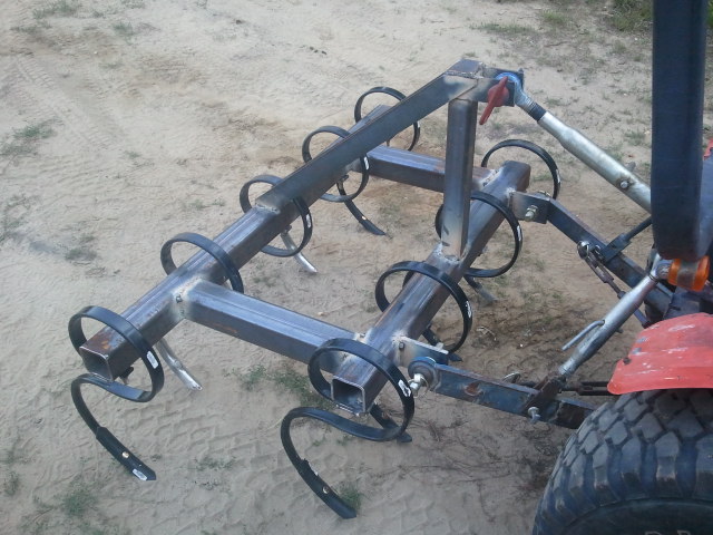

I have a landscape rake, and like your thinking they don't do wery well at pulling roots or stumps out of the ground, they do very well at gathering up the little stuff.
I too would recommend a spring tooth cultivator, I made mine for really cheap and it does a great job at ripping everything out of the ground.

Thanks for the input. I like the idea of the cultivator.
Wolfman where did you get the teeth from? For the price of the rake at the dealer I am not opposed to building something myself.
I'll give craigslist a try for a ready made one also.
34,441
9,689
I bought them at a the local farm store. :D
