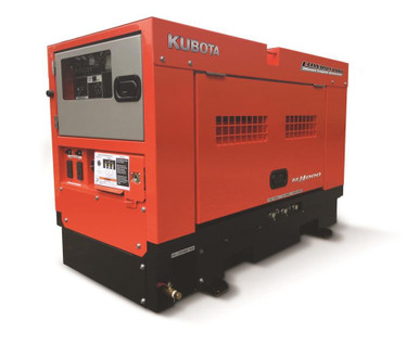

What are your opinions on propane vs diesel for home backup generators? We have a 500 gallon propane tank and could upgrade to 1000 gallons. Looking for ~14 kW. Seems that diesel engines use less (volume) of fuel and would be cheaper to operate. Not sure about the long term prospects for propane or diesel.
Kubota makes a generator in the power range I am looking for.
Thanks in advance for your advice.

3 or 4 years ago I was considering a propane standby generator, because often I was out of town when we had a power outage, it as always a challenge getting the gas unit started by someone othe than myself.
I considered the propane stand by system which probably would have been just fine, but, I like the the reliability and longevity of the diesels, the stand by units I considered around 14k had a air cooled briggs and straton motors or something similar.
Having a diesel truck and tractor I keep fuel around so I went with the Kubota GL11000 and it works great, maybe a little overkill because I will never use it enough to wear it out.
Kubota direct has some good deals on the generators.
