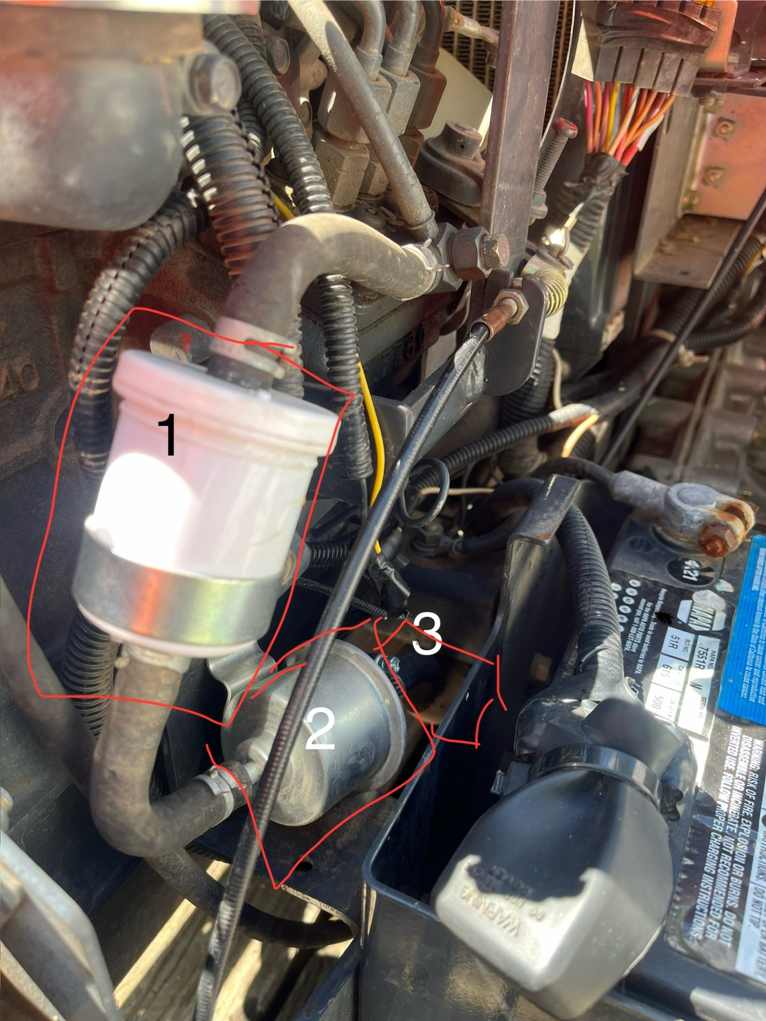

I recently inherited a ZD21 (unsure of the year, about 550 hours) from a business partner who passed away last week. He had it running, drove it onto a trailer, drove the trailer to our house and then it would only crank and wouldn't start. Im new to diesels, i jumpered the seat saftey to rule that out, and tried bleeding the fuel system at the pump and the injectors. Still no start. Any help would be appreciated.

One thing to know is that the mower has 2 inline fuel filters. One is visable and the other sort of behind the battery box and a pain to change. The painful one is closest to the fuel tank, therefore, the first to clog.
This might not be your problem but is an inexpensive thing to try.

It looks like there’s 3 filters? Ill pull off the first one and see how it looks anyways though. Always interested in possible easy solutions

replaced the first fuel filter, still just cranks. I tried a couple sparse shots of starting fluid and it fires for a second then dies
#2 looks like a fuel pump not a fuel filter to me.

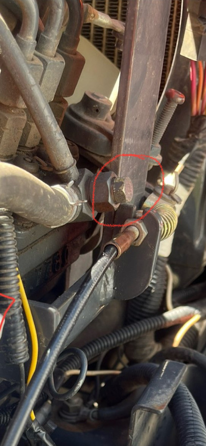

Loosen this 10mm, turn key on and let the lift pump run until you have fuel. Tighten it. Try to start a few times. You may have to bleed the injectors. Don’t use starting fluid.

The filter you need to change is the one under the mower and tucked up against the battery box. Its first from the tank and will plug first. The metal can is your fuel pump and upstream from that is the other plastic filter, same as the one down lower.
Yeah thats the #3 in the picture, i just couldnt fit them all in very well. Ive replaced that one

see if the shutoff lever is stuck "off". I've seen more than a few with stuck/sticking shutoff solenoids. Grab the shutoff lever and see if it will move freely in both directions. The solenoid pulls the lever IN which cuts the injection off. If the solenoid sticks, it'll shut off but won't return back to "on" and it'll just crank and crank and crank and crank and crank but never start.

Ive come back since finally some time off and a sliver of good weather lined up, ive replaced both fuel filters, bled all the lines tested the solenoid, checked 5 fuses (not sure if there are more than the 5) and jumpered the seat safety switch. Still just cranks. How would i go about cleaning the injectors?

Unplug the white wire from the shut-off solenoid, then pull the RED headed screw toward the rear of the machine. See if it will start. To shut it off, pull the Red headed screw toward the rear of the machine.
i pulled the solenoid off and bench tested it, it worked fine. I also tried starting it both with the arm extended and depressed
