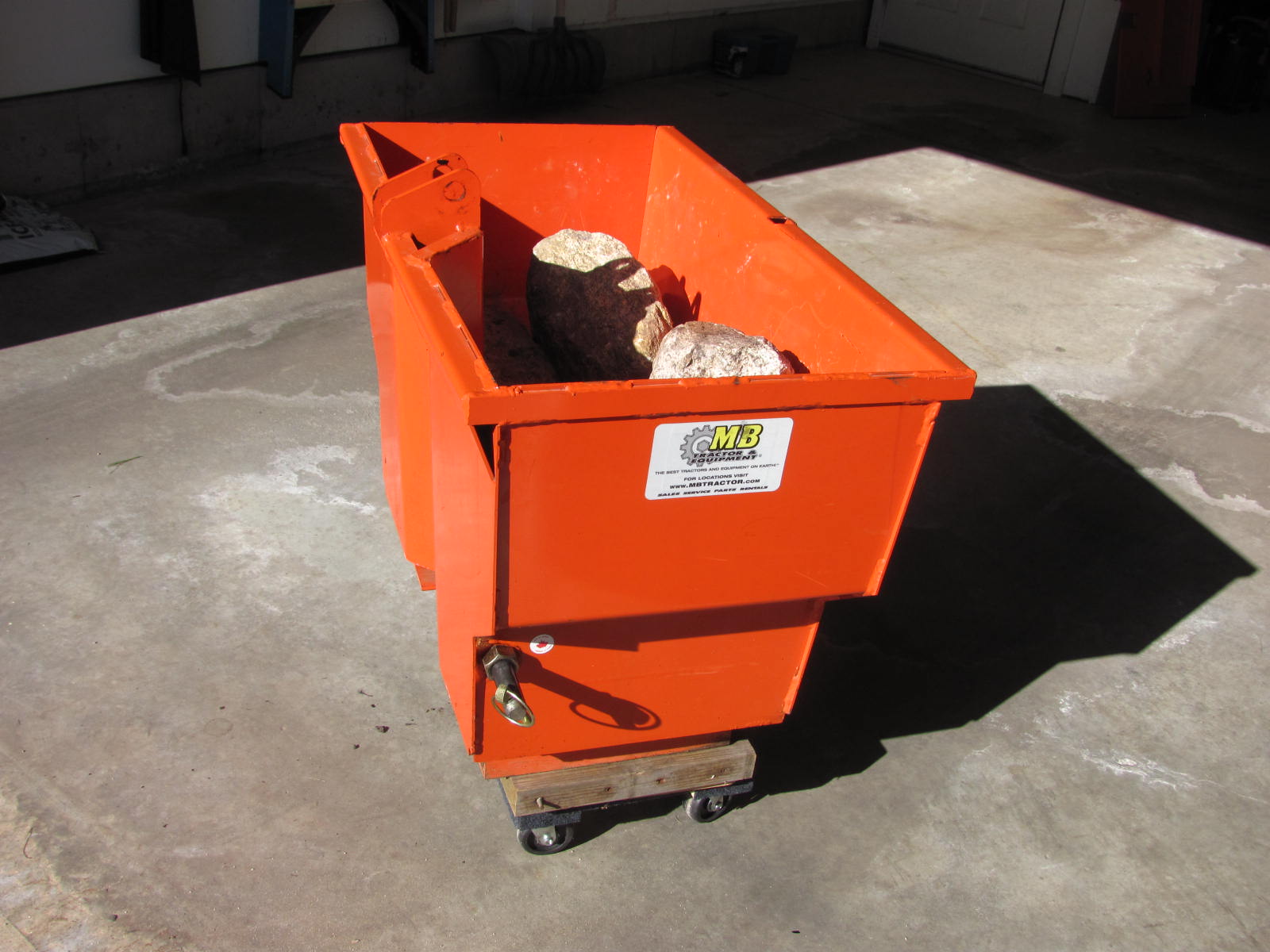

So I decided to buy a Speeco Quick hitch for my BX1880 tractor and ballast box. Not for a second did
I anticipate my Kubota ballast box wouldn't line up to the Speeco. My Kubota ballast box that has a
slanted in sides. Looks like I need to keep the Speeco, and sell my kubota box, and buy a generic. A
problem I never saw coming.

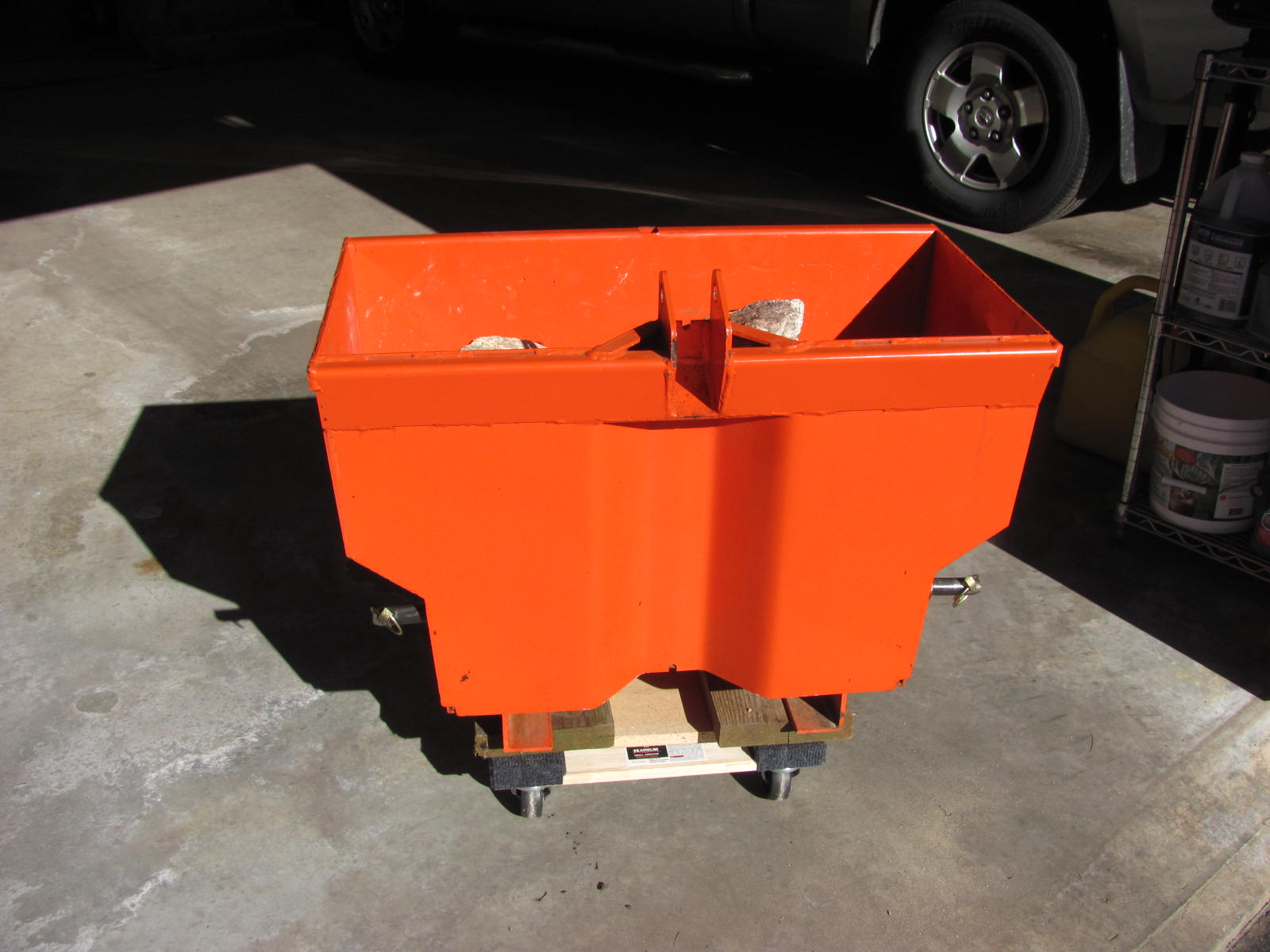

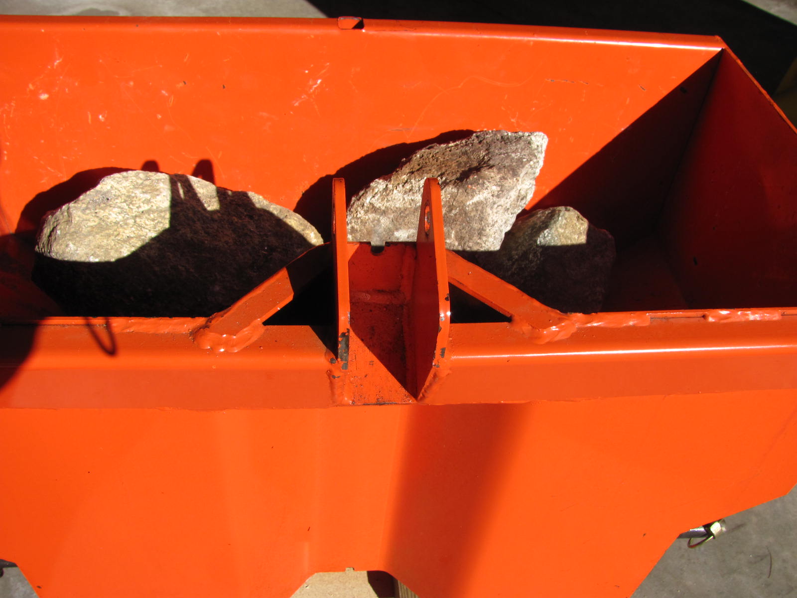

So to highlight for others my Kubota ballast box problem with a Quick hitch. If you have this ballast box do not purchase a quick hitch. Doesn't matter what quick hit it is. it is visible that the two bottom side pins are tucked in too far, and don't extend out far enough for the bottom of the quick hitch to engage. Also they are two short even if the quick hitch were to let them seat. You wouldn't be able to insert the locking pins. As for the top, where the 3pt hitch pin is. It is too far inside the ballast box, and the locking hook on the Quick Hitch, will not enter correctly.
As I mentioned, I have a similar problem with my generic one. Looking at the Land Pride site, they have a completely different design now.
I'm assuming the Kubota branded one is no longer made which seems to be a good thing.
