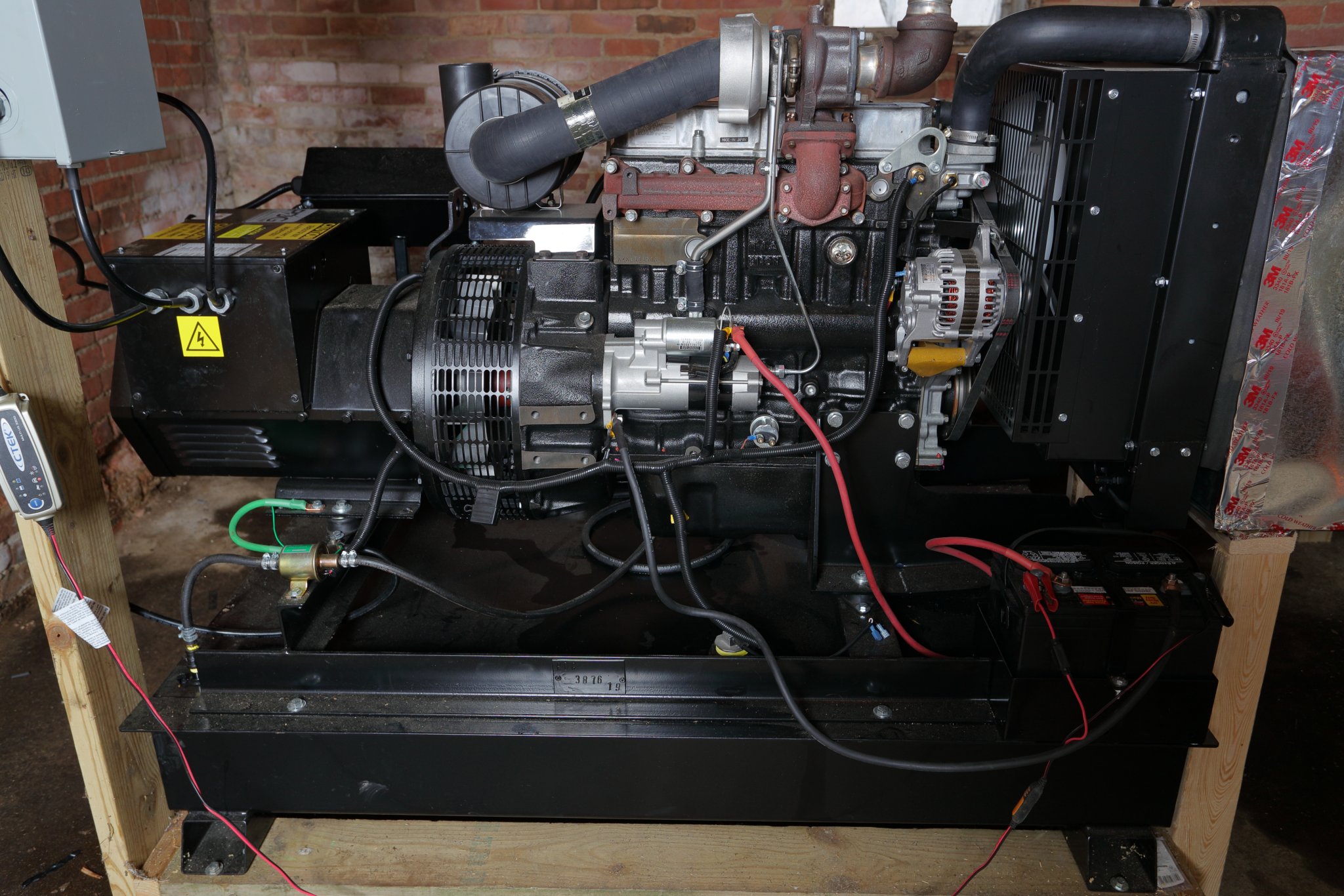

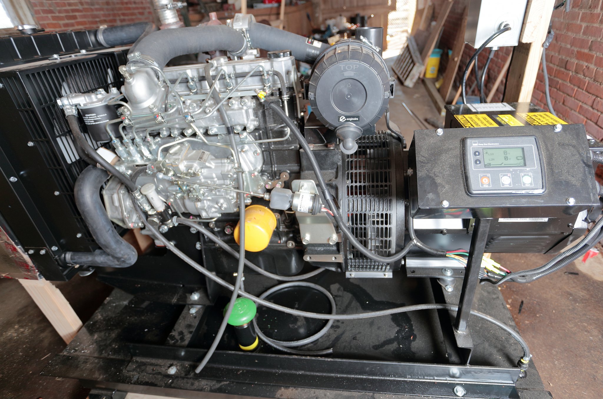

I put in a diesel standby a few years ago, got it before Tier IV/DPF was an issue for these mid-power standby systems. Mine is a 40KW powered by a 3.3L Mitsubishi turbo with a 60 gallon fuel tank and I have additional diesel storage. It is mounted in a basement area of the barn which protects it and keeps it from dropping to ambient outside temperature; hot air from the radiator is ducted out a window.

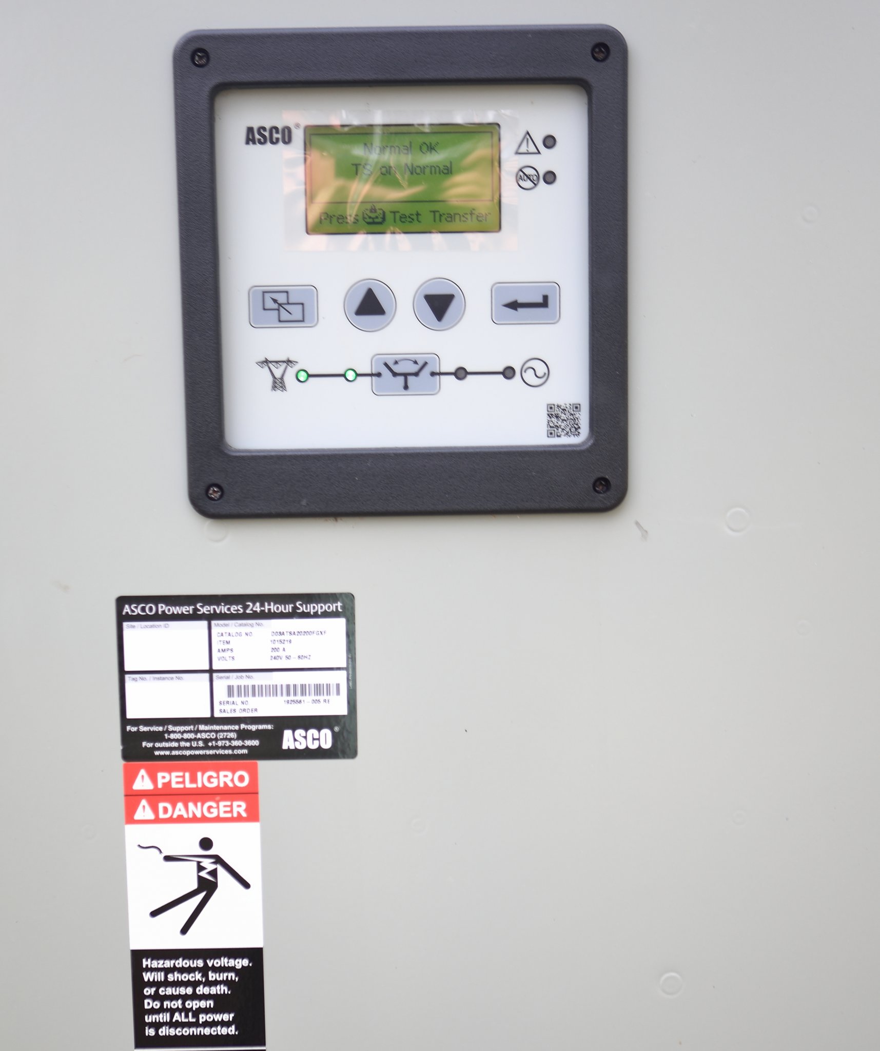

I went with an ASCO commercial auto transfer switch that has a programmable timer that allows the generator to start and warm up for 4 minutes before it transfers the load, most standard units switch over 3 to 6 seconds after the generator starts which isn't great for a cold diesel engine although this has temperature controlled coolant and oil heaters. The delay also gives time for the compressors in the refrigerators and deep freeze to equalize before power is reapplied and the transfer switch does an in-phase transfer when commercial power returns. The capacity is a bit overkill but I liked the features of the 40KW diesel (direct injection, mechanical pump and governor with electronic fine tuning of RPM via the autostart/engine controller better than the available 30KW versions.
It sips fuel at my typical load but has no problem running the deep well pump, two electric water heaters, etc. Biggest issue was getting a good load on it for break-in and I was running both central AC systems along with some space heaters plugged in and showers running to load it to 65% of continuous rated power :)
The TS switch sends a start command to the generator controller after 3 seconds of commercial power failure and once it reads correct voltage and frequency from the generator, it starts its 4 minute countdown timer before transfer. It does a monthly 25 minute exercise cycle under load to ensure it is ready to go when needed.
It definitely beats my old method of going to the barn and starting the portable gas 10KW generator and wheeling it to the house and flipping breakers (generally in the middle of the night during heavy snow!). Now I can just look out my bedroom window and see the status lights on the transfer switch knowing that in a few minutes the lights will be back on while I stay warm and dry inside.
View attachment 83004 View attachment 83005 View attachment 83006
I worked on a lot of commercial and healthcare stand by systems. They all fired and took load right away. Coolant and oil were always fully up to temperature. The Healthcare side of things was some sort of requirement for life saving power. The commercial side of things were for refrigeration needs. They weren't quite as bad as healthcare. But after a certain time frame with no power the food ect had to be thrown out. Truthfully a few of these generators had thousands of hours on them and were in remarkably good repair, for what you would think of as abusive loading, but the homeowner sized generators were the ones that seemed to suffer the hardest, especially the air cooled engines. Fire up, go to 1800/3600 and get load.
I went the diesel route at home as well, just not a 40k unit. 6.5kw mosa. Actually it's enough to run the entire house except for the hot water heater. That circuit gets cut out when the transfer switch goes into generator mode. We'll pump and everything else is quite happy. Really easy on fuel. My wife has nagged a bit about going with a larger set up, but I don't forsee that for some time. Not untill the kids are much older, at any rate.
