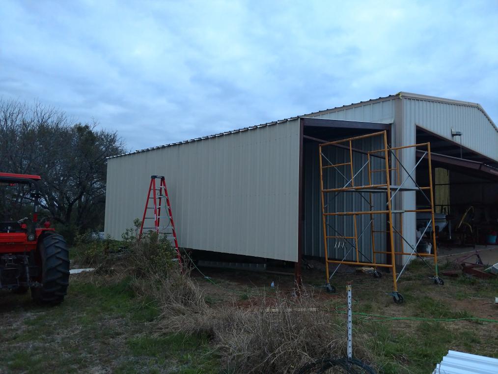

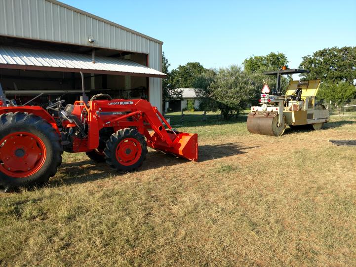

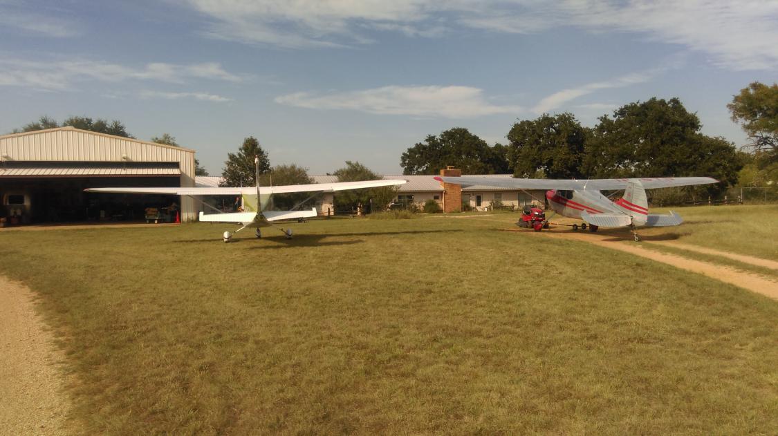

I park it on concrete inside a 50X50X18 hangar....err...BARN! Yeh...BARN...THAT'S THE TICKET!
I have just this month completed a side-shed for implements and put 1" granite gravel in for a floor and am interested in that perforated stall-mat... Where is that found?

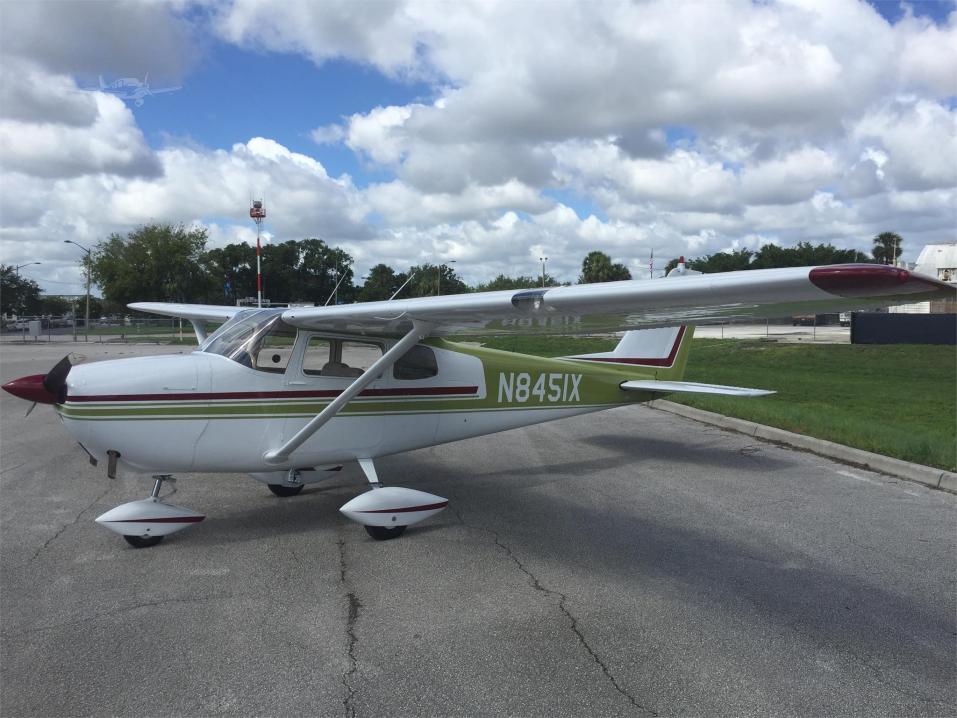

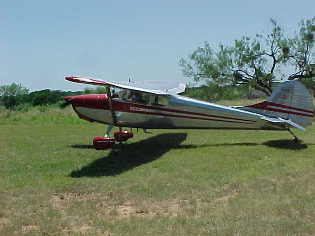

Whatcha got in the BARN, a 172?
Yes,... a '62 Cessna 172-C, just bought last year to train my step-son who wants to get his pvt certificate. He thought I would use my '53 Cessna 170-B (restored Oshkosh-winner) but he is definitely wrong about that!
If he does well and demonstrates proficiency in the 172... we'll consider transition-training to the tailwheel later on.
I was considering putting "marston" mat (war-time perforated steel landing mat) in the shed on top of the gravel but that stuff appears to be extinct.
