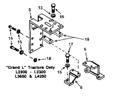

There is a reinforcing top link mount that you can put on it to greatly mitigate possible damage.
This is similar to what you need.
I'll dig some more for the exact one for a L4400.

To save major pain to your wallet, DO, at least, get the top link support, as suggested by Wolfman in post #43.
He knows of what he speaks!

Glad you got the tractor bought. For a extra piece of mind it might not hurt to either buy or fab up a reinforcing bracket for the top link. Enjoy the new toys.

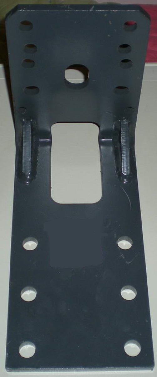

Here's a photo of my heavy duty top plate. Behind the 90* bend are reinforced gussets (little 90* wedges, welded on). Bolts on the top and the back side. I bought new bolts for both the backside and the top side that were longer and higher grade. I had welded on the 3 point hitch "ears" to make it more of a single unit (not the best welding job but good enough!).
Some one wanted to buy one, I'm not sure Kubota sells them any more and I had not seen them for your L4400 (which is already bigger and beefier than my tractor).

I’m hoping that Wolfman can find a source and I can buy it. I’m not much of a mechanic and have never welded. if he can’t find a source, I‘ll have to figure out how to get something made.
