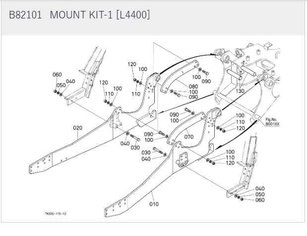

Buying that subframe really wouldn't do you much good, as that BH itself does not have the other half of what you would need to attach it.
This is the part of the BH that attaches to the subframe above.
It would be very pricey top make that part to fit a three point BH.
You would be much better off selling the three point BH for whatever you can get for it and buying the 4 point (subframe) BH.

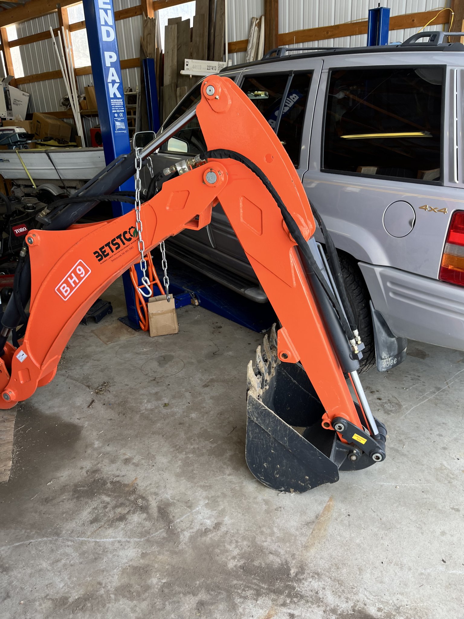

I called Betstco, which makes the BH 9, talked with their tech suoervisor. He said they use a 4 pt mounting system. I’m attaching part of the brochure. Going to go check it out and see if it operates.

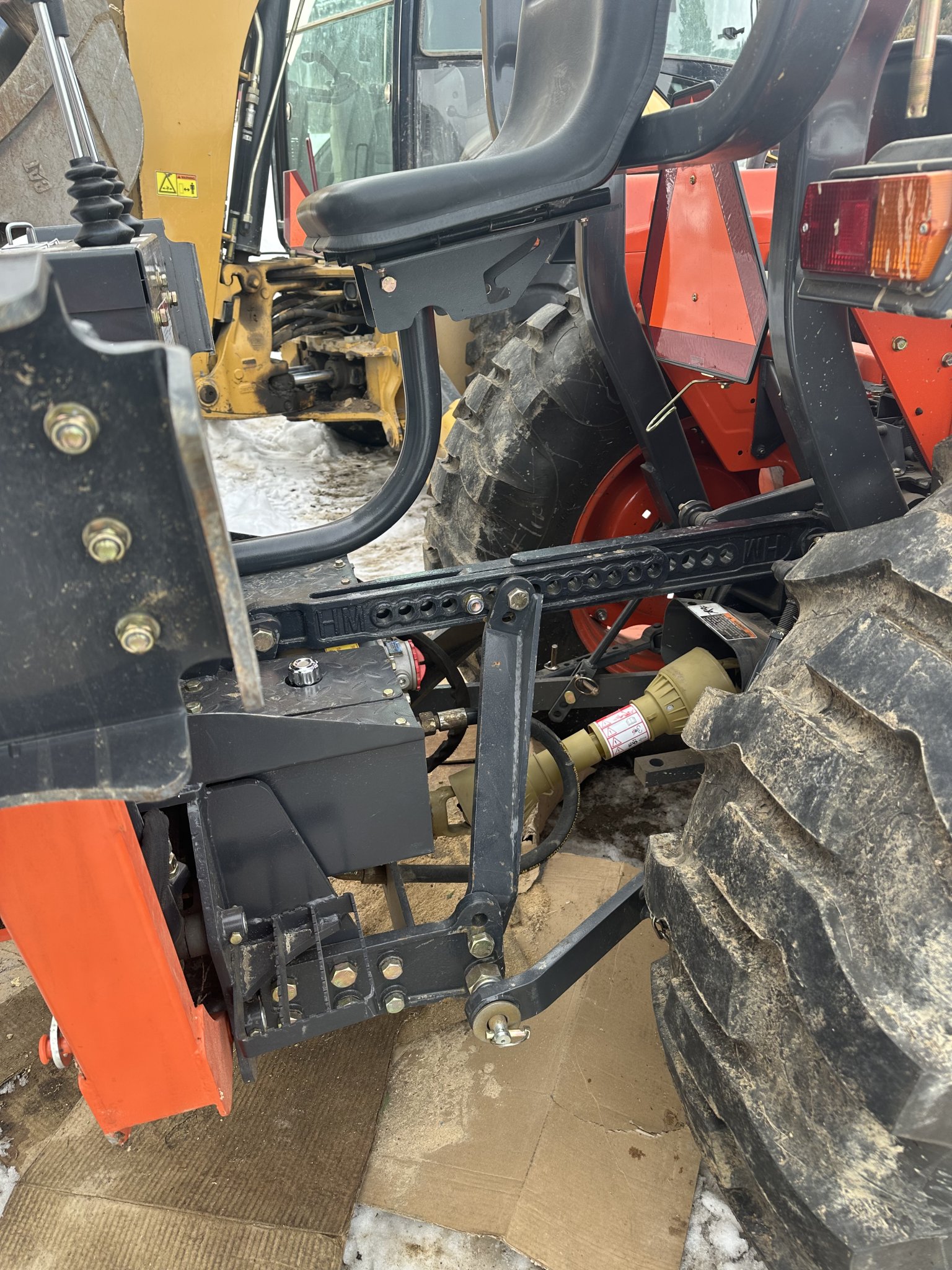

I think someone is pulling your leg.
I'm only pointing this out because It really does matter for the health of the tractor.
Three point mounted BH's damage tractors!
This is a picture off their web site of the mount they use.
They can call it whatever they want, but that's a three point mounted BH!

Under Key Features in the brochure that @SilverEagle posted it states:
"Rigid 4th point mounting eliminates need for frame mount"
So you're absolutely right that this a 3-point mounted backhoe with a 4th member.

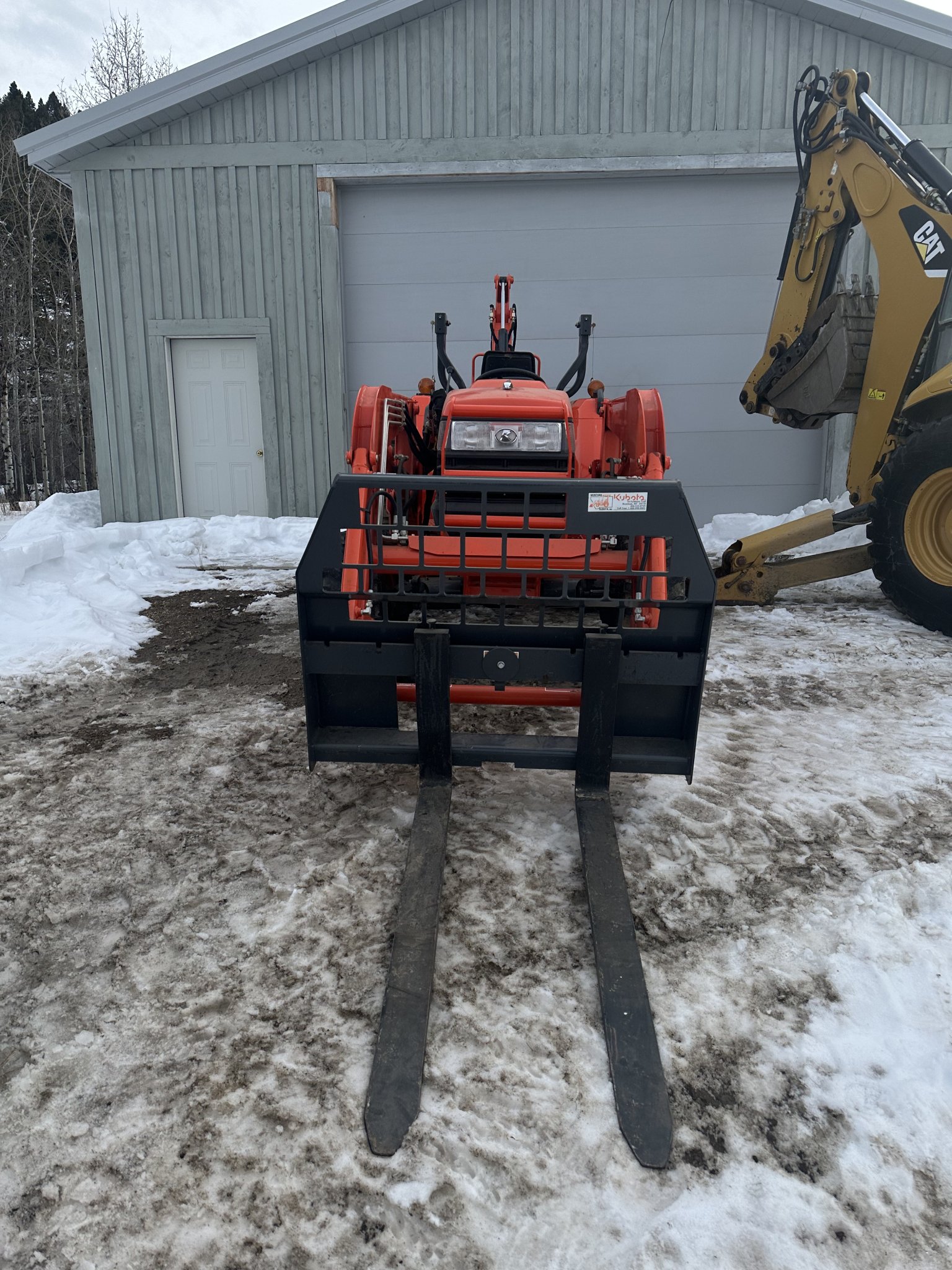

Here are some pics of the tractor I’m considering buying. 20.3 hours. Runs great, bucket, forks, loader all work as expected. I’m just concerned about the 3 or 4 pt hook up. I called five Kubota dealers and a few other suppliers and no one has a frame mount. If I can find one, prices are around $2500. Not sure my anxiety on this purchase is being quelled. Thanks to all for your comments.

I ran a three point back hoe on a JD 3020 for twenty years and did a lot of digging with that hoe and never had a issue with it. I didn't use it like it was a 20 ton track hoe either tearing out giant stumps with it. Sold the complete set up to a fiend years ago and he still is using it and has never has had a problem. Can you break your tractor with a three point hoe yes you can. If you use that back hoe with in reason it will be fine and sure will be nice to have around to repair a frost free hydrant, install a water line or what ever digging job you have. I have repaired and seen a lot of front end loaders broken on tractors. Never broke one myself. Its like everything it can be broken. I wouldn't be scared of that set up . I sure don't know were your going to find a cleaner used tractor. I would get it bought and enjoy the tractor.
33,490
8,758
Did your 3020 have a cast aluminum housing that the three point was mounted too.
Nope it was cast Iron, big difference in strength.
