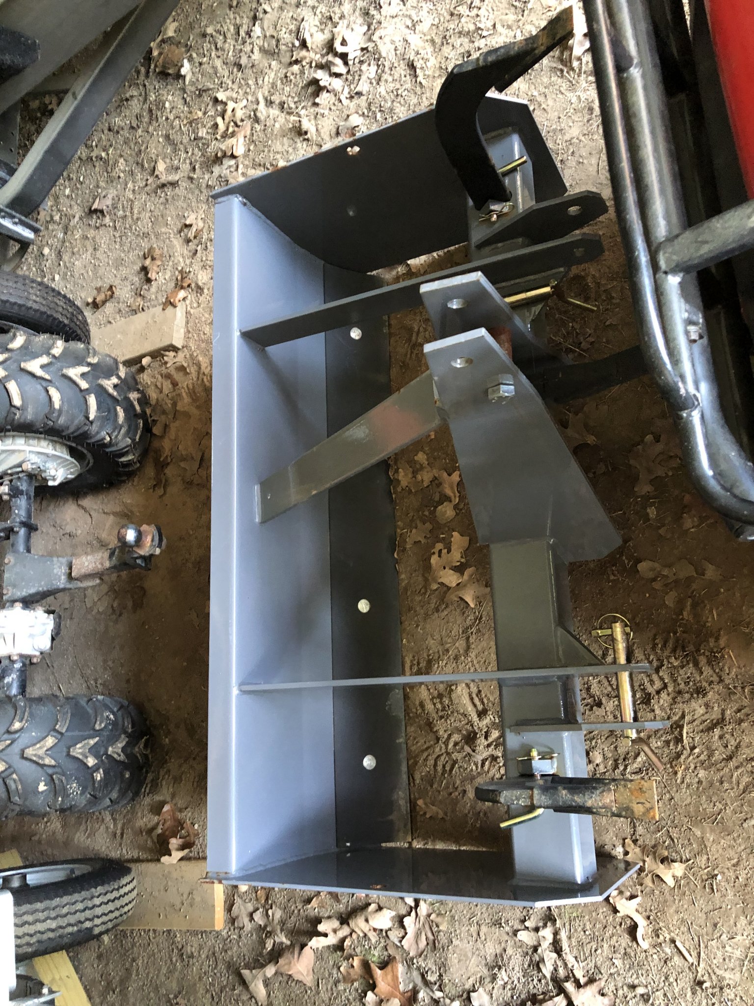

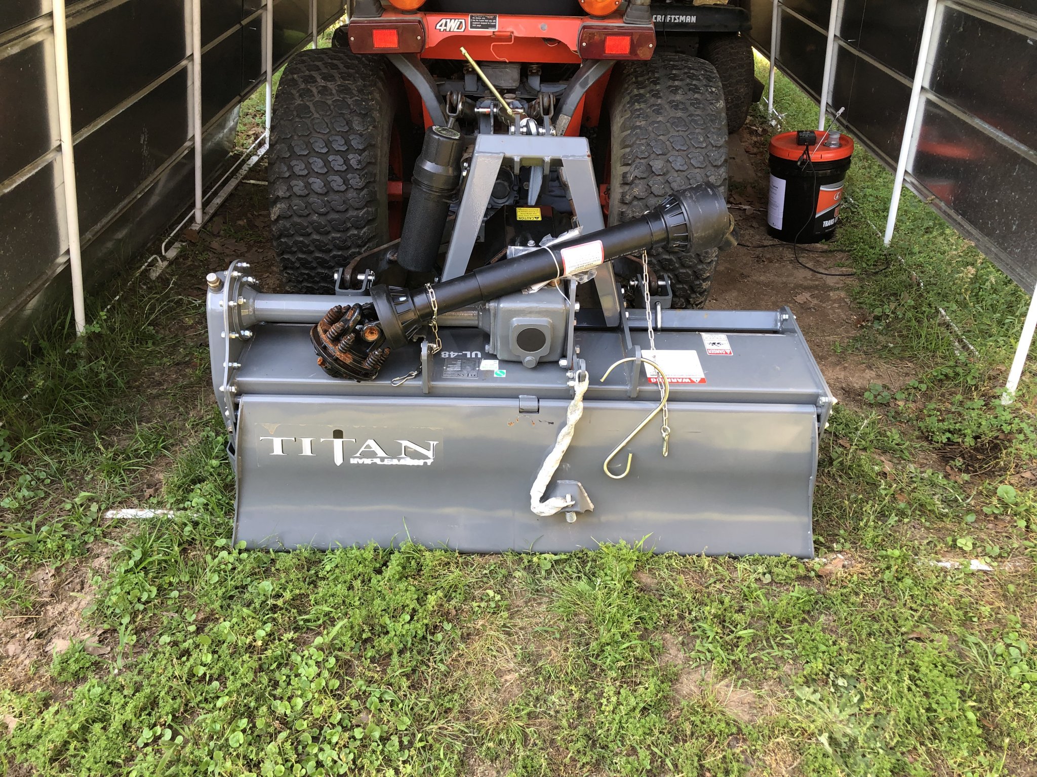

i saved a few hundred bucks, bought this 4 ft titan, also got a 4ft titan box blade at same time.

i had to cut the pto shaft for my titan tiller to fit my kubota, very simple process, spec when i have never cut a pto shaft, let alone owned a tractor until i purchased this b2100. all pto shafts will be a factory length, you may..or may not have to cut the pto shaft to fit which ever tiller you buy that you plan on attaching to your tractor. your tractor's rear live pto will be a standard output shaft, as well as the tillers pto shaft shank will be standard as well. the only thing you will have to do is cut the pto shaft to fit from tractor to tiller.
I watched a few youtube video's on how to do this, but most made it look long and hard ?, but i did understand the process. so with that said, here is how i measured and cut my pto shaft. please keep in mind !!, i do not have a QH ( quick hitch attachment ), i hooked my tiller straight to my 3-point hitch on my b2100 tractor. the way i measured my length was i measured from the slot where the pin catches on rear output of my tractor, then from there back to the tillers slot where the bolt goes through on the tillers shaft, this put me right at 25 inches..yes..it will be short for my set up.
Once i got my length, i took the pto shaft apart, removed the plastic outer part ( they have tabs to press in to pull them off the shaft..mine did anyway ) i laid them out on my bench, one right next to the other, then i measured my 25 inches from slot to slot, this showed me how much i needed to removed from each shaft, YOU MUST CUT BOTH SHAFTS TO ALLOW FOR THEM TO SLIDE WHEN RAISING OR LOWERING !, once i seen how much of the shaft i needed to remove ?, i just used a hack saw ( yes..it took me a min or two to cut them..lol ) filed down the burs, slid them together, took it to my b2100, slid it on my rear pto, then slid it on my tiller, when i made my measurement ?..i had the tiller on the ground, level with my rear pto at tractors end. i had no issues what so ever attaching the pto from tractor to tiller.
Then i removed pto, seen how much of the outer plastic cover i needed to cut, and yet at the same time, left enough cover to over lap when in the up or down position. once i had this done, i then greased up the shaft, put it all back together, and walla..worked like a charm !. PLEASE KEEP IN MIND !!!, YOU MUST NOT ALLOW THE SHAFTS TO '' BOTTOM OUT '' INSIDE AT EITHER END ??!!!..OR YOU WILL DAMAGE YOUR TRACTOS PTO ?, OR THE TILLERS SHAFT AT THE GEAR BOX ?!. i hope i made this info useful for you ?, good luck !.
