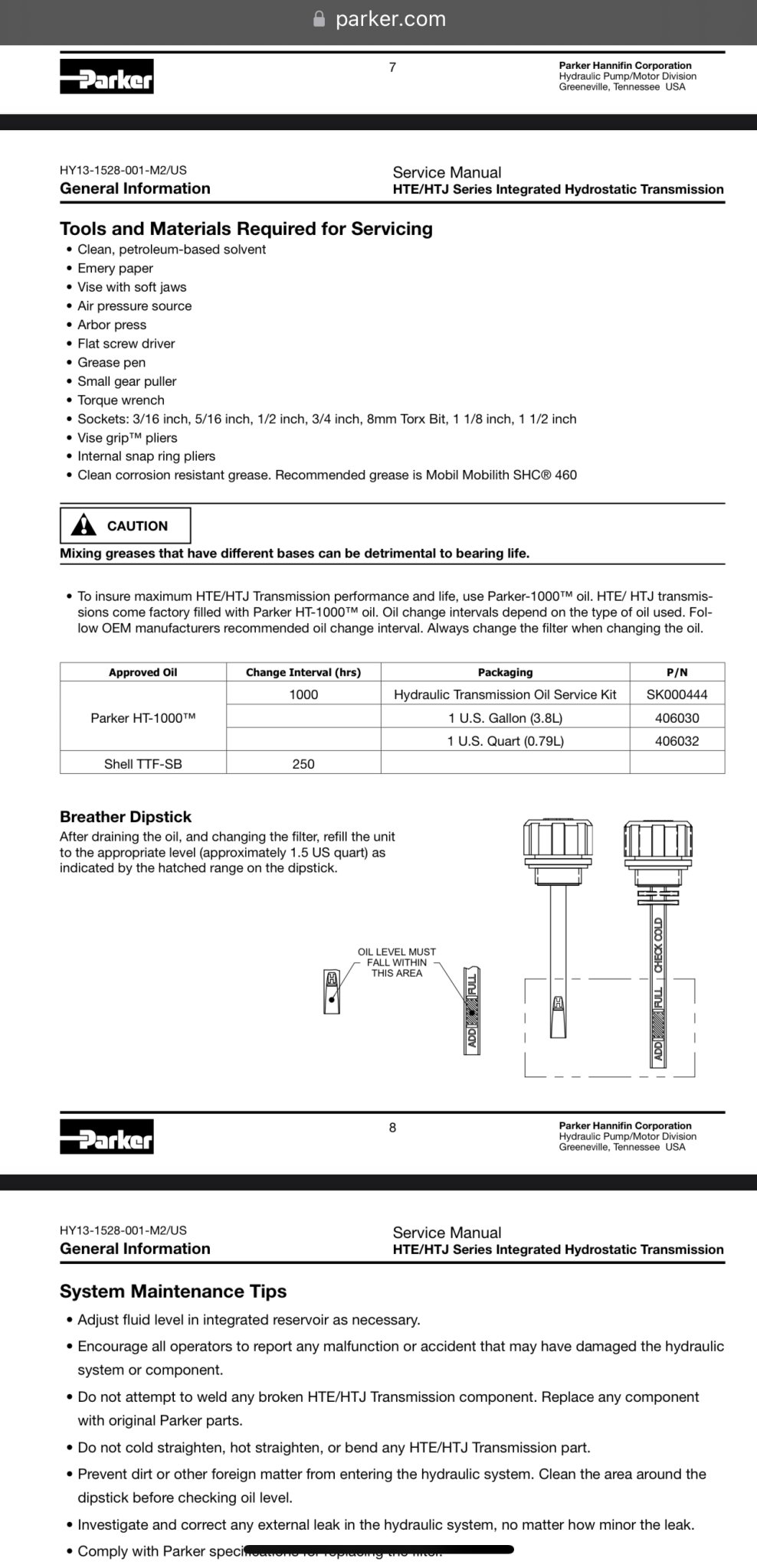

If the mower in question has Parker drives, here is from the manual.
Have the Parker drives in my non kubota zero turn.

I made the comment that the HT 1000 data sheet was unremarkable. In fact it is remarkable in one regard - HT 1000 does not conform to any ISO viscosity grade. It is dead in the middle of ISO 100 and ISO 150. There is no official ISO 120 grade.
The alternative Shell TTF-SB oil in the manual is in fact an ISO 100 grade oil.
Can't comment on Parker's claim of extended (4X) OCI with HT 1000. That would take more than a couple extra points on viscosity.

Thanks Dan! I only posted that because I remembered when I did mine that the HT 1000 wasn’t the only fluid Parker showed. (Not sure if the OPs mower even has Parker drives,didn’t look that far)

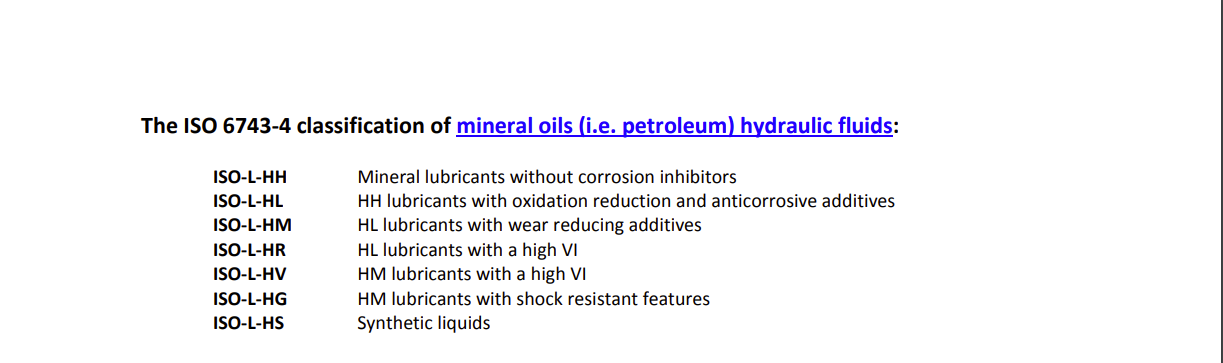

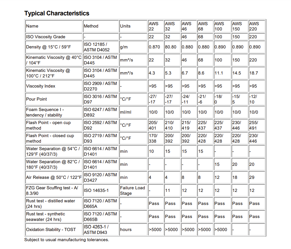

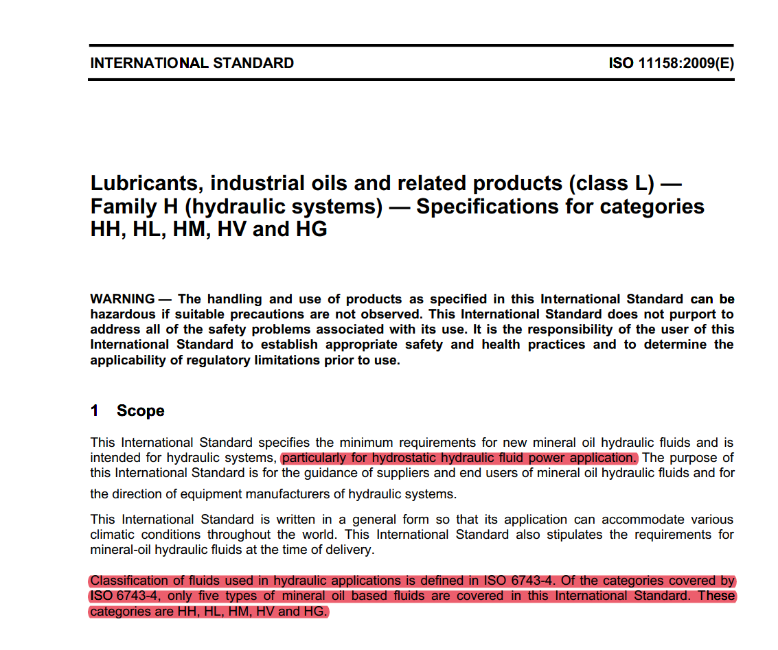

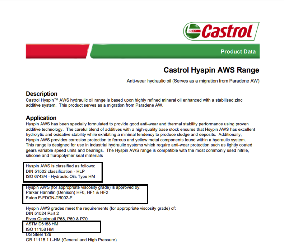

Perhaps OEMs should start being honest and these discussions could be a little more reasoned and fact based and reduce the hyperbole level. There are good solid performance based standards and metrics that they can cite if they wanted to:
But that would make it hard to justify the name brand FUD they spout and enable owners and operators to make fact based choices. Third party lubricant manufacturers have no problem giving you real perfomance data and industry standard specifications.
