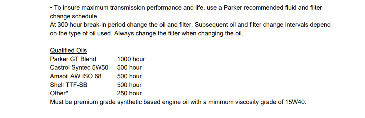

This thread quickly went off the rails and your question never did get answered. I know next to nothing (some might say even less) about these machines but I can research and read so let me have a whack at it.

However the Parker HTG Transmission Service Manual has a bit more to say on the matter:
The manual is the current version from Parker but is "Effective June 2012" so it appears to be a bit older than the current (2020) HTE/HTJ service manual and likely less tainted by the current Parker brand name sales pitch. Lets take a little look at those oils:
Parker GT Blend
Google can't find any reference to it Its represented in the service manual as a 1000 hour oil so presumably its simply been rebranded as Parker HT 1000. Probably reformulated to some degree as well. I am going to conclude it was a similar monograde SAE 40 oil formulated from Group II base stocks and contained little if any VI additives. Basically a conventional AW 120 (ISO HM) type hydraulic oil. A very heavy duty hydraulic oil but not well suited for even mildly cold ambient conditions.
Castrol Syntec 5W50
This is now called Castrol Edgewith Syntec and is a full synthetic multigrade engine oil that you can buy at your local Walmart for about $9 per quart. Its made from high VI base stocks, fortified with VI modifiers, and boasts a viscosity index of 176. A very different animal from the HT 1000 oil Parker is now hawking.
AMSOIL AW ISO 68
This is a monograde AW 48 (SAE 40) hydraulic oil (ISO type HM/HL). Low (106) VI and no claim of synthetic so we can assume conventional Group II/III mineral oil base stocks. Slightly lower KV40/KV100 viscosities but other wise very similar to the Parker oil
SHELL TTF-SB
This is a SAE xxW40 multigrade oil with a VI of 132 and formulated specifically for Hydro-Gear hydrostatic transmissions. Possibly a semi-synthetic base oil formulation. Commonly labeled and sold as either Cub Cadet or Hydro Gear hydrostatic transmission fluid. Again very different from the Parker oil.
OTHER
Now we get really generic. ANY premium synthetic multigrade engine oil with a viscosity equal to or greater than 15W40. Substantially different from the Parker oil but what many of the lawn and garden equipment OEMs specify. Even Hydro Gear acknowledges it in the service (not sales) documentation for thier current product line. They add the requirement that the oil must be SL or newer service class with a zinc content of 1200 PPM or higher.
