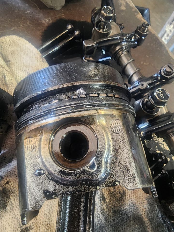

Saw this posted on a Kubota forum. L3200, 241 HRS.
So here's the story. customer let buddy use it. fuel gauge didn't work. buddy ran it out of fuel
tried bled air out. in process of cracking lines he twisted nozzles on injection pump. didn't know he did. got pissed when couldn't get it to fire so he sprayed half can to her

I always thought you wern't sposed to use ether or starting fluid with glow plugs ....

OUCH !!! Customer and buddy should split the repair 50/50
Customer supplied tractor with a defective fuel gauge....
Buddy used can of ether....

If ether is used to start an engine the safest way is to spray outside the air intake a ways so the spray is taken to all cylinders and not concentrated.
No procedure is advised for Kubota engines though!

To the OP: Customer’s “buddy” owes for an engine rebuild/replacement. IMO

I wouldn't say the 'buddy' was stupid. Until I came to this website , I never knew you couldn't spray ether into a KUBOTA diesel engine. For 15 years I did 3 squirts into my Buda, started every time. You see truckers and heavy equipment guys on TV or at job sites, ether is used....all the time. So from that perspective KUBOTA is the 'odd man out'....using ether would be normal....
Running out of fuel was due to defective gauge. Unknown, but I suspect it read fuller than it was ? The buddy refueled, primed the engine and it didn't start. maybe not enough battery for glow plugs and starter ? Don't know, but unless you KNOW Kubotas don't like ether, you'd pist 2-3 shots in and spin the starter, after all that's how it's done..all diesels are the same, right ?
