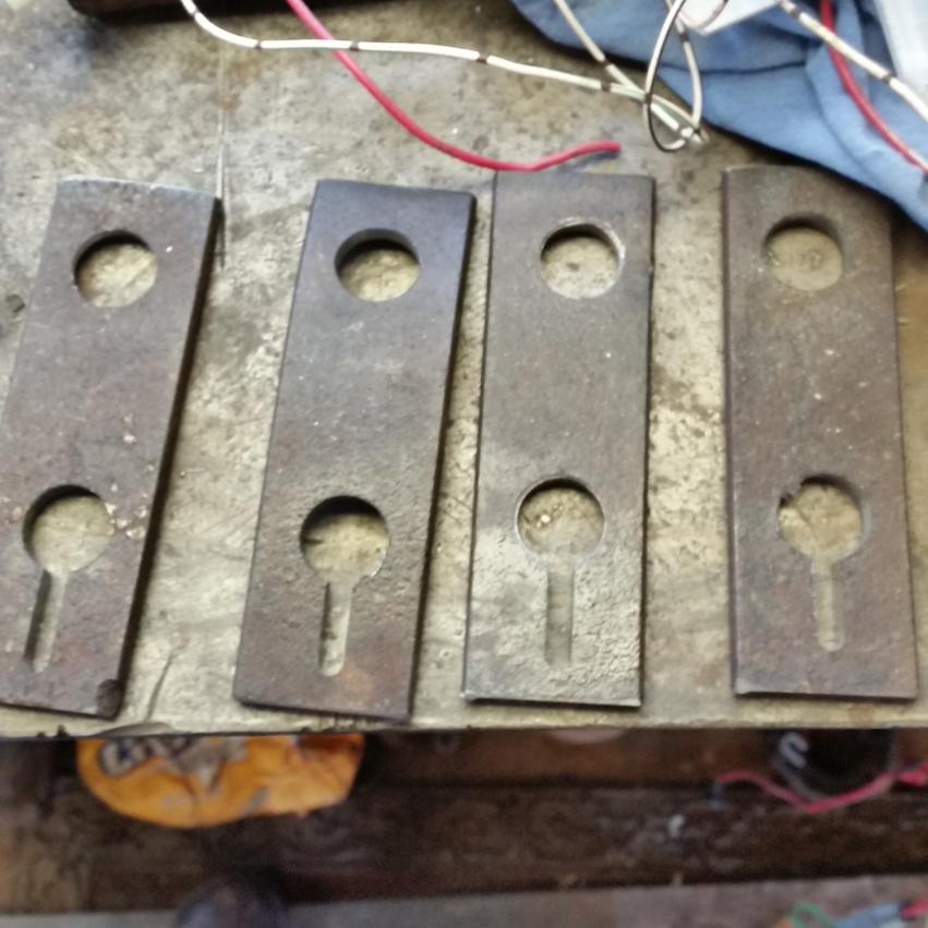

ZTman, you could get some "check chains" as described in the manual and once you have them adjusted you can just remove a lynch pin and remove the chains. Leave the links on the chain (or wire them to the chain link you want) and the mower will always be the same height at the front.
Leave the rear wheel on the ground. Have the top link adjusted in the center of its adjustment so when you go over a terrace your mower can follow correctly.

I think you can buy the chain links at most farm stores. I had a friend make these for me. I use them on a flail mower that I want to keep about 8" off the ground.
One of the chain's link fits in the long slot. The opposite end fits up by your top link, where it connects to the tractor, or it can be down at the implement hitch pin. You can get by with two pieces if you bolt one end of your chain to the implement.

his is the set up I made for my 640 Ford. The areas I mow are not exactly what you call golf course quality. Lots of humps bumps and stumps. Check chains keep a constant height on the deck. Old Fords are not exactly known for holding a constant height.
Also set the front 1" lower than the back.
