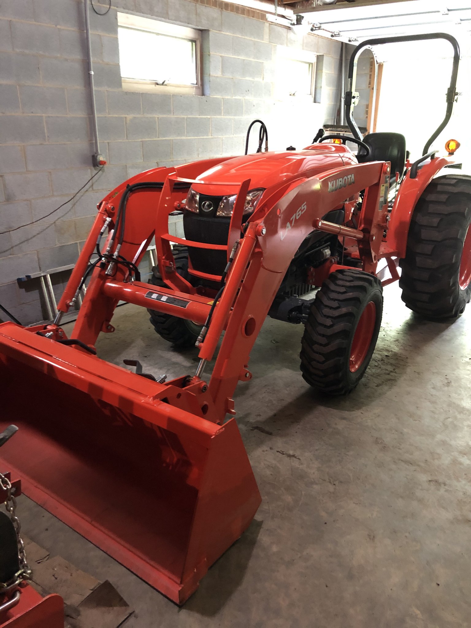

With all our tractors and implements since I was a kid it has always been get it inside of at all possible, definitely if more than a few days, and always set down whatever was being held up by hydraulics. If the bucket is damaged from sitting on a garage floor or sitting on a dry shed floor, I’d kind of wonder how good the steel was they made it with. I do always hose wash the bulk of the mud or whatever other crap is on it off before putting it up if it’s loaded. The clay here is a LOT easier to get off before it dries.
I have heard of people waxing tractors. It does appear to have single stage paint on it so that kind of makes sense if it lives outside and you don’t want it to fade. Mine mostly lives inside so I don’t plan to wax it unless it starts to fade and it bothers me. I’ve never waxed any tractor but never had one
this nice either.
So far as relieving pressure in all the hydraulic lines, I do that every time. I don’t think there’s a good logical reason for it since they’ll leak a little over time and relieve themselves anyway. I had a crew boss on a cable laying crew about 35 years ago who had a pet peave about relieving the pressure in all hydraulics on all machines at the end of the day. He was a Marine vet and if he wasn’t a DI he at least picked up some of their habits. I’m still a little scared if I don’t relieve the lines he’ll jump out from behind a shelf screaming like a madman. Probably wouldn’t happen but why take a chance when I don’t have to?
this nice either.
So far as relieving pressure in all the hydraulic lines, I do that every time. I don’t think there’s a good logical reason for it since they’ll leak a little over time and relieve themselves anyway. I had a crew boss on a cable laying crew about 35 years ago who had a pet peave about relieving the pressure in all hydraulics on all machines at the end of the day. He was a Marine vet and if he wasn’t a DI he at least picked up some of their habits. I’m still a little scared if I don’t relieve the lines he’ll jump out from behind a shelf screaming like a madman. Probably wouldn’t happen but why take a chance when I don’t have to? View attachment 50805
Kubota has never added ultra violet protection into their paint. If they did/do, its surely not nearly enough. Thats why they fade so quickly sitting out in the sunlight. Even all the plastic pieces begin to bleach out to white in a short amount of time because there is no ultra violet protection. It costs more money to add the additive.
Wax wont protect that from happening either. But some people like to wax them anyway. We waxed ours the first day we bought it. It helps it to stay cleaner longer, if that makes sense. Haven`t waxed it since after that. Its a 2017 BX23s and it still looks new. We do keep it in the garage, so that helps tremendously in keeping it nice as well.
