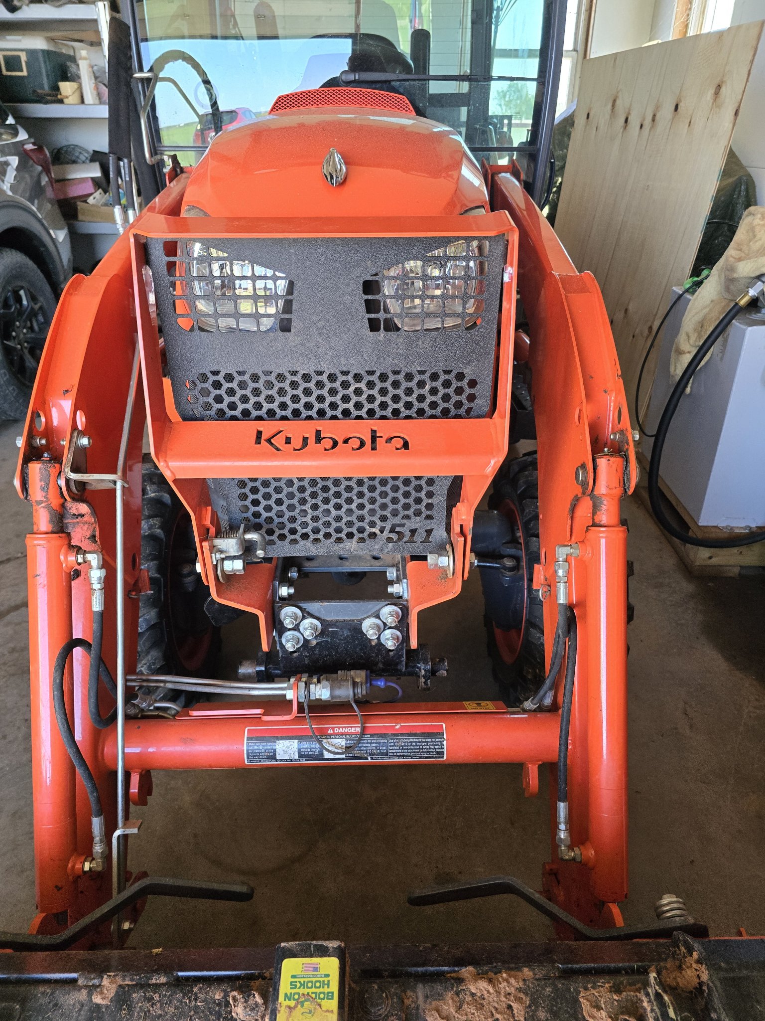

My @5elevendesignz grill guard did it's job well again.
Tools of the job
Not sure how many times this saved the grill since I installed it. This was the second time where it was hit hard enough to push it in where I had to massage it back to shape. Well worth every dollar I spent on it. I wish side guards were available for the LX.

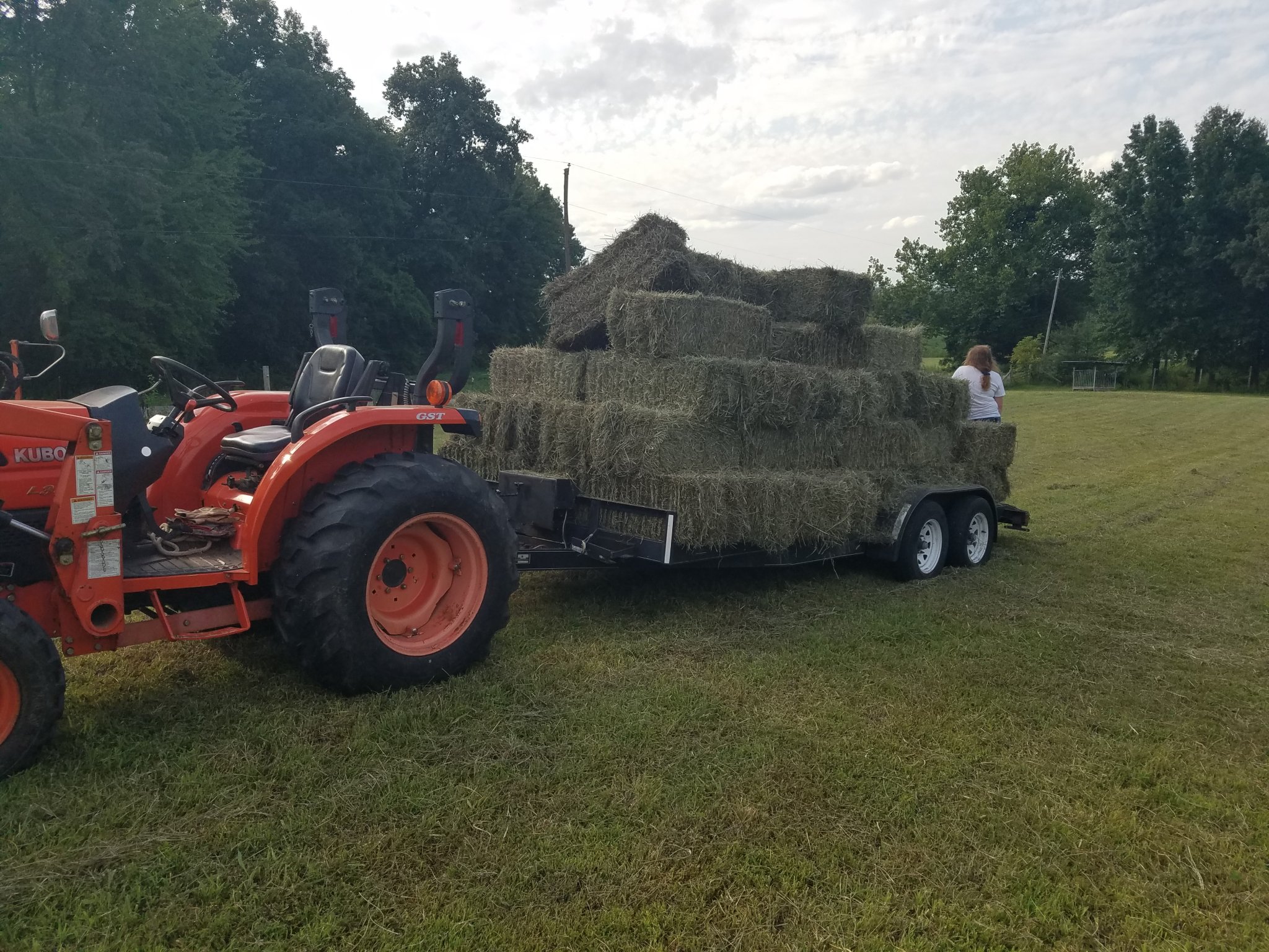

Picked up 225 bales this afternoon. Here in S Indiana, we've had 4 days of incredible weather for August. Low to mid 80s and low humidity. Normally we are in mid 90s and high humidity, making it miserable.
Picking up hay was fun!
We've had several days of great August weather down here in the mid-South also. Not quite good enough to inspire hay hauling, though.
