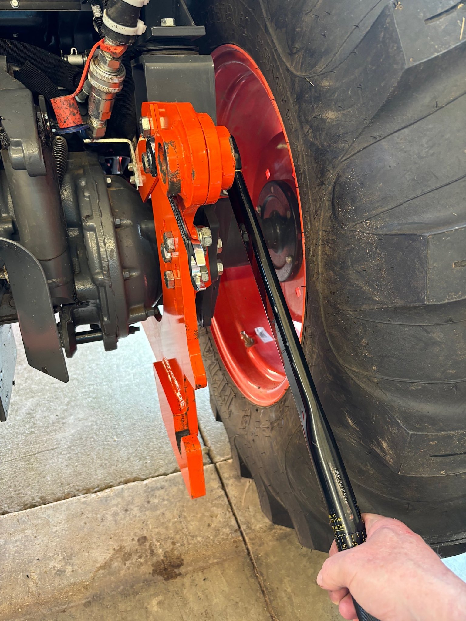

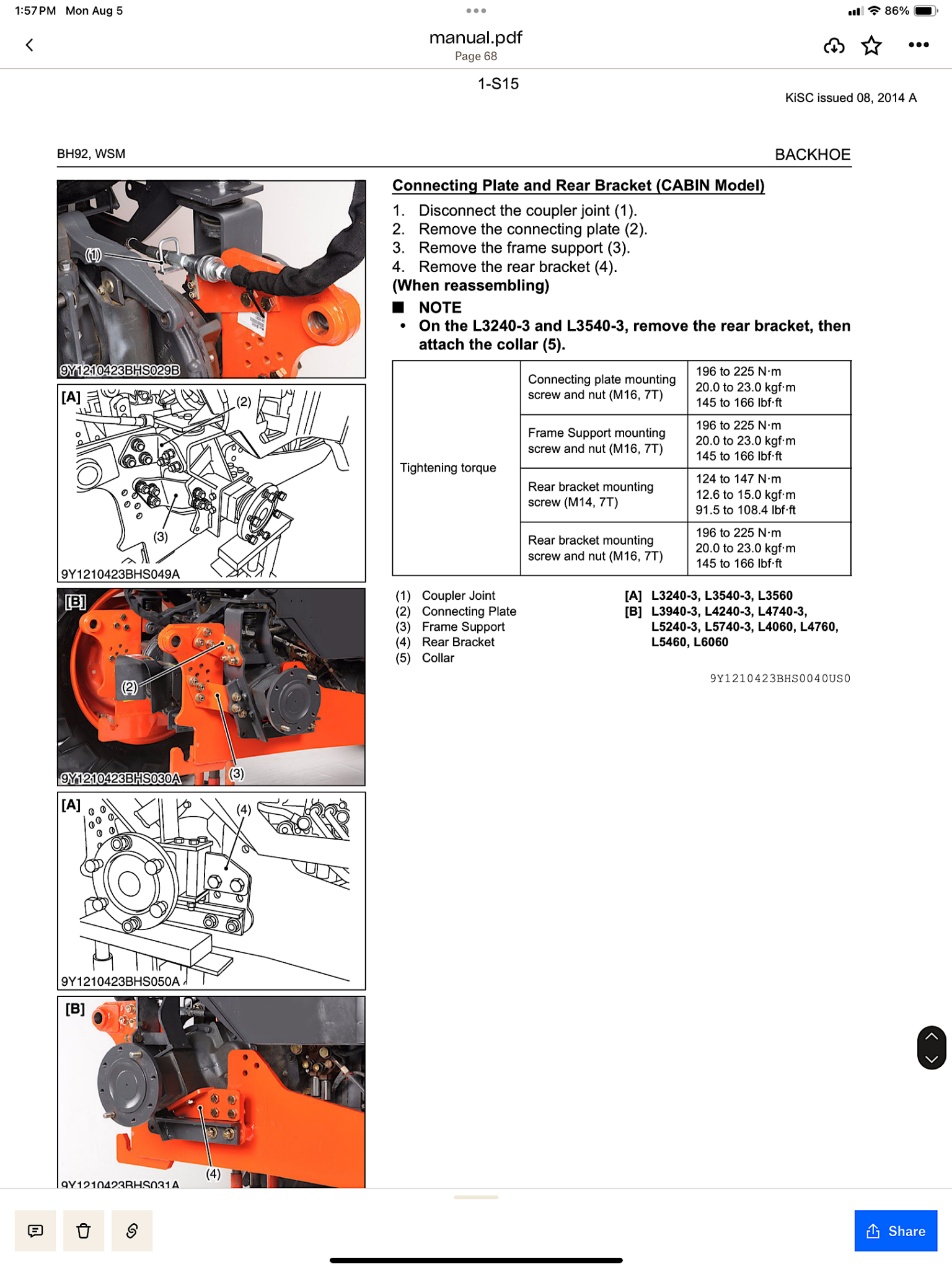

So every year I check torque on BH subframe before installing the BH92. This year (I’m really late) I stripped a bolt just like last year, like WTF 😬. The Mrs says did you check the manual? Yes, please get me a beer (note to self - dumb request!). I pull up the WSM and the torque says 275lbs. like I’ve been doing (actually 250 cause that’s as high as my wrench will go). BINGO! I notice that the bolts I’m stripping are not in the same location as the 275lbs one, so I read a few more pages and discover I’m on the connecting plate and factory is 145-166ft lbs. I slink into the house to get my own beer and order more replacements.
  1. Don’t assume that “subframe” torque is the same for every bolt.
  2. Keep mouth shut and get your own beer!🍻

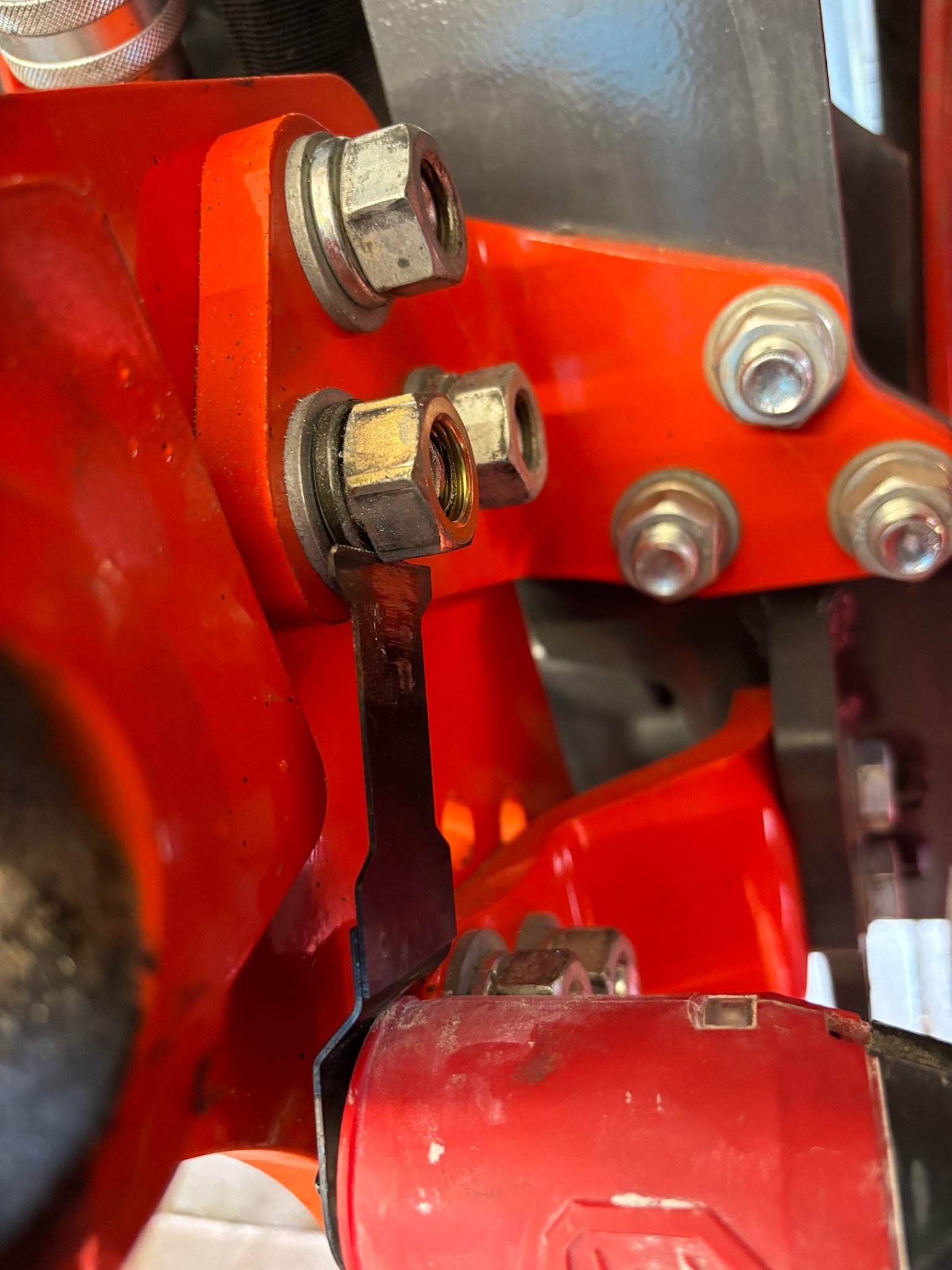

  2. Keep mouth shut and get your own beer!🍻 View attachment 134543
What's up with the short bolts?
OEM calls for same bolts both sides and this side has an extra piece in it. They protrude on the other side so I’m assuming it was a cost consideration to use them for either side?

I would assume they goofed.
Per ASTM, 2 threads in the nut will hold the shear strength of the bolt. Not sure I would agree either, but if Kubota can save $.03/bolt……I prefer to see at least 2 threads sticking out of the nut. My experience in MV switchgear has never been pleasant with short bolts.
I doubt that it is about the $.03, I also know better than using bolts that don't reach thru the nut. Any engineer that believes that two threads will hold a bolt needs to find employment where he doesn't endanger others.
I agree with you. But I had that argument more than once with a lot of different manufacturers that paid more for the warranty repairs than a longer bolt would have ever cost them. Just remember, if you want 5 ONLY ways to do something, just ask 5 engineers. I’m a firm believer that if at least one thread isn’t showing, the bolt is too short, and as an engineer, that’s my ONLY way.
