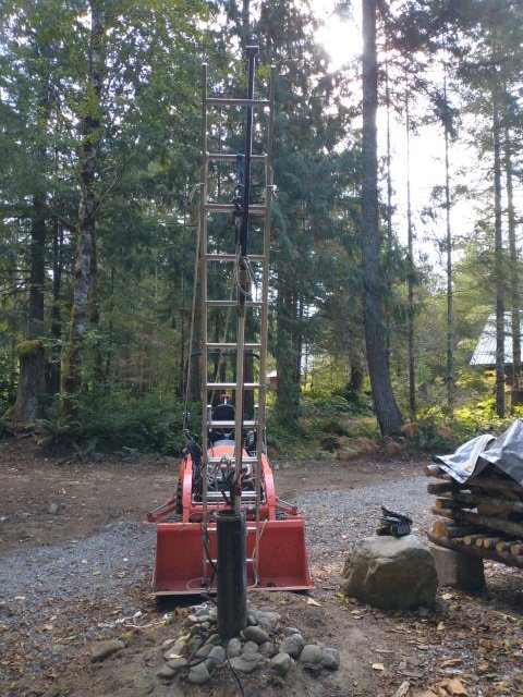

I need to pull the pump from my 135' well. The downtube is 20' sticks of schedule 80 PVC threaded together, so I can't just yard it out like I could with polyethylene. So built a crane using a ladder and tractor. Weight is minimal, but stability is important ... nice to have the backhoe because I can use the outriggers to level the tractor. I did a test run yesterday and everything went really well. I have a couple of improvements to make to the setup and the process, but overall I call it a success. Maintaining control and a vertical haul-up are important, as I don't want to break the pipe and watch it disappear down into the well. I used a pipe hitch for the haul-up and a Klemheist knot for the progress capture and safety.

Nicely done!!!!! (y)

That's awesome, good to know for whenever I get to pull mine

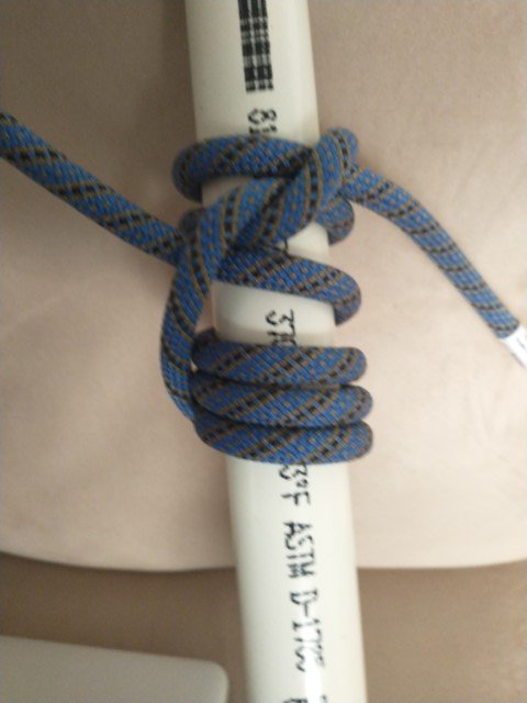

Excellent! I thought somebody might find this useful. The thing I'm most proud of is the use of the two friction hitches (the pipe knot and the Klemheist). I picked the pipe knot for the hosting because I was able to tie that knot on using the end of the haul rope. The Klemheist was actually tied with a loop of rope, which I then tied to a bowline on the progress capture/safety. Next time I'll use caribiners.
The friction hitches slide down the PVC pipe really nicely when they're not under load, but it was a pain to get them over the threaded connections.

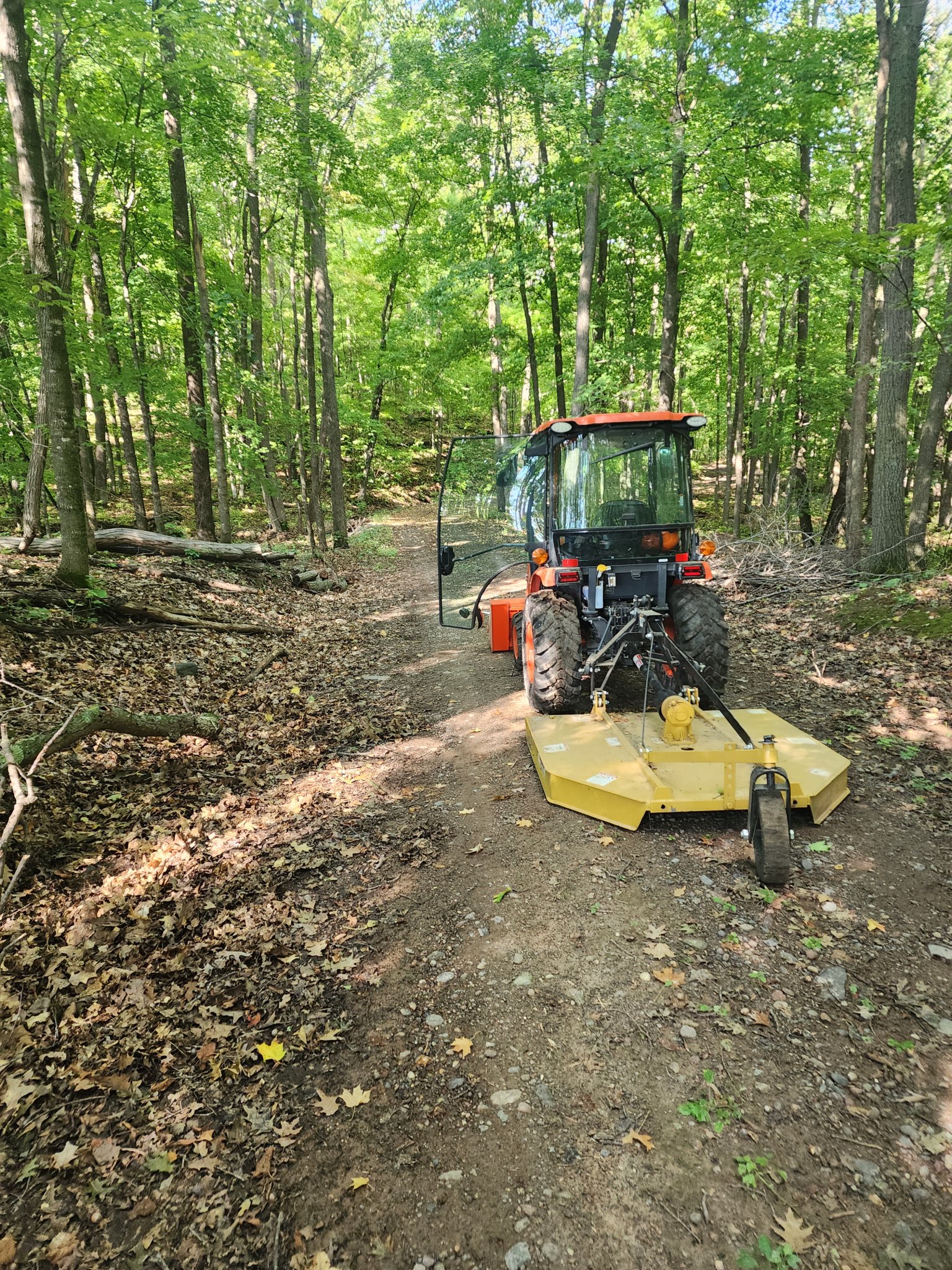

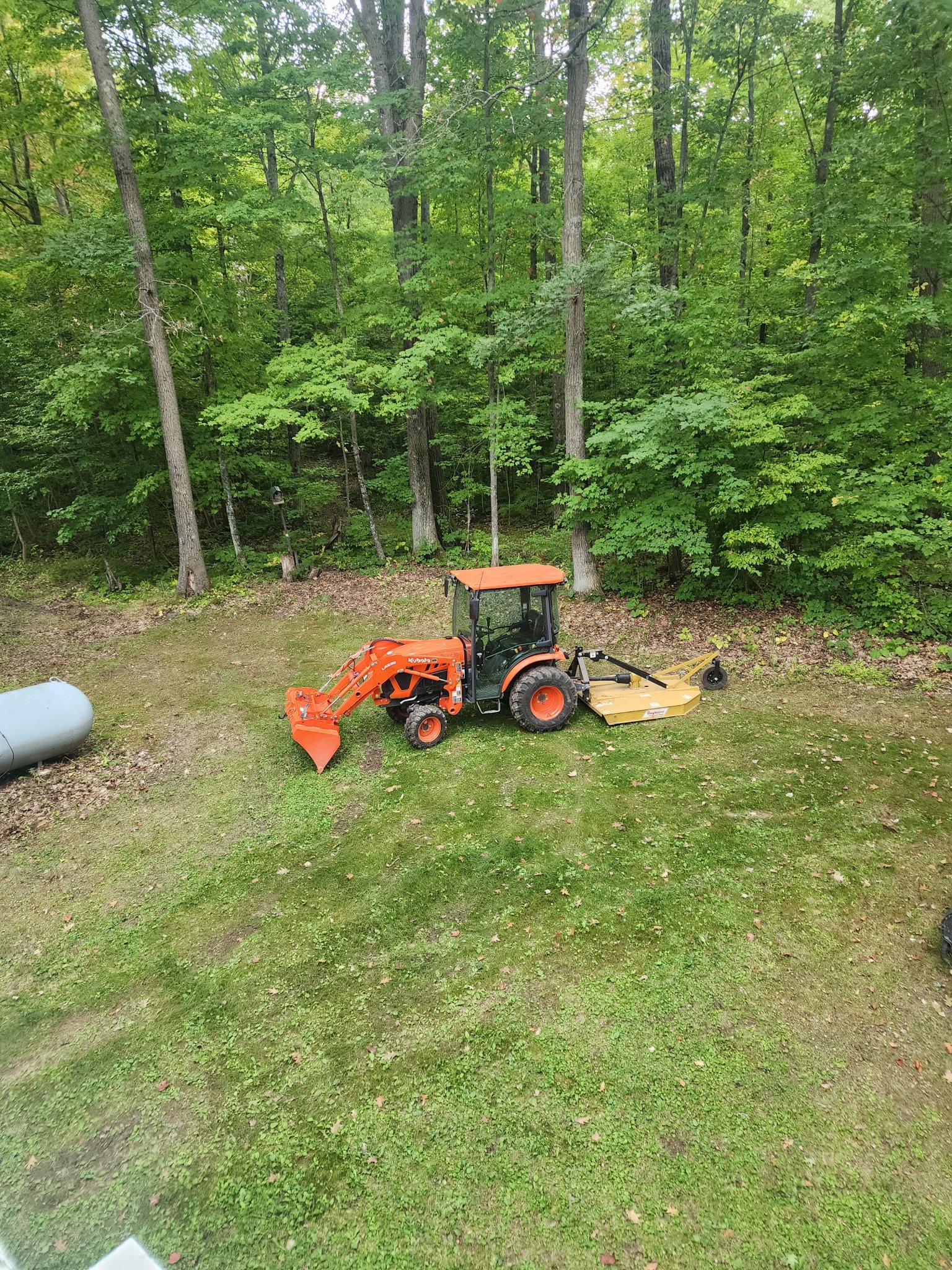

Cleared out some of the trails and the driveway today with my LX2610, aka "Gordy". My rotary cutter, and my Stihl chainsaw and FS131 trimmer.
My dad "Gordon" got me into tractoring, and Kubota, when I was 14 y/o. His impact in my life
is why I'm here, with my LX2610.

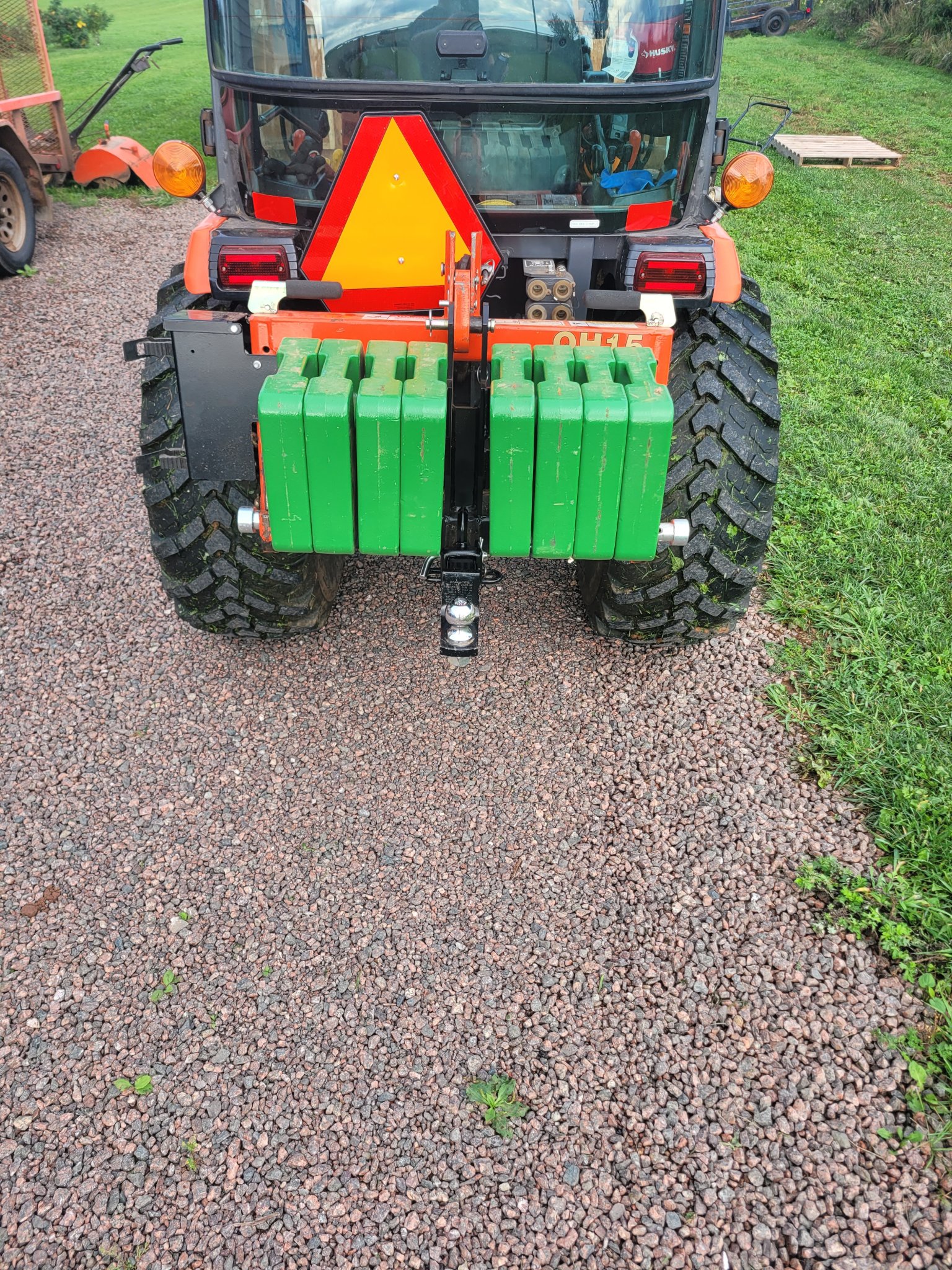

Used the forks to move some implements around and to get our outdoor furniture and summer items into the the shed. We're going to get hit with high wind and rain from hurricane Lee Friday and Saturday so I didn't want to chase any of around the property.

Looks as though "LEE" is more likely to pummel Cape Breton Island than you.

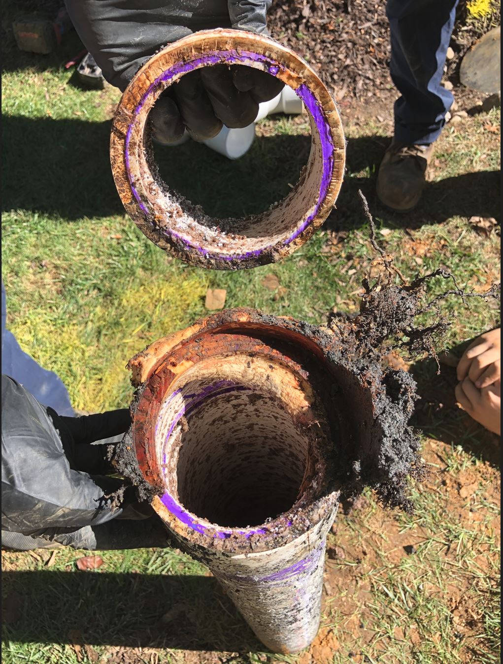

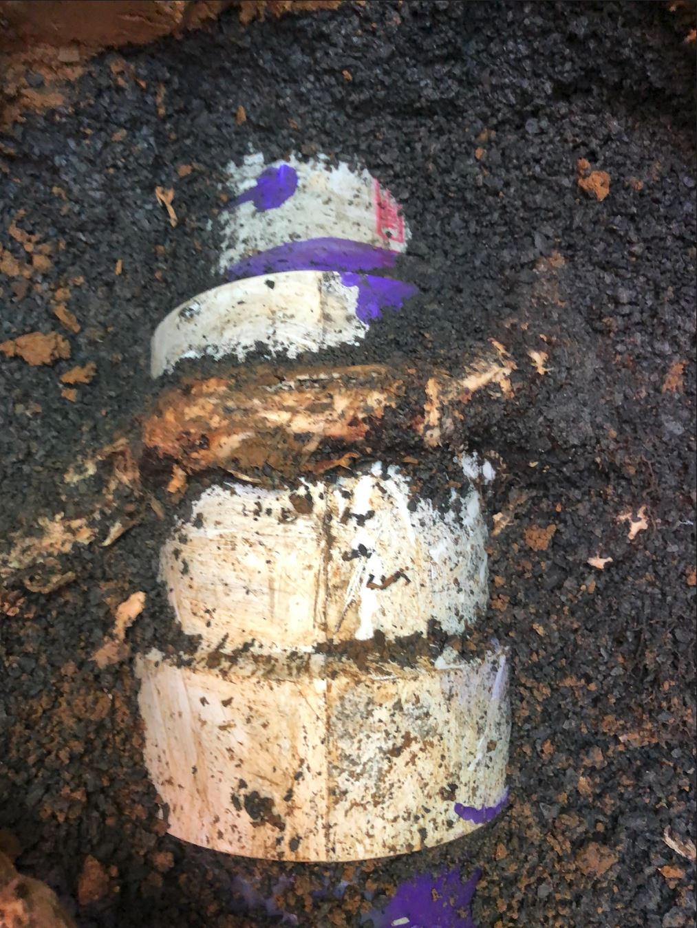

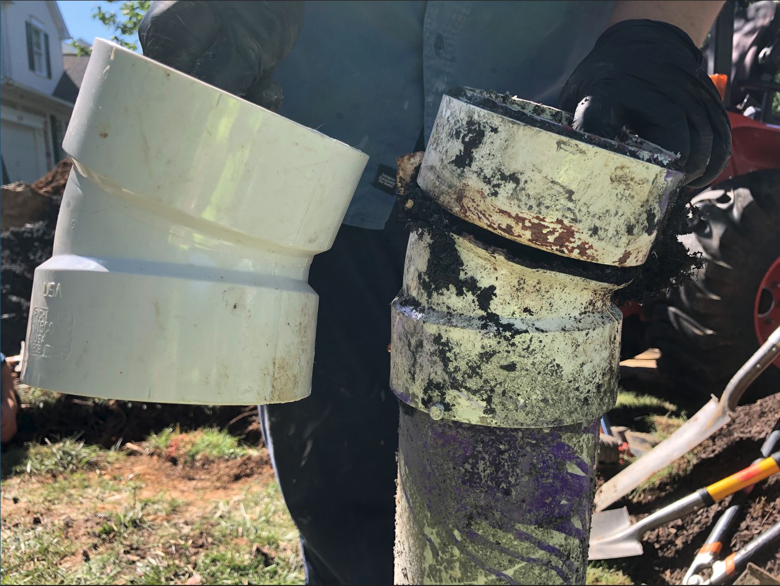

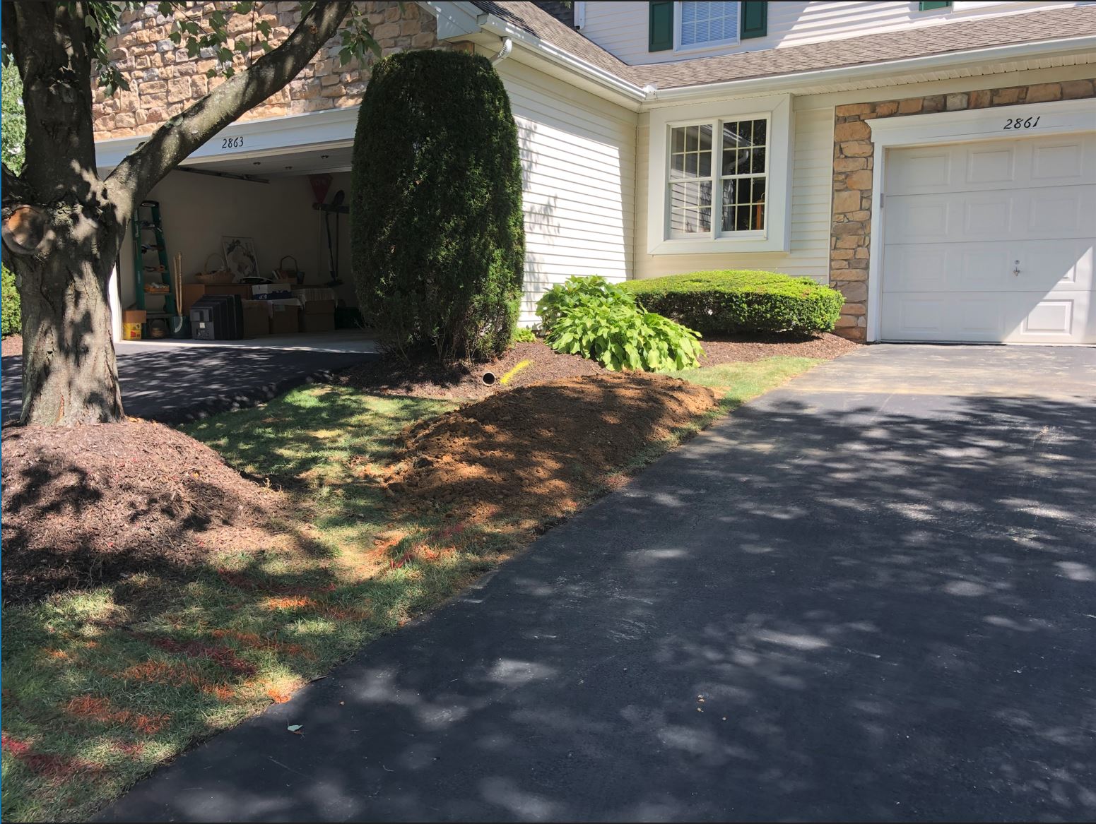

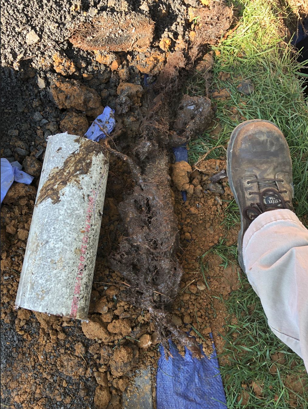

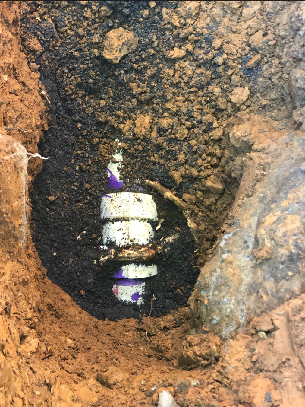

broken sewer line/root intrusion repair today with the backhoe. After seeing the location this am, I could've used the mini after all. The pics from google maps showed some very low branches that had been removed after the google maps street view photo.
This one was pretty interesting as I've never seen a root wrap around the pipe and actually break the hub.
Dig:
inspect:
issue number 1:
more dig:
ahhh, here's the problem
close up:
look how that root broke the hub (we didn't cut it)
side by side comparison using a new fitting (on left). That break was made entirely by a root that surrounded the fitting and broke it off cleanly. The root then entered the pipe and went on its merry way to feed the tree (depth was about 5 to 6 feet below surface).
done. home by 2 pm. Repair was made just before the "christmas tree" of utilities. Electric, coms and gas all right there. We've done many of these types of repairs in this "condo" development. It seems like the original installers used primer, but no glue.

When someone invents a tool to clear out around the sch 40.... with a BH... he'll be a millionaire.

Glue....with NO primer, would have had a much better chance of lasting success.
